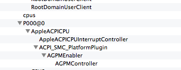

I've been testing various platforms and it seems that using a MacMini achieves and maintains lower states better than when using MacPro for example. The Turbo performance is not affected much going from MacPro to Macmini, hundred points or so in multi-core GB3, but I noticed a slightly better performance in single-core for the Macmini.
Have not tried iMac yet, but somehow I never had a great success with it...
You might call it finished for X86Platform* side but I'd like to have a version for ACPI_SMC* legacy as well.
I could be very well wrong, but it seems SB behaves better under ACPI_SMC than X86Platform*, yet when using ACPI_SMC other methods get invoked in AICPM that cause it to crash. The crashing can be avoided but then certain parameters don't get set either, and so it's an uphill battle to find a way around it.
I'm also thinking to change my MSRpatcher module to simply force a MSR 0xE2 value of 0x1E000403 for everyone who has no Cx RESIDENCY set (or everyone in general), which could possibly fix that issue.
I'll put out a new version soon for testing...
