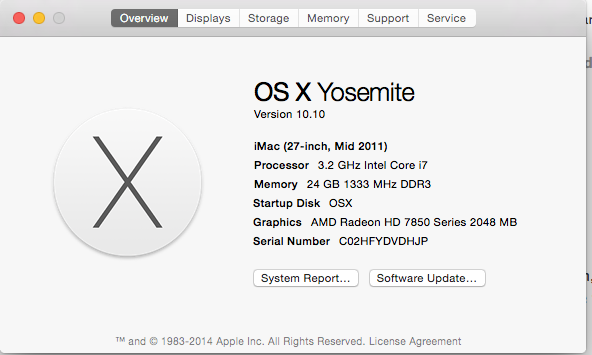

waqy Posted October 19, 2014 Share Posted October 19, 2014 Awesome stuff: Installed Yosemite yesterday, seems like this card is fully supported now without any need to mess about with framebuffers etc. Main monitor is plugged into MDP port with DVI-to-MDP adapter. Second monitor is plugged into DVI port. Both work fine Link to comment https://www.insanelymac.com/forum/topic/295190-sapphire-hd-7850-full-works/page/3/#findComment-2071879 Share on other sites More sharing options...
waqy Posted October 25, 2014 Share Posted October 25, 2014 Ok i decided to be a hero and wipe my mac drive clean and install Yosemite from blank. My setup is a Core i7 system with 2 monitors: One plugged in via MDP(using a DVI to MDP adaptor) and the second one is plugged in via DVI. Everything is working fine (graphics, sound, sleep, ethernet) but my second monitor(DVI port) doesn't work until the Mac goes to sleep and wakes up again. Is there a solution for this or should I just make do with putting it to sleep? I am using framebuffer Aji Link to comment https://www.insanelymac.com/forum/topic/295190-sapphire-hd-7850-full-works/page/3/#findComment-2075864 Share on other sites More sharing options...
