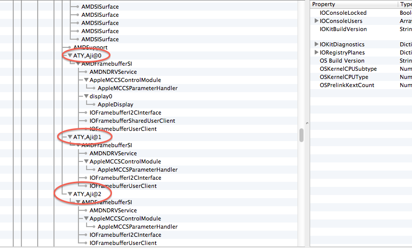

XITE666 Posted January 9, 2014 Share Posted January 9, 2014 Device (PEX) { Name (_ADR, 0x00010000) Device (GFX) { Name (_ADR, Zero) Method (_DSM, 4, NotSerialized) { Store (Package () { "@0,name", Buffer () { "ATY,Aji" }, "@1,name", Buffer () { "ATY,Aji" }, "@2,name", Buffer () { "ATY,Aji" }, "model", Buffer () { "AMD Radeon HD 7850" }, "hda-gfx", Buffer () { "onboard-1" } }, Local0) DTGP (Arg0, Arg1, Arg2, Arg3, RefOf (Local0)) Return (Local0) } } Device (HDAU) { Name (_ADR, One) Method (_DSM, 4, NotSerialized) { Store (Package () { "hda-gfx", Buffer () { "onboard-1" } }, Local0) DTGP (Arg0, Arg1, Arg2, Arg3, RefOf (Local0)) Return (Local0) } } } Finally it started to work my video card. Aty Aji 04 00 00 00 14 03 00 00 00 01 01 01 10 00 06 06 00 08 00 00 04 03 00 00 00 01 02 01 22 05 04 03 00 04 00 00 04 02 00 00 00 01 03 00 12 04 05 01 00 04 00 00 04 02 00 00 00 01 04 00 11 02 01 05 Kext for 10.11.4 added. / SIP disabled / AMD7000Controller.kext.zip Link to comment https://www.insanelymac.com/forum/topic/295190-sapphire-hd-7850-full-works/ Share on other sites More sharing options...
XITE666 Posted January 10, 2014 Author Share Posted January 10, 2014 C40304 PITCAIRN PRO A1 GDDR5 32MX32 1GB Subsystem Vendor ID: 174b Subsystem ID: e221 Object Header Structure Size: 355 Connector Object Table Offset: 48 Router Object Table Offset: 0 Encoder Object Table Offset: fd Display Path Table Offset: 12 Connector Object Id [19] which is [DISPLAY_PORT] encoder obj id [0x21] which is [INTERNAL_UNIPHY2 (osx txmit 0x12 [duallink 0x2] enc 0x4)] linkb: false Connector Object Id [12] which is [HDMI_TYPE_A] encoder obj id [0x21] which is [INTERNAL_UNIPHY2 (osx txmit 0x22 [duallink 0x2] enc 0x5)] linkb: true Connector Object Id [4] which is [DVI_D] encoder obj id [0x20] which is [INTERNAL_UNIPHY1 (osx txmit 0x11 [duallink 0x1] enc 0x2)] linkb: false Connector Object Id [2] which is [DVI_I] encoder obj id [0x1e] which is [INTERNAL_UNIPHY (osx txmit 0x10 [duallink 0x0] enc 0x0)] linkb: false Connector Object Id [2] which is [DVI_I] encoder obj id [0x15] which is [INTERNAL_KLDSCP_DAC1 (osx txmit 0x00 enc 0x10?)] linkb: false PCI ID: 1002:6819 Connector at index 0 Type [@offset 45370]: DisplayPort (10) Encoder [@offset 45374]: INTERNAL_UNIPHY2 (0x21) i2cid [@offset 45480]: 0x90, OSX senseid: 0x1 Connector at index 1 Type [@offset 45380]: HDMI-A (11) Encoder [@offset 45384]: INTERNAL_UNIPHY2 (0x21) i2cid [@offset 45507]: 0x92, OSX senseid: 0x3 Connector at index 2 Type [@offset 45390]: DVI-D (3) Encoder [@offset 45394]: INTERNAL_UNIPHY1 (0x20) i2cid [@offset 45534]: 0x94, OSX senseid: 0x5 Connector at index 3 Type [@offset 45400]: DVI-I (2) Encoder [@offset 45404]: INTERNAL_UNIPHY (0x1e) i2cid [@offset 45571]: 0x95, OSX senseid: 0x6 Connector at index 4 Type [@offset 45410]: DVI-I (2) Encoder [@offset 45414]: INTERNAL_KLDSCP_DAC1 (0x15) i2cid [@offset 45571]: 0x95, OSX senseid: 0x6 Aji replaced connectors on your own. Personality: Aji ConnectorInfo count in decimal: 4 Disk offset in decimal 662624 0000000 00 04 00 00 04 03 00 00 00 01 01 01 12 04 05 01 0000010 00 04 00 00 04 03 00 00 00 01 02 01 22 05 04 02 0000020 04 00 00 00 14 02 00 00 00 01 03 00 00 00 03 06 0000030 00 08 00 00 04 02 00 00 00 01 04 00 11 02 01 04 0000040 ------------>>> 04 00 00 00 14 02 00 00 00 01 01 01 10 00 06 06 00 08 00 00 04 02 00 00 00 01 02 01 22 05 04 03 00 04 00 00 04 03 00 00 00 01 03 00 12 04 03 01 00 04 00 00 04 03 00 00 00 01 04 00 11 02 01 05 Full works my video card . DP, DVI-I , DVI-D , HDMI Works ! Link to comment https://www.insanelymac.com/forum/topic/295190-sapphire-hd-7850-full-works/#findComment-1983701 Share on other sites More sharing options...

XITE666 Posted February 19, 2014 Author Share Posted February 19, 2014 I have MSI Radeon HD 7850 2GB Will this kext still work? Just install the kext and good? You only need to register the section in DSDT. ' Device (PEX) { Name (_ADR, 0x00010000) Device (GFX) { Name (_ADR, Zero) Method (_DSM, 4, NotSerialized) { Store (Package () { "device-id", Buffer () { 0x18, 0x68, 0x00, 0x00 }, "hda-gfx", Buffer () { "onboard-1" } }, Local0) DTGP (Arg0, Arg1, Arg2, Arg3, RefOf (Local0)) Return (Local0) } } Device (HDAU) { Name (_ADR, One) Method (_DSM, 4, NotSerialized) { Store (Package () { "hda-gfx", Buffer () { "onboard-1" } }, Local0) DTGP (Arg0, Arg1, Arg2, Arg3, RefOf (Local0)) Return (Local0) } } } Link to comment https://www.insanelymac.com/forum/topic/295190-sapphire-hd-7850-full-works/#findComment-1995462 Share on other sites More sharing options...

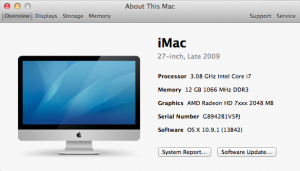

waqy Posted February 20, 2014 Share Posted February 20, 2014 Check Thanks XITE666!! I formatted drive, re-installed mavericks. I used the DSDT you fixed for me and I downloaded these kexts and installed into /S/L/E : http://www.osx86.net/files/file/3687-amd-hd7850-maverick-kexts/ Full resolution 1080P. Thanks so much! Link to comment https://www.insanelymac.com/forum/topic/295190-sapphire-hd-7850-full-works/#findComment-1995854 Share on other sites More sharing options...
waqy Posted February 20, 2014 Share Posted February 20, 2014 Has anyone with this card managed to get the framebuffer working and for it to show up at 7850, rather than 7XXX? Link to comment https://www.insanelymac.com/forum/topic/295190-sapphire-hd-7850-full-works/#findComment-1995900 Share on other sites More sharing options...
XITE666 Posted February 21, 2014 Author Share Posted February 21, 2014 Has anyone with this card managed to get the framebuffer working and for it to show up at 7850, rather than 7XXX? No framebuffer get 7xxx. Patch the 7000 controller from your BIOS ! Bios of Sapphire and other different . Link to comment https://www.insanelymac.com/forum/topic/295190-sapphire-hd-7850-full-works/#findComment-1996011 Share on other sites More sharing options...
