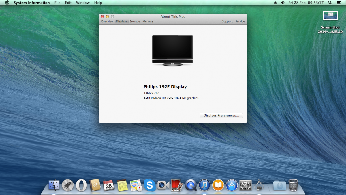

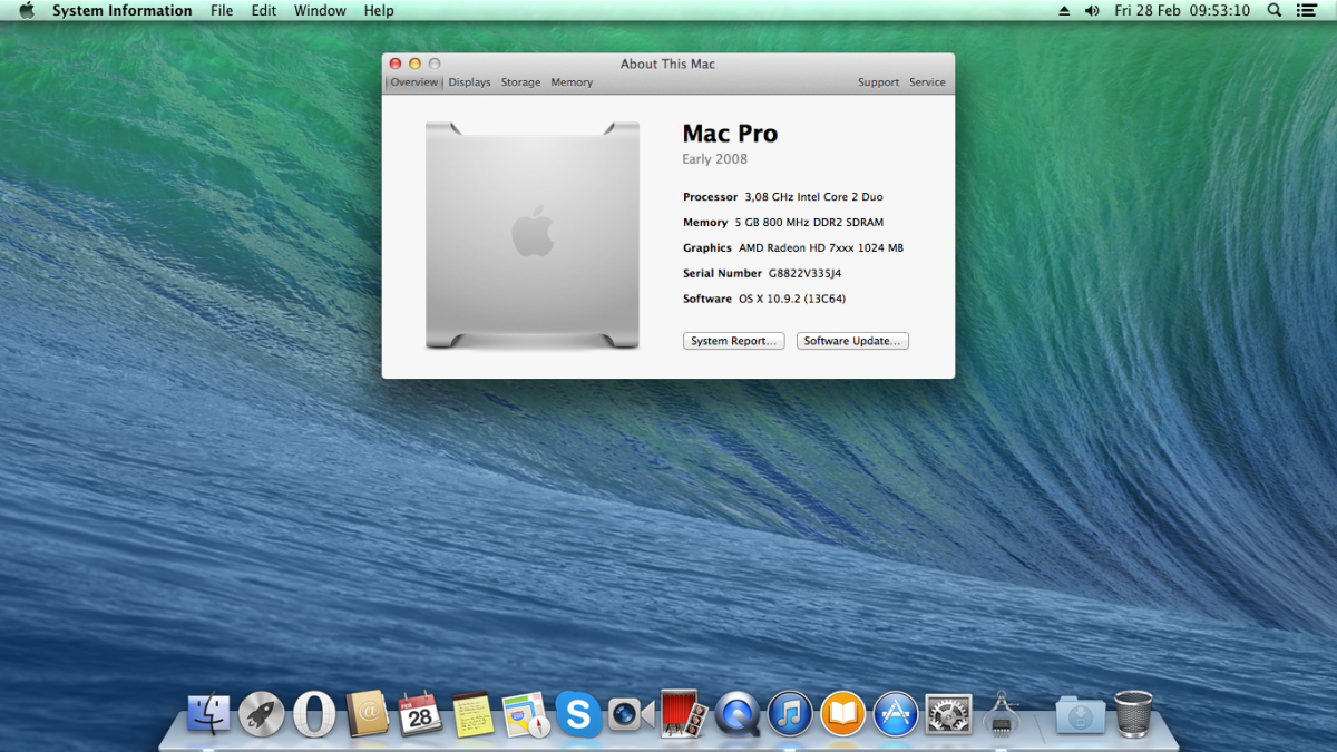

v.kouk Posted February 27, 2014 Share Posted February 27, 2014 its possible to make it work only with my gpu too? Link to comment https://www.insanelymac.com/forum/topic/295190-sapphire-hd-7850-full-works/page/2/#findComment-1998180 Share on other sites More sharing options...

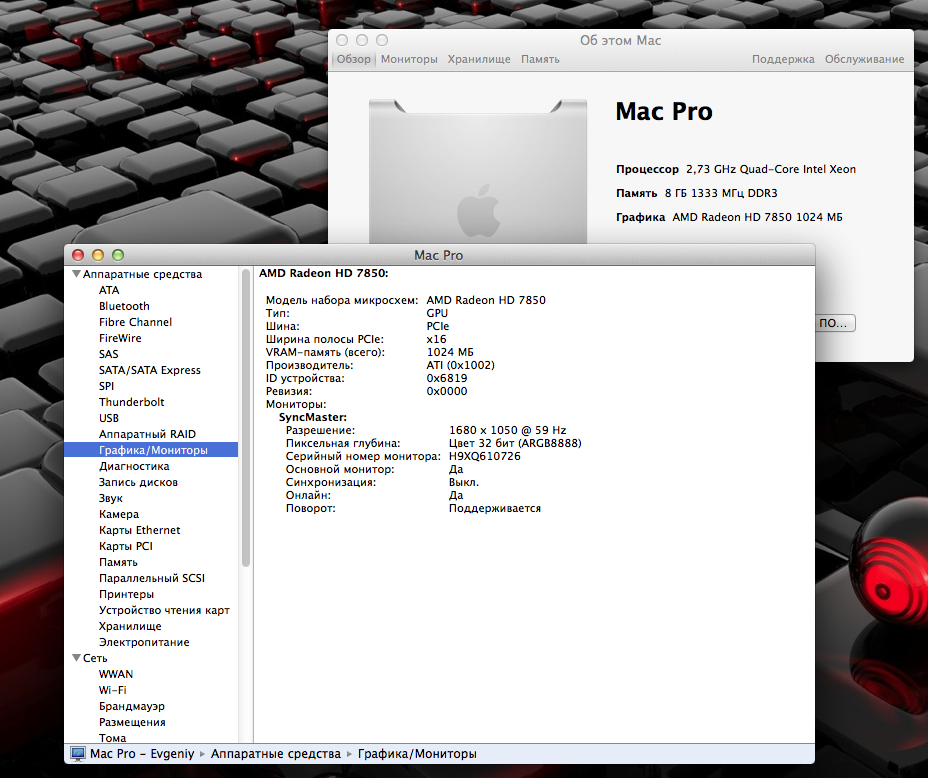

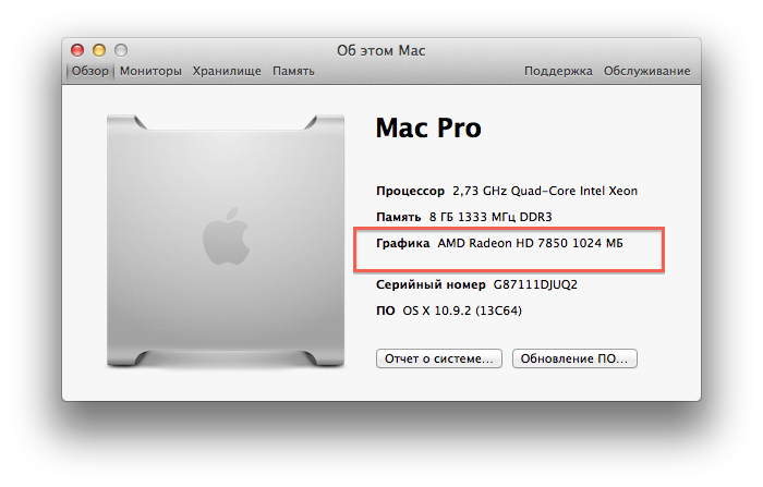

GTX9000 Posted February 27, 2014 Share Posted February 27, 2014 You do not have the frame work! Good luck. Open IORegistryExplorer.app And look We are discussing full work HD 7850!! Hello, XITE666 ! Oh, I see now! My video card is full working - Sapphire Radeon HD 7850. When you install that Update 10.9.2,will install new files and drivers. That why is a good ideea to replace files from Extensions before upateting. I play games and is working very good. Link to comment https://www.insanelymac.com/forum/topic/295190-sapphire-hd-7850-full-works/page/2/#findComment-1998227 Share on other sites More sharing options...

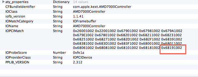

XITE666 Posted February 28, 2014 Author Share Posted February 28, 2014 its possible to make it work only with my gpu too? For 7700 to remake AMD7000Controller and maybe framebuffer . All realy . Link to comment https://www.insanelymac.com/forum/topic/295190-sapphire-hd-7850-full-works/page/2/#findComment-1998246 Share on other sites More sharing options...
waqy Posted February 28, 2014 Share Posted February 28, 2014 Hello, XITE666 ! Oh, I see now! My video card is full working - Sapphire Radeon HD 7850. When you install that Update 10.9.2,will install new files and drivers. That why is a good ideea to replace files from Extensions before upateting. I play games and is working very good. So you just re-install the two kext after updating? Anything else? Link to comment https://www.insanelymac.com/forum/topic/295190-sapphire-hd-7850-full-works/page/2/#findComment-1998287 Share on other sites More sharing options...
GTX9000 Posted February 28, 2014 Share Posted February 28, 2014 So you just re-install the two kext after updating? Anything else? Yes. Just reinstall that files. I create in this forum, a easy tutorial how to do it. Just look to my screenshots. Link to comment https://www.insanelymac.com/forum/topic/295190-sapphire-hd-7850-full-works/page/2/#findComment-1998340 Share on other sites More sharing options...
XITE666 Posted February 28, 2014 Author Share Posted February 28, 2014 So you just re-install the two kext after updating? Anything else? You can not reinstall For HD 7850 (no framebuffer) Device (PEX) { Name (_ADR, 0x00010000) Device (GFX) { Name (_ADR, Zero) Method (_DSM, 4, NotSerialized) { Store (Package () { "device-id", Buffer () { 0x18, 0x68, 0x00, 0x00 }, "hda-gfx", Buffer () { "onboard-1" } }, Local0) DTGP (Arg0, Arg1, Arg2, Arg3, RefOf (Local0)) Return (Local0) } } Device (HDAU) { Name (_ADR, One) Method (_DSM, 4, NotSerialized) { Store (Package () { "hda-gfx", Buffer () { "onboard-1" } }, Local0) DTGP (Arg0, Arg1, Arg2, Arg3, RefOf (Local0)) Return (Local0) } } } Yes. Just reinstall that files. I create in this forum, a easy tutorial how to do it. Just look to my screenshots. No full work . fully working ....... look at this Link to comment https://www.insanelymac.com/forum/topic/295190-sapphire-hd-7850-full-works/page/2/#findComment-1998341 Share on other sites More sharing options...
GTX9000 Posted February 28, 2014 Share Posted February 28, 2014 You can not reinstall For HD 7850 (no framebuffer) Device (PEX) { Name (_ADR, 0x00010000) Device (GFX) { Name (_ADR, Zero) Method (_DSM, 4, NotSerialized) { Store (Package () { "device-id", Buffer () { 0x18, 0x68, 0x00, 0x00 }, "hda-gfx", Buffer () { "onboard-1" } }, Local0) DTGP (Arg0, Arg1, Arg2, Arg3, RefOf (Local0)) Return (Local0) } } Device (HDAU) { Name (_ADR, One) Method (_DSM, 4, NotSerialized) { Store (Package () { "hda-gfx", Buffer () { "onboard-1" } }, Local0) DTGP (Arg0, Arg1, Arg2, Arg3, RefOf (Local0)) Return (Local0) } } } No full work . fully working ....... look at this I will post here a videoclip to show you it's working my video card in full. I'm back. This is the videoclip what talk about it: http://youtu.be/YRiOUz26GvU Link to comment https://www.insanelymac.com/forum/topic/295190-sapphire-hd-7850-full-works/page/2/#findComment-1998382 Share on other sites More sharing options...
