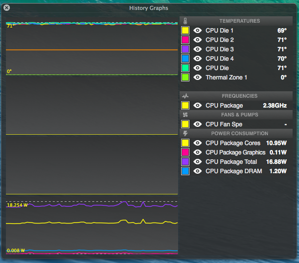

EDIT 2:
I have attached my HWMonitor History Graphs Results.. My CPUs temp is playing around 69~71.. Is this bad?..
EDIT 3:

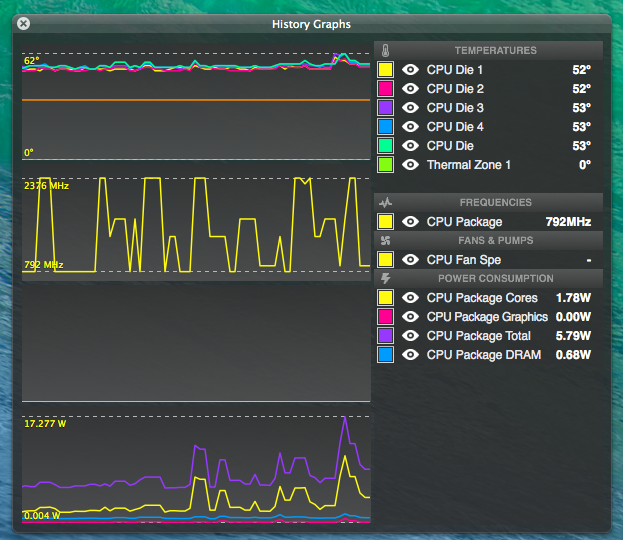

This is interesting... I have used a patched AICPM (http://www.insanelymac.com/forum/topic/293598-mavericks-and-i5-4670k-haswell-z87-installation-problem/?p=1964554) and booted with GenerateCStates=Yes GeneratePStates=Yes
My CPU temps dropped 10 degrees! from 69~71 to 55~58!.. Wait.. That's even 13 degrees! That's good... right? XD
See attached 2

EDIT 2:
See attached 2

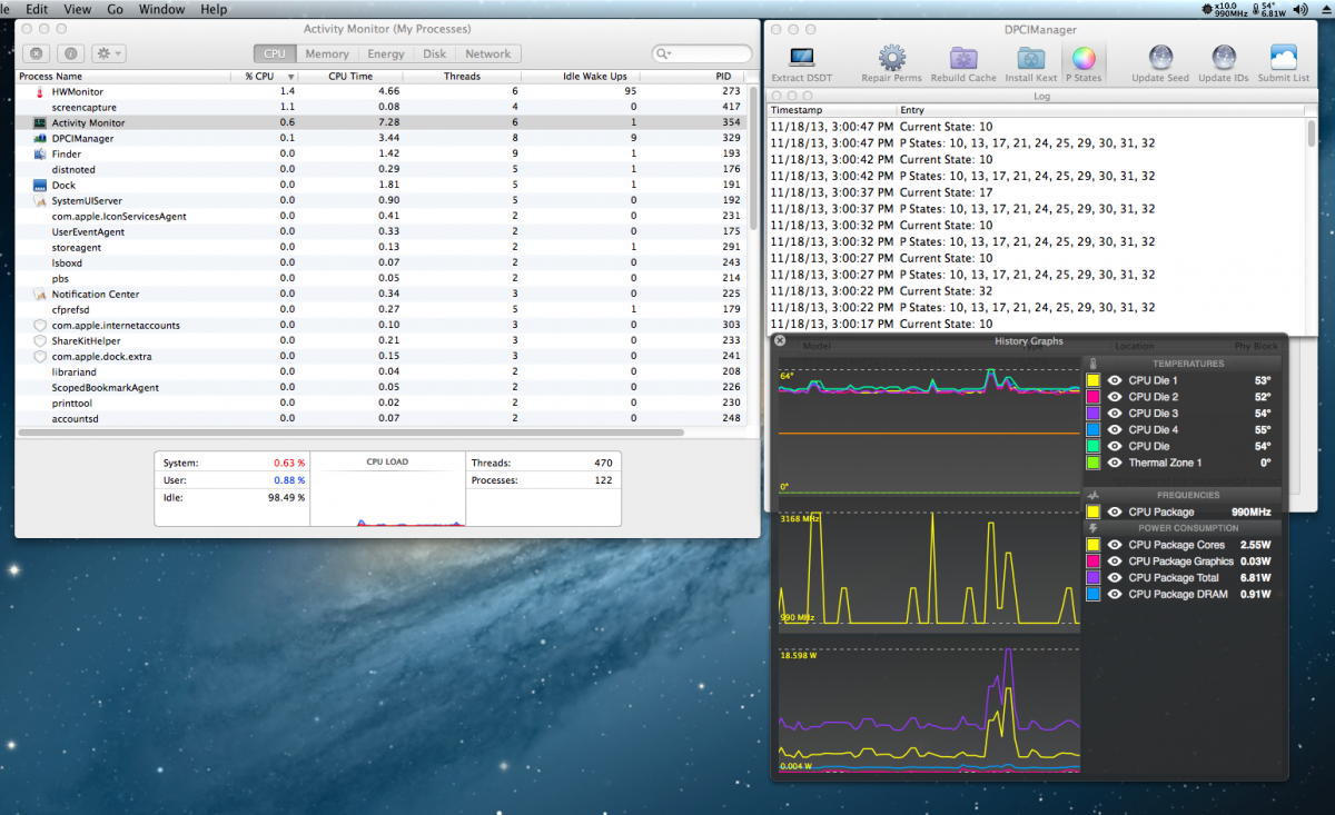

How could I know if power management is completely implemented? I've followed this post for power management, I used the attached kext on the post, http://www.insanelymac.com/forum/topic/293622-laptop-lenovo-ideapad-y510p-109-mavericks/?p=1968974
There are a lot of tools around to generate smbios.plist. Two, for example: Chameleon Wizard and Champlist.
Note that, so far, I'm getting the best results using MacBookPro8,3 (with Sandy SSDT). Eventually, I'm going to try MacBookPro9,x (and Ivy SSDT).
There are a lot of good guides and tools for completing power management if you look around. Some on a site that I can't link here.
iMac14,2 is not available on Chameleon Wizard. I think I will be sticking MacBookPro8,3 with the ssdt I have from the PM guide I followed..
I got
P States: 24, 26, 28, 29, 30, 31, 32
from DPCIManager with the new PM setup..

Looks like you're lacking idle states (or you were just keeping your computer very busy throughout the duration of your pstate capture). Again, ioreg is a useful tool to analyse power management.
That guide isn't much of a power management guide, plus on Haswell things are bit tricky because you can't just "generate an SSDT". If you're using MacBookPro8,3, you need to be sure that you're using a Sandy Bridge "style" SSDT and not an "Ivy/Haswell style". Otherwise you'll get incomplete power management.
You also need to rename GFX0 to IGPU to get full graphics power management for onchip HD graphics.

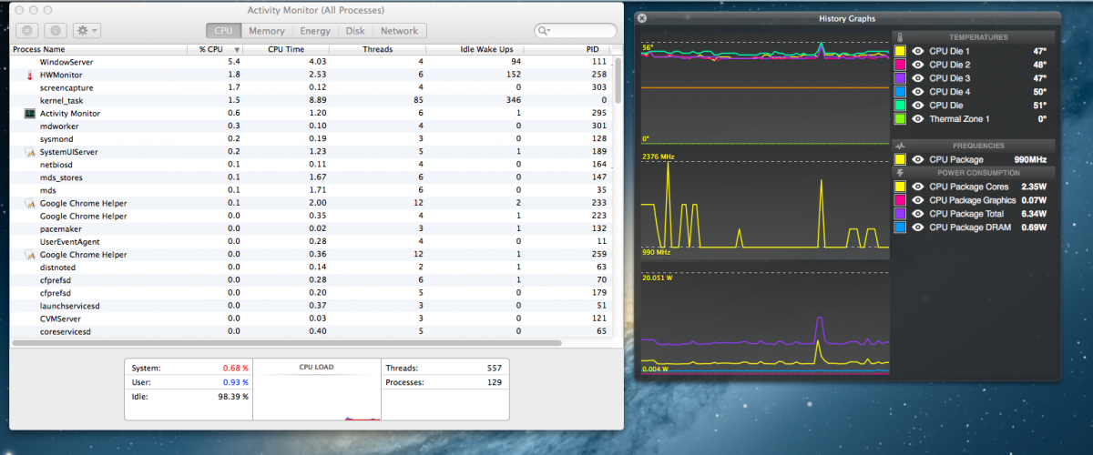

I'm using the generated ssdt, which what I believe is Sandy Bridge style ssdt. I have DropSSDT=Yes on my chameleon.
On the attached screenshot, you can see my Activity Monitor, P-States by DCPIManager and HWMonitor Graph..
I'm not sure if this working right.

DCPIManager returns
11/19/13, 8:10:02 AM, P States: 10, 13, 17, 21, 24, 25, 26, 27, 28, 29, 30, 31, 32
also, are my CPU's temperature normal? I just turned on my laptop when I took the screenshot attached..

DCPIManager returns
You should get idle at x8. Your SSDT is probably wrong for your CPU.
