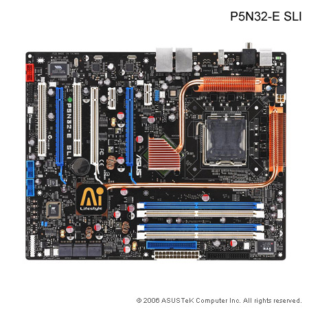

Presuming that your Dell XPS 720 MOBO has a nForce 680i chipset, then there are reports of it randomly freezing..........for example, iLeopod stopped using his 680i; see here..........
I think that the 680i suffers from temperature instabilities due to its Southbridge and Northbridge running very hot.........even on my 650i I have small fans cooling my Southbridge and Northbridge......which affect the CPU / RAM interacting during SATA data transfers, particularly large data transfers......
Also see here and here and here
Finally, see the posts starting here between myself and Nick Savage, indicating that setting maxmem=3456 greatly aids stability......also see two posts by djdubs here.....

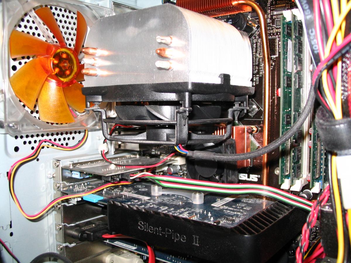

BTW re my DIY chipset cooling, my 650i Northbridge chipset has a Scythe Mini-Kase Ultra 40mm Quiet Cooling fan mounted on its finned heatsink to blow air down on it (running full speed), while the Southbridge chipset has a Rasurbo 40mm Quiet Cooling fan (with its 4 mounting screws partially screwed into the fan frame) mounted on its flat heatsink to blow air down on it (running in Q-Fan mode). These fans are mounted using "blobs" of Butyl rubber adhesive with very good holding power against gravity [but still removable] and vibration damping behaviour, with a maximum service temperature of 93 Celcius.
Glad to have helped..... :)
And I take it this has solved any possible freezing issues? You didn't say whether you experienced them yourself but i can see it's a common problem... It seems odd to me that that would only happen every few weeks, especially since it typically happens when the machine is idle. As you can see in the picture this thing seems to have some huge fans, no idea how much cfm they push/pull though.Since it sounds like a hardware issue, I take it this happens in other operating systems as well? How do I know if my northbridge and southbridge are actually getting hot? As you know HWMonitor doesn't see them, unless there is a DSDT edit I can do to have ACPISensors access the temps.
By the way, did you ever test that kext I posted to see if it improves your boot times?
My Northbridge and Southbridge fans are in addition to a 250 mm side fan blowing air into the case and the PSU fan, and a rear and from 120 mm fans drawing air out of the case (i.e. it has a moving positive internal air pressure),
in conjunction with the AppleNForceATA.imk64bit.kext allow me to run the 650i with 8 GB of DDR2 800 MHz RAM and a Q6600 OC'd to 3.0 GHz with the MOBO and CPU temps running below 40 Celcius, with the CPU PWM cooler fan running at < 900 rpm to achieve this low CPU temperature.

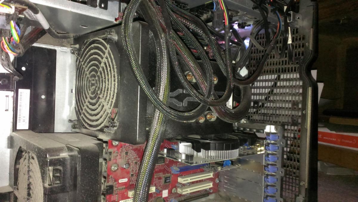

BTW the amount of dust in your fan intakes will greatly impede the fan flow over the heatsinks...... :shock:
Lol I know... I don't take care of this computer as much as I should. Probably because I got it for free :D Too many computers to clean on a regular basis lol
My CPU core temps are typically 40 degrees or less, do you think the north and south bridge could still be getting hot?
It depends on how much free air flow there is around and over the North and South bridge chipset heatsinks........needing heatsinks says a lot about how hot they get........you can get quite inexpensive handheld  IR laser spotting thermometers on ebay to check your internal case temperatures while the PC is running.....see inside my PC case:
post-200327-0-25903000-1407527697_thumb.jpg                                           post-200327-0-32475600-1407527650_thumb.jpg                                                      post-200327-0-47289800-1407527674_thumb.jpg
I'm pretty sure my dad has one of those thermometers you're talking about so I'll check that out. Perhaps it would be best for me to just get rid of the current cooling setup entirely and replace it with some more modern stuff. I may also try undervolting it a little bit with clover and see if that helps. Although we both know what undervolting can do for stability.
Just a suggestion:
1. Measure North and South bridge chipset heatsinks temps and other spot temps with IR thermometer
2. Remove dust from all key areas using compressed air
3. Re-measure North and South bridge chipset heatsinks temps and other spot temps with IR thermometer
4. If required then put a small fan on North and on South bridge chipset heatsinks
5. Re-measure North and South bridge chipset heatsinks temps and other spot temps with IR thermometer
This way you may not need to spend much money nor not risk stability further by undervolting.....you may achieve around a 10 C temp drop.......see here.....
