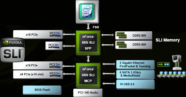

jamiethemorris Posted December 2, 2014 Share Posted December 2, 2014 Hi verdant, limiting the RAM with maxmem=3456 seems to have solved my freezing problem. But I would like to use all 6 GB of RAM. Do you think removing AppleNForceATA and using a PCIE SATA card will prevent freezes, or is this completely unrelated to the NForceATA kext? Link to comment https://www.insanelymac.com/forum/topic/293219-nforce-os-x-mavericks-109-app-store-download-install-guide-on-a-series-6-or-7-nforce-chipset-intel-cpu-mobo/page/7/#findComment-2091327 Share on other sites More sharing options...
verdant Posted December 3, 2014 Author Share Posted December 3, 2014 Hi jaimethemorris Since you have freezes, particularly during heavy data thoughput via the MOBO SATA ports, when using OS X (i.e. AppleNForceATA), unless you use maxmem=3456 on booting, I would hope for an improvement in stability by not overloading the 680i MCP, because the PCIe SATA card uses its own chipset for SATA (Asmedia ASM1061 chipset works with OS X - see post #8) has the option of going in different PCIe slots, (see attached architecture diagram) you can try each PCIe slot in turn to see which gives you the most stable / fastest throughput (despite the Asmedia ASM1061 chipset having only a PCI-E x1 lane: http://www.asmedia.com.tw/eng/e_show_products.php?item=118 ) You may not need to remove the AppleNForceATA if no OS X system HDD is connected to a MOBO SATA port. Link to comment https://www.insanelymac.com/forum/topic/293219-nforce-os-x-mavericks-109-app-store-download-install-guide-on-a-series-6-or-7-nforce-chipset-intel-cpu-mobo/page/7/#findComment-2091648 Share on other sites More sharing options...
jamiethemorris Posted December 7, 2014 Share Posted December 7, 2014 Hi jaimethemorris Since you have freezes, particularly during heavy data thoughput via the MOBO SATA ports, when using OS X (i.e. AppleNForceATA), unless you use maxmem=3456 on booting, I would hope for an improvement in stability by not overloading the 680i MCP, because the PCIe SATA card uses its own chipset for SATA (Asmedia ASM1061 chipset works with OS X - see post #8) has the option of going in different PCIe slots, (see attached architecture diagram) you can try each PCIe slot in turn to see which gives you the most stable / fastest throughput (despite the Asmedia ASM1061 chipset having only a PCI-E x1 lane: http://www.asmedia.com.tw/eng/e_show_products.php?item=118 ) 680i-sli-block.png You may not need to remove the AppleNForceATA if no OS X system HDD is connected to a MOBO SATA port. Thanks. I'm using ASM1061 in my Z68 build since I ran out of SATA ports and it works pretty well. I think I'll get another as soon as I have some money. If I'm being perfectly honest with myself though, I have no need for 6gb RAM on this computer since it's only a HTPC. Link to comment https://www.insanelymac.com/forum/topic/293219-nforce-os-x-mavericks-109-app-store-download-install-guide-on-a-series-6-or-7-nforce-chipset-intel-cpu-mobo/page/7/#findComment-2092972 Share on other sites More sharing options...
