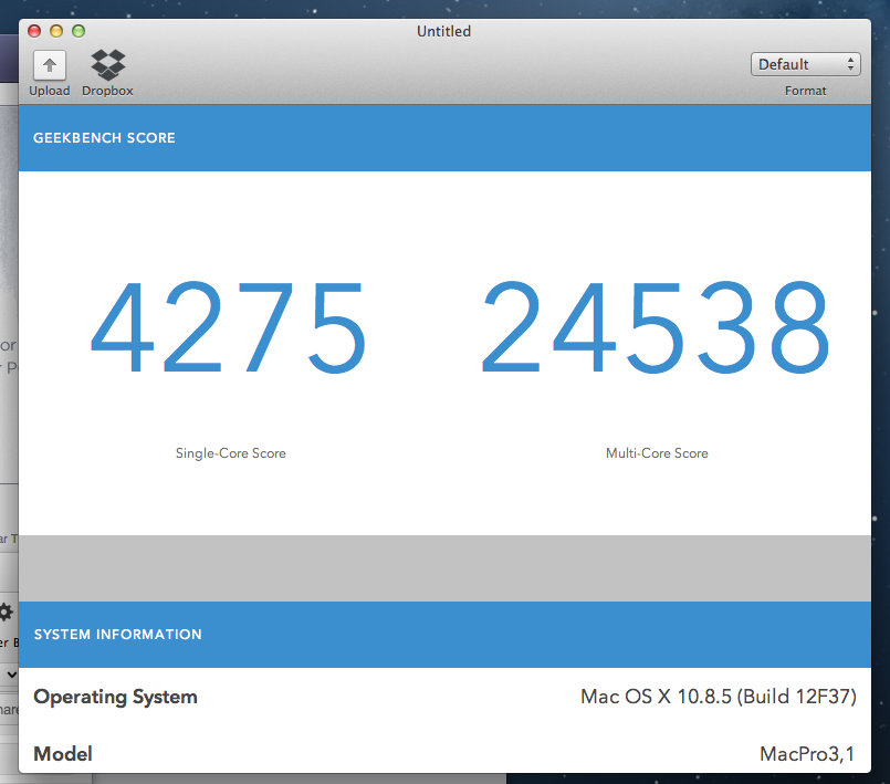

jasjeet Posted September 16, 2013 Share Posted September 16, 2013 Rampagedev will know better, currently im using NullPowerManagement but with a corrected DSDT and sleepenabler.kext i can get sleep to work. I dont believe full power management works in Mountain Lion but in 10.9 it should as Apple are using the socket 2011 CPUs. My CPU is overclocked to 4.6Ghz but i think its performing at its stock 3.6Ghz as Geekbench score is 18000, whereas on my 3960x at 4.6Ghz in 10.8 i hit 22000. FakeSMC doesnt support the Ivy-E CPUs yet so my iStat and HWmonitor are not working to check the speeds of the CPU and Multipliers/Voltages. Im assuming that with that Geekbench score its running at stock, no idea if its speedstepping or Turbo'ing at the moment. Link to comment https://www.insanelymac.com/forum/topic/291831-asus-sabertooth-x79-ivy-bridge-e-4930k/page/2/#findComment-1946216 Share on other sites More sharing options...

jasjeet Posted September 26, 2013 Share Posted September 26, 2013 Ive managed to get a Geekbench score of 20k with 3.6Ghz, it isnt overclocking even with C States and Speedstep disabled. MSRDumper and HWMonitor both report x36 Multi. One more issue, the vanilla AppleIntelCPUPowerManagement.kext will not allow the Kernel Cache to build. Using the 10.8.5 patch in Mult1beast does allow the Kernel cache to Build, but results in a Kernel Panic (Unrecognized CPU) on reboot. Without AppleIntelCPUPowermanagement.kext installed (and without NullCPUPowerManagement) the C States seem to work and sleep works too. But still cant get it to Turbo to my overclock. Not sure if AppleIntelCPUPowermanagement Kext is related to the overclock. Im going to try Mavericks soon. Tried Mavericks, it wont boot the installer, same black screen issue (Kernel issue again), so i tried the patched 10.8.4 kernel that worked previously, but that didnt work for obvious reasons (gave it a shot anyway). Link to comment https://www.insanelymac.com/forum/topic/291831-asus-sabertooth-x79-ivy-bridge-e-4930k/page/2/#findComment-1948811 Share on other sites More sharing options...
