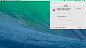

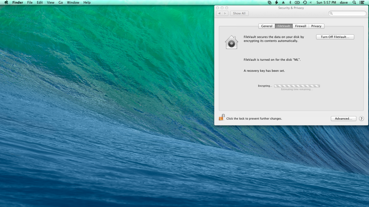

CaptSilver Posted August 18, 2013 Share Posted August 18, 2013 So, I installed mavericks using Clover with UEFI from the actual setup app. I do NOT make a USB bootable version, clover booted straight into the app and it installed. I noticed from the Logs that it also made a Recovery HD partition automatically. I upgraded to DP 2 as the ATI drivers were broken. I then turned on FileVault and restarted my computer. It appears that it is currently encrypting my laptop. i will let you guys know if this works in a day or so as it has a lot to encrypt. Cheers CaptSilver 1 Link to comment https://www.insanelymac.com/forum/topic/291304-mv-dp2-clover-filevault-2-amazing/ Share on other sites More sharing options...

CaptSilver Posted August 20, 2013 Author Share Posted August 20, 2013 I have two internal hard drives so it made it easy. I started with a USB flash for clover then installed clover to the other hard drive. Then booted the first hard drive using UEFI Clover and told it to install Mavericks which registered the DMG with the booted EFI (Clover from the other hard drive) and then rebooted into the DMG using injected Kexts (Fake SMC) and installed just like vanilla. The encryption does not work as Clover still does not support the password from EFI boot. So, blah... one failure. But everything else is working. I simply booted into my other hard drive and reverted from core storage using diskutil to undo my encryption. Cheers, CaptSilver Interesting way....well i just found out about clover, first have get it booting...oh wow this is a lot of info!A lot of possibilities!Also... i don't think i will have time for it to study, maybe I stick to Chameleon, which looks a bit more for dummies like me Only making a config file for my system looks already difficult... I think i will give it a try because nothing looks to work right now, i can't even sea picture (Black-Green theme)Now i have to find out what i have to use in my config file.I need something for the XMP to get my memory on 1600mhzAlso need somecode for my Haswell processor i7-4770Do i need more? I have gforce GTX650Don't use onboard audio an lan, i have an pci intel pro 1000mtAnyone have an idea for the config file? Just boot clover from a USB and try it out. It auto detects a lot of stuff. It sometimes glitches on the graphics and you have to set the theme from the UI before it straightens up! Happy Hacking!!! Cheers, CaptSilver Link to comment https://www.insanelymac.com/forum/topic/291304-mv-dp2-clover-filevault-2-amazing/#findComment-1940001 Share on other sites More sharing options...
