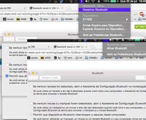

antonioj Posted October 6, 2015 Share Posted October 6, 2015 Hello, just want to say Edwin_3930K bluetooth fix made my bluetooth dongle work again with magic mouse in El Capitan Only problem is that i can´t turn off bt Link to comment https://www.insanelymac.com/forum/topic/289871-bluetooth-stuck-in-on-state-and-not-working/page/5/#findComment-2174039 Share on other sites More sharing options...

wackowizzard Posted October 28, 2016 Share Posted October 28, 2016 I did this, so now I don't have the 'Bluetooth' panel anymore!!! Please help ? Link to comment https://www.insanelymac.com/forum/topic/289871-bluetooth-stuck-in-on-state-and-not-working/page/5/#findComment-2308030 Share on other sites More sharing options...
