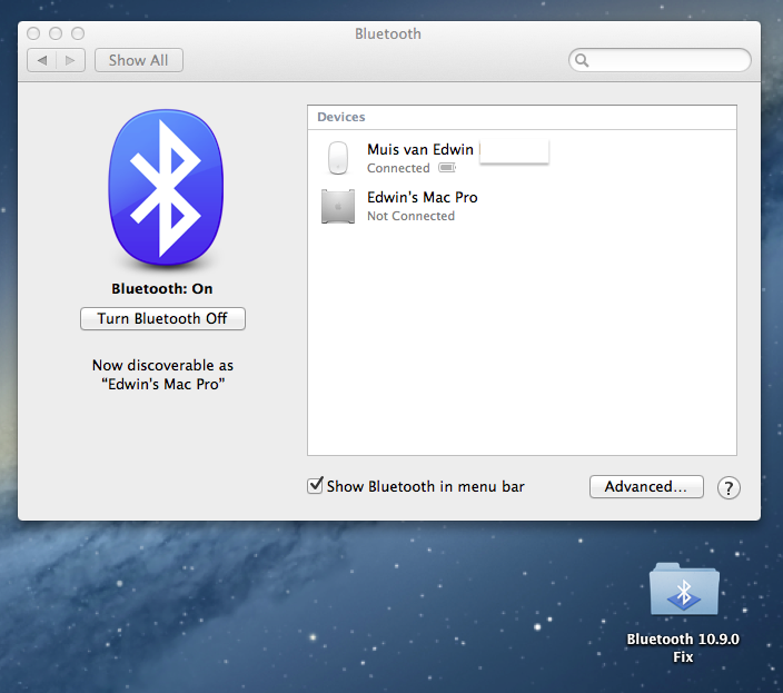

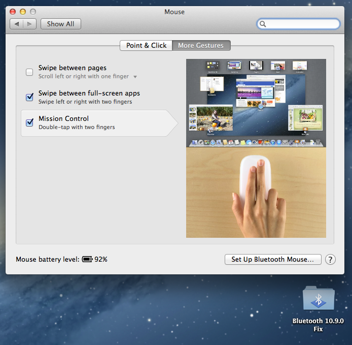

Edwin_3930K Posted November 9, 2013 Share Posted November 9, 2013 My problems are fixed! I'v made a file for you guys which should fix your bluetooth problems in mavericks. This fix should repair connection/discover/pair problems with bluetooth in Mavericks. Also helped me fix a problem were my magic mouse was recognised as normal mouse. (no multitouch/gestures enabled.) Drop all the files (simultaneously) into the Kext Utility. Wait until process is done (fill in password when ask). Reboot. Bluetooth should now work properly. —— Note: Do not turn off bluetooth. —— Bluetooth 10.9.0 Fix.zip Let me know if it worked *Try at own risk* 3 Link to comment https://www.insanelymac.com/forum/topic/289871-bluetooth-stuck-in-on-state-and-not-working/page/4/#findComment-1965886 Share on other sites More sharing options...
nattplus Posted November 10, 2013 Share Posted November 10, 2013 Thanks Edwin_3930K. It works..! I now can use my Trackpad with Mavericks. Link to comment https://www.insanelymac.com/forum/topic/289871-bluetooth-stuck-in-on-state-and-not-working/page/4/#findComment-1966074 Share on other sites More sharing options...
boy_iran_64 Posted November 10, 2013 Share Posted November 10, 2013 Thanks Edwin_3930K.... But not works for me Link to comment https://www.insanelymac.com/forum/topic/289871-bluetooth-stuck-in-on-state-and-not-working/page/4/#findComment-1966113 Share on other sites More sharing options...
Edwin_3930K Posted November 10, 2013 Share Posted November 10, 2013 Thanks Edwin_3930K. It works..! I now can use my Trackpad with Mavericks. Good to hear. Thanks Edwin_3930K.... But not works for me What is the problem? not connecting? Also make sure your mouse or whatever is on while booting. Sometimes when i turn on my magic mouse in MacOSX it won't connect. Link to comment https://www.insanelymac.com/forum/topic/289871-bluetooth-stuck-in-on-state-and-not-working/page/4/#findComment-1966126 Share on other sites More sharing options...

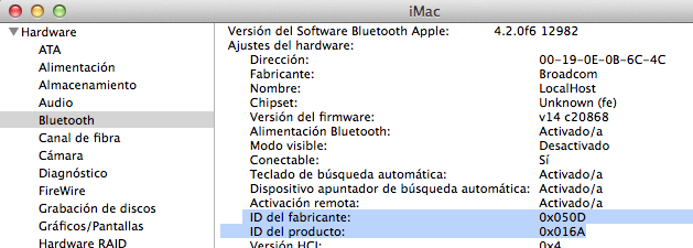

iFIRE Posted November 10, 2013 Share Posted November 10, 2013 for me don´t work sleep, this prevent my idlle sleep my USBBluethooth idProduct an idDevice is native in the kext 10.9 BroadcomBluetoothControllerUSBTransport.kext, any edit is needed <key>BroadcomUSBBluetoothHCIController - BLUETOOTH USB +EDR ADAPTER v2.1 UHE</key> <dict> <key>CFBundleIdentifier</key> <string>com.apple.iokit.BroadcomBluetoothHostControllerUSBTransport</string> <key>IOClass</key> <string>BroadcomBluetoothHostControllerUSBTransport</string> <key>IOProviderClass</key> <string>IOUSBDevice</string> <key>idProduct</key> <integer>362</integer> <key>idVendor</key> <integer>1293</integer> 1 Link to comment https://www.insanelymac.com/forum/topic/289871-bluetooth-stuck-in-on-state-and-not-working/page/4/#findComment-1966169 Share on other sites More sharing options...
