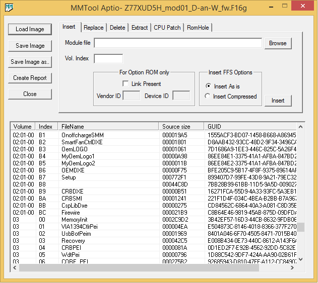

CoBrA2168 Posted November 23, 2015 Share Posted November 23, 2015 F16g is the latest beta version (on TweakTown). I use it with some mods (updated OROMs, updated VBIOS, added ASRock FireWire driver & Apple HFSPlus.efi). Mind posting this BIOS for me to try? I can't get El Capitan successfully installed using your script. I think it has something to do with the BIOS revision. Link to comment https://www.insanelymac.com/forum/topic/288829-guide-gigabyte-z77x-ud5h-clover-uefi-installtweak-guide/page/18/#findComment-2190986 Share on other sites More sharing options...

HypervisorX Posted November 25, 2015 Share Posted November 25, 2015 This is the F16 bios with the firewire driver added. It should work fine but proceed at your own risk etc. It is based on the GA-Z77X-UD5H - F16 -20.Aug 13 bios. Firewire EFI driver was added using UEFITool v0.21.4, nothing else in bios has been changed. Sandy Bridge GOP video driver was removed from bios to free up space so DO NOT use this if you have a Sandy Bridge processor. If you have an Ivy Bridge Processor then this is fine (example 3770k etc). Other than that change it is the same as the F16 Bios obtained from the tweaktown post of previous beta bios list for the Z77XUD5H. When you have a chance after testing it please let me know how it works for you I have attached the bios Edit: I had originally posted a bios file with the Sandy Bridge GOP Driver removed. However in the interest of this being useful to more people and less chance of someone making a mistake I chose to change the attachment to the F16 Bios with just the firewire driver added. So this 'Z77XUD5H-Firewire.F16.zip' will work for anyone with ivy or sandy bridge. I have tested this new version myself and it seems to works fine. Z77XUD5H-Firewire.F16.zip Link to comment https://www.insanelymac.com/forum/topic/288829-guide-gigabyte-z77x-ud5h-clover-uefi-installtweak-guide/page/18/#findComment-2191676 Share on other sites More sharing options...
ultrazonestudios Posted November 29, 2015 Share Posted November 29, 2015 This is the F16 bios with the firewire driver added. It should work fine but proceed at your own risk etc. It is based on the GA-Z77X-UD5H - F16 -20.Aug 13 bios. Firewire EFI driver was added using UEFITool v0.21.4, nothing else in bios has been changed. Sandy Bridge GOP video driver was removed from bios to free up space so DO NOT use this if you have a Sandy Bridge processor. If you have an Ivy Bridge Processor then this is fine (example 3770k etc). Other than that change it is the same as the F16 Bios obtained from the tweaktown post of previous beta bios list for the Z77XUD5H. When you have a chance after testing it please let me know how it works for you I have attached the bios Edit: I had originally posted a bios file with the Sandy Bridge GOP Driver removed. However in the interest of this being useful to more people and less chance of someone making a mistake I chose to change the attachment to the F16 Bios with just the firewire driver added. So this 'Z77XUD5H-Firewire.F16.zip' will work for anyone with ivy or sandy bridge. I have tested this new version myself and it seems to works fine. Thanks! I'll try your BIOS and post results over here... Link to comment https://www.insanelymac.com/forum/topic/288829-guide-gigabyte-z77x-ud5h-clover-uefi-installtweak-guide/page/18/#findComment-2192627 Share on other sites More sharing options...
ultrazonestudios Posted December 5, 2015 Share Posted December 5, 2015 This is the F16 bios with the firewire driver added. It should work fine but proceed at your own risk etc. It is based on the GA-Z77X-UD5H - F16 -20.Aug 13 bios. Firewire EFI driver was added using UEFITool v0.21.4, nothing else in bios has been changed. Sandy Bridge GOP video driver was removed from bios to free up space so DO NOT use this if you have a Sandy Bridge processor. If you have an Ivy Bridge Processor then this is fine (example 3770k etc). Other than that change it is the same as the F16 Bios obtained from the tweaktown post of previous beta bios list for the Z77XUD5H. When you have a chance after testing it please let me know how it works for you I have attached the bios Edit: I had originally posted a bios file with the Sandy Bridge GOP Driver removed. However in the interest of this being useful to more people and less chance of someone making a mistake I chose to change the attachment to the F16 Bios with just the firewire driver added. So this 'Z77XUD5H-Firewire.F16.zip' will work for anyone with ivy or sandy bridge. I have tested this new version myself and it seems to works fine. Hi! Your BIOS works great in my system, but it hasn't solved the problem I have related to FireWire: I'm using a PCIe StarTech FireWire card (2 800mbs ports + 1 400mbps port) and it is impossible to shutdown the computer with the card inserted, it just reboots again. Sleep doesn't work neither, it goes to sleep but immediately it wakes up. I've been trying different BIOSes to no avail, this card seems to broke shutdown and sleep. Any ideas on how to solve this? Thanks in advance! Link to comment https://www.insanelymac.com/forum/topic/288829-guide-gigabyte-z77x-ud5h-clover-uefi-installtweak-guide/page/18/#findComment-2194122 Share on other sites More sharing options...
