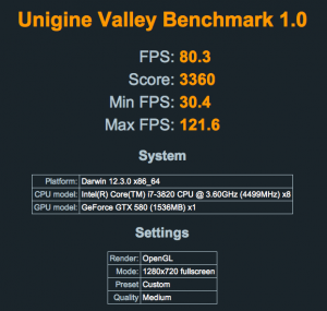

GTX 580, BASIC(no AA!) : 80,3 fps fullscreen

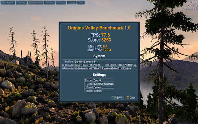

AMD Sapphire Radeon HD 7970 (no AA!) : 77,8 fps fullscreen (windowed mode gave minimal less fps)

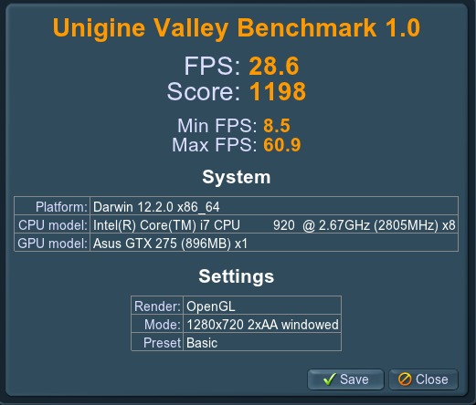

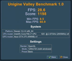

Asus GTX275, BASIC: 28,5 fps

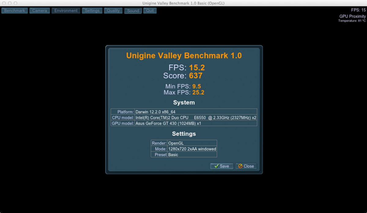

Nvidia GT 430, BASIC : 15,2 fps

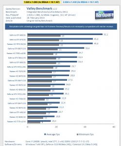

EDIT: Some GPUs testet running Windows (test german HW magazine) - preset EXTREME HD

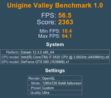

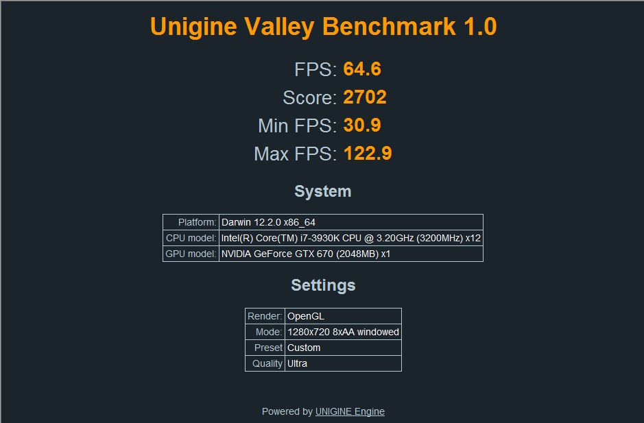

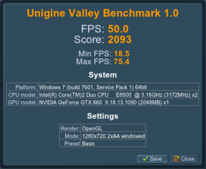

EVGA GTX 660 2GB, 304.00.05f02 driver on 10.8.2

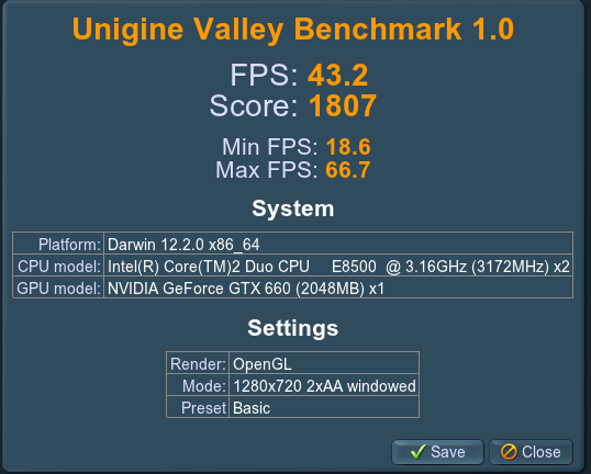

Basic Preset - 10.8.2

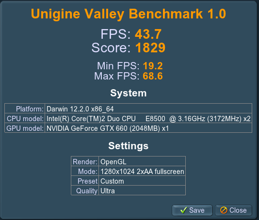

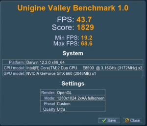

Ultra, 1280x1024 full screen, 2xAA
This doesn't make much sense, the Ultra result should be slower...?!
I'm probably CPU bottlenecked.

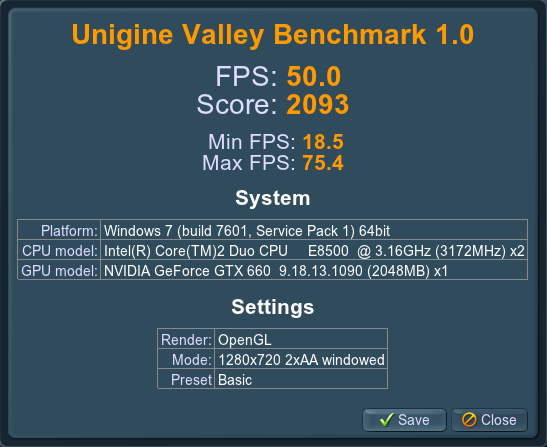

Basic Preset OpenGL - Windows 7
Max FPS seems locked to my refresh rate even though vsync is disabled.

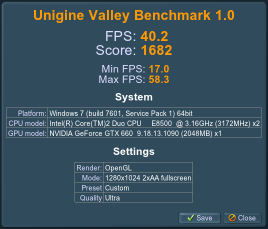

Ultra, 1280x1024 full screen, 2xAA, OpenGL - Windows 7
lol, OS X scores higher than Windows with the same settings.
GPU temps read the same on both OS - it slowly climbs to 82 degrees celsius and stays there.

I dont think your cpu is the bottleneck. If cpu load is
You tested second (Quality Ultra) in fullscreen (same res). Try windowed. Sometimes windowed vs fullscreen gives different fps even same res!
Also, you have very much VRAM. Quality setting does (normaly): Polygon count, Textures and Shaders.
If it does mostly / only changing texture res, then only VRAM usage is much more - if you have enough VRAM than no fps difference like it would use more poligones or more usage of shaders.

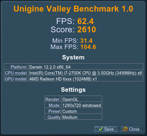

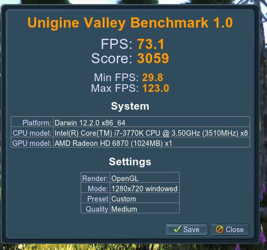

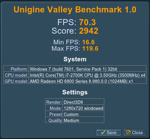

Ok, just another ATI 6870 (XFX Dual Fan), but running only on x8 PCIe 2.0 slot.Basic, with disabled AA:Cheers!

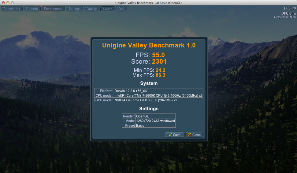

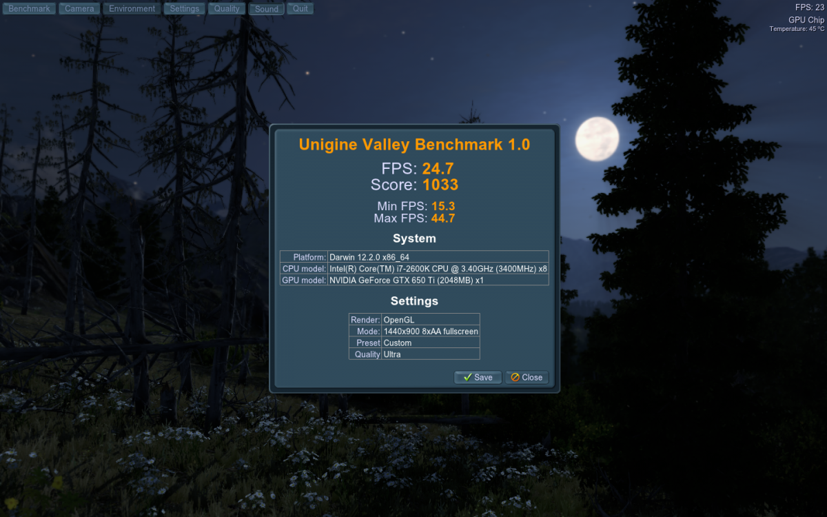

I disagree, it must be a CPU bottleneck...otherwise how could a GTX 650 Ti possibly beat my score by ~500 points?!

The other with GTX 650 TI (is slower than GTX 660 - normaly, only GTX 660 TI is faster than GTX 660) has i7 cpu 2600k - GHz unknown.

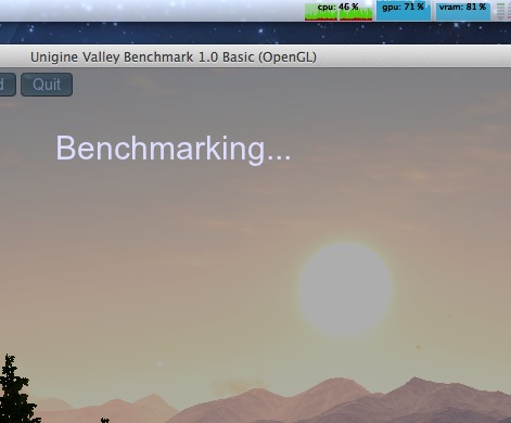

Basic with AA off. But fullscreen does give about a 100 more points than windowed. Also always at same spot where the boulders are and starting to rain it stutters for half a second dropping min FPS from 30 which is at first startup down to 8 FPS. Tried re-downloading, same thing :unsure:
Oh, second GPU not a factor here, exact same results either way, only boosts in openCL
Share this post
Link to post
Yep, fullscreen vs windowed mode can (with same other settings) make sometimes different fps speeds. Depends on GPu and drivers.
Your system, with AMD 7970 gets some really low minimal fps ( around 8 fps ) / massive framedrops compared to other AMD (6xxx) and GTX 5/6xx gpus with around 30 fps.
Max fps seems to be more equal on the fastest gpus here. Even my old 9600 GT(running on C2D cpu) with 30 max FPS (BASIC) has 9 fps MIN - so max/min = 3/1. Yours has 120/8 = 15/1. Others here mostly 3/1 .. 10/1.
Perhaps OS X driver in case of new AMD 7xxx isnt already perfect for that bench - which squeezes out every card with high load.
Share this post
Link to post
It would be min of 31.1, but the 8FPS happens at the same spot each time, it freezes for half a second right when the first lightning strike of the benchmark happens no matter what settings are used. IDK?

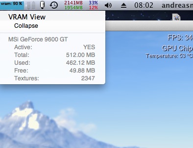

You could use atMonitor (attached, don't update because newer versions removed gpu part) to look (in realtime) after the VRAM / gpu usage beside running valley bench in windowed mode and setup atMonitor gpu % and gpu VRAM usage for menue or floating window values.
I am unsure if the AMD drivers also support VRAM usage "looking" as Nvidia. Give a try. rob from barefeats tested it with GTX 580 and there valley used about 1 GB VRAM (higer res + AA + ultra)
Looks like ( if used as menue setting) for my 512 MB card - even without AA and BASIC preset near all VRAM is used.
VRAM usage never gets over around 95% - if more VRAM needed, the driver swaps VRAMRAM for new content over the PCIe Bus. That swappings takes very much time compared to already loaded textures into VRAM.

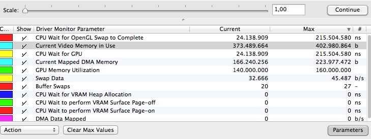

Osx broke VRAM monitoring on 5xxx series and newer cards since around 10.7.3, it can still be monitored with openGL driver monitor to get figures, problem was/is that total available VRAM became a negative number making all monitoring apps show 100% usage. With openGL driver monitor you can expand it's range to allow you to see negative and positive numbers so it is still a way to get comparitive figures even though the exact numbers reported might not be accurate. I'll give it a run in a little while and post it's output during that scene
Share this post
Link to post

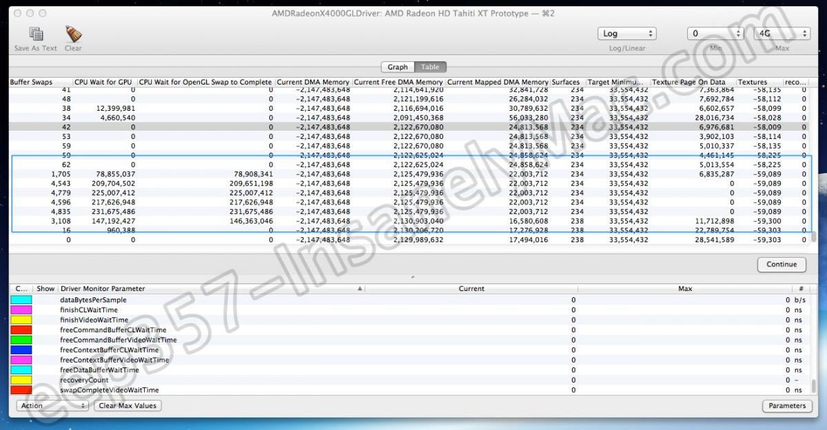

OK here is the results, highlighted the relevant time frame (it's pretty obvious), only displaying the data sets that have info, most the other monitoring options are just 0. This is not when the rain starts, but in the following scene almost exactly when the first lightning flash happens and the screen is focused on a large boulder.
What's also interesting is in windowed mode, while same thing does happen, if a portion of the window is covered up by another open window (monitor tool or a finder window) then it does not have the same problem at that spot in the bench and there's nothing unusual in the monitor readings. Moving half or most of the window off the desktop it will still stutter. Maybe a problem with an object or a buffer being brought forward?

I also used OpenDL Driver Monitor (Dev tools).
Running Valley in small window (640x360) to show Monitor beside.
I used low quality up to ultra + 8*AA (AA uses much more VRAM.
Beside that i run an other VRAM usage OpenGL/CL App OceanWave (needs about 70 MB VRAM).
I can see, that using ultra+8*AA (or for sure ultra + much higher res) the 5120 MB VRAM gets "out". Means cpu must swap VRAM.
That can be seen with the parameters : CPU Wait for VRAM Heap Allocation - which never gets more than 0 if VRAM is enough.
Also Texture Page Off Data gets > 0. Current Mapped DMA Memory in this case gets near 800 MB.
All those 3 parameters never got > 0 ( or in case of Mapped DMA much lower max value) if i didnt run Oceanwave beside Ultra+ 8*AA.
Your 1GB++ card should not show any non zero results in Texture page off or CPU Wait for VRAM Heap Allocation i think.
Pic shows running Valley in LOW and not running OceanWave OPenCL bench beside. If i run in Ultra+8*AA beside OceanWave i get big positive CPU Wait for VRAM Heap alloc and also Texture Page Off Data > 0.
