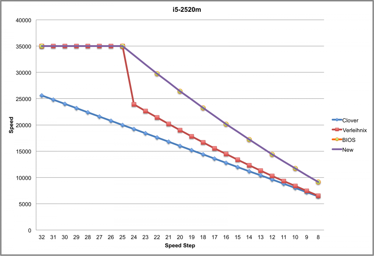

tluck Posted January 1, 2014 Share Posted January 1, 2014 so i was looking at the differences on performance between a custom ssdt and clover (generic P/C) .... bottom line, I get 5% more performance by using a proper SSDT custom built. The one verleihnix created for us works well, this utility builds one based on your CPU from the BIOS config so is matched to your box. Now, V's ssdt might be a tad lower on power consumption, I have decided to go with the higher performing curve! run the script (or .app) and it creates ssdt_pr.aml on your desktop $ ./ssdtPRGen.sh ssdtPRGen.sh v0.9 Copyright © 2011-2012 by † RevoGirl v6.6 Copyright © 2013 by † Jeroen v7.5 Copyright © 2013-2013 by Pike R. Alpha ---------------------------------------------------------------- System information: Mac OS X 10.9.1 (13B42) Processor Declaration(s) Found in DSDT (ACPI 1.0 compliant) Generating ssdt_pr.dsl for a MacBookPro8,1 [Mac-94245B3640C91C81] Sandy Bridge Core i5-2520M processor [0x206A7] setup [0x0603] With a maximum TDP of 35 Watt, as specified by Intel Number logical CPU's: 4 (Core Frequency: 2500 MHz) Number of Turbo States: 7 (2600-3200 MHz) Number of P-States: 25 (800-3200 MHz) Adjusting C-States for detected (mobile) processor Injected C-States for CPU0 (C1,C3,C6,C7) Intel ACPI Component Architecture ASL Optimizing Compiler version 20130117-64 [Jan 19 2013] Copyright © 2000 - 2013 Intel Corporation ASL Input: /Users/tluck/Desktop/ssdt_pr.dsl - 182 lines, 5697 bytes, 30 keywords AML Output: /Users/tluck/Desktop/ssdt_pr.aml - 1218 bytes, 11 named objects, 19 executable opcodes Compilation complete. 0 Errors, 0 Warnings, 0 Remarks, 0 Optimizations Do you want to copy /Users/tluck/Desktop/ssdt_pr.aml to /Extra/ssdt_pr.aml? (y/n)?n rename the output ssdt_pr.aml to ssdt.aml and move/copy the file to your clover location (/EFI/CLOVER/OEM/<product>/ACPI/patched) reboot! here is the difference in calculated watt values. msrdumper showed these states 8 12 16 21 25 26 27 28 29 30 31 32 ... with geek bench 3, i get 2500 single cpu - just what i would expect - using just clover 2380. Happy new year. 1 Link to comment https://www.insanelymac.com/forum/topic/285678-lenovo-thinkpad-t420-with-uefi-only/page/33/#findComment-1980666 Share on other sites More sharing options...

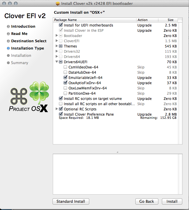

Matanel Sindilevich Posted January 1, 2014 Share Posted January 1, 2014 @tluck, thank you a lot for your guide (post #481) installing Mac OS X on Lenovo T420! One thing, though, that I couldn't get working is applying product-specific version/DSDT, as you described. What I did initially was renaming OEM/ProductID.1600x900 to OEM/4236AQ7. (This name is seen on a label on the bottom of my laptop: Product ID: 4236AQ7). But I had no sound (sound was supposed to be fixed by product-specific configurations, according to your guide). So I just copied the contents of the OEM/4236AQ7 folder over to the /Volume/ESP/EFI/CLOVER, replacing the generic config.plist (renamed at some point from config1600x900.plist) and the ACPI folder. This worked and sound system was identified by Mac OS. Another thing, is that hardware sound volume buttons are not synchronized with Mac OS's software sound volume control. When I change the volume with the hardware buttons -- the system volume control is kept at 100% volume. Physically, sound volume does change, though. The last issue I found, is inability of Mac OS to automatically set the Windows key to be the Command key, instead the Windows key would be treated as Alt, and Left Alt as Command key (I didn't check what Right Alt performs as, though). I solved by reassigning control keys in the keyboard preferences. Link to comment https://www.insanelymac.com/forum/topic/285678-lenovo-thinkpad-t420-with-uefi-only/page/33/#findComment-1980734 Share on other sites More sharing options...
tluck Posted January 1, 2014 Share Posted January 1, 2014 @Matanel you are welcome and welcome to the club! if sound is working when using the ESP top level ( where the custom kexts are) - then I am wondering if you have not installed/replaced the custom AppleHDA.kext (and others) in /S/L/E? yeah i noticed that same thing with the audio levels. i will double check, but this could be a new thing with mavericks. i suppose this comes down to personal preferences as OSX uses the same key location scheme as it would on a real mac - key order left to right is: control option/alt command spacebar command option where as the lenovo has : control windows alt spacebar alt menu control there are a couple of mapped keys though - blue Thinkpad makes the fan go to high speed. and the scrlk/pause buttons control LCD brightness. Link to comment https://www.insanelymac.com/forum/topic/285678-lenovo-thinkpad-t420-with-uefi-only/page/33/#findComment-1980779 Share on other sites More sharing options...
tluck Posted January 1, 2014 Share Posted January 1, 2014 reposted the zip file -- minor changes Clover UEFI on T420 Guide 01-Jan-2014 - update updated to Clover b2428 (with just ThinkPad theme) removed ssdt.aml added ssdtPRgen-clover.command script so you can create your own SSDT P/C state tables added Utilities folder with cvad's Kext Utility.app and manual kext _install_SLE.bash script Link to comment https://www.insanelymac.com/forum/topic/285678-lenovo-thinkpad-t420-with-uefi-only/page/33/#findComment-1980868 Share on other sites More sharing options...
Matanel Sindilevich Posted January 2, 2014 Share Posted January 2, 2014 @Matanel you are welcome and welcome to the club! Thank you! if sound is working when using the ESP top level ( where the custom kexts are) - then I am wondering if you have not installed/replaced the custom AppleHDA.kext (and others) in /S/L/E? Actually, I did install all the custom KEXT's into /S/L/E. I have used this Kext Utility app you have recommended. After I re-installed Mavericks fresh to check once again will the OEM folder work, I went on installing Windows as a dual-boot. Then, after an unidentified number of reboots Mac OS did pick up settings from OEM/<Product ID>. And, since all the custom KEXT's were in place in /S/L/E sound started to work for me! apparently, here is some "magic" in those reboots. i suppose this comes down to personal preferences as OSX uses the same key location scheme as it would on a real mac - Connecting a Lenovo desktop keyboard via USB, though will map keyboard modifier keys correctly. Will double-check the layout of that desktop keyboard to make sure it is same/different comparing to Lenovo T420's built-in keyboard. I will give a try to the new version of Clover config. I don't need to reinstall everything for that purpose, right? Just mounting the ESP partition and copying over files from the ZIP? Another question, if I may, I have two entries for booting Windows on the Clover boot screen. Only one of them would really boot into Windows, where another will just return to the Clover boot screen. I did a dual-boot by copying /Volumes/ESP/EFI/CLOVER/CLOVERX64.efi to be /Volumes/ESP/EFI/Microsoft/Boot/bootmgfw.efi, whereas renaming the original bootmgfw.efi to bootmgfw-orig.efi. Is this a way to remove/hide non-working boot entry in the Clover boot screen? Link to comment https://www.insanelymac.com/forum/topic/285678-lenovo-thinkpad-t420-with-uefi-only/page/33/#findComment-1980994 Share on other sites More sharing options...

Matanel Sindilevich Posted January 2, 2014 Share Posted January 2, 2014 Create custom SSDT for proper P/C states to match system (optional - but this tool may do a better job than Clover) Run ssdtPRgen-clover.sh script (modifed to work with clover!) in Utilities folder It should ask you if you want copy ssdt.aml to your OEM folder, otherwise rename ~/Desktop/ssdt_pr.aml to ssdt.aml and copy/move ssdt.aml to same location as your dsdt.aml i.e /Volumes/ESP/EFI/CLOVER/OEM/<product>/ACPI/patched Running ssdtPRgen-clover.sh requires an Internet connection. It tries to download iasl from GitHub. Sometimes, though, an Internet connection is unavailable. I haven't had Ethernet working until I installed the Ethernet KEXT to /S/L/E and then rebooted. But the course of the guide suggests you do the KEXT copying and running ssdtPRgen-clover.sh without rebooting the machine in-between. Also, no WiFi working. Does it mean the integrated Lenovo T420's wireless card is not supported in Mac OS X? Link to comment https://www.insanelymac.com/forum/topic/285678-lenovo-thinkpad-t420-with-uefi-only/page/33/#findComment-1981027 Share on other sites More sharing options...
tluck Posted January 2, 2014 Share Posted January 2, 2014 @matanel - thanks for the feedback on sequence of steps - good points on the reboots, ethernet and the SSDT tool. i will add some notes on that. I am thinking the issues you had with no sound between several reboot may have to do the kext cache not being updated? but you got there. and you are correct the Intel WiFi card is not usable by OSX. for along time i used an external USB for wifi but then I decided to replace my card with an Atheros AR5BH92 for $6. works for windows too. as far as boot menu... if you are using the OEM/<product>/config.plist vs top level config.plist on with the primary boot disk with both OSX and Windows the GUI should look something like this: i have 4 entries - default is OSX+ Boot Microsoft EFI boot menu from EFI Boot UEFI Internal from EFI Boot Mac OS X from OSX+ Boot Recovery from Recovery HD the bootmgfw.efi on my system is from microsoft vs clover these 2 boot mechanisms work independently and don't interfere with each other /EFI/CLOVER ... for OSX /EFI/Microsoft ... for Windows as far as clover pkg installation, i would install to get the OSX resident stuff - it will not overwrite the configuration OEM stuff. you can pick out and remove the extra stuff it installs such as the 32bit stuff or just replace the whole CLOVER folder from the zip. the latest zip was b2428. these are the options i use: 1 Link to comment https://www.insanelymac.com/forum/topic/285678-lenovo-thinkpad-t420-with-uefi-only/page/33/#findComment-1981124 Share on other sites More sharing options...

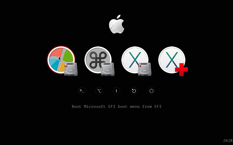

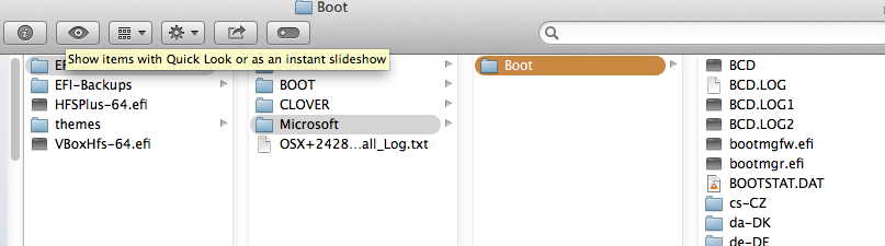

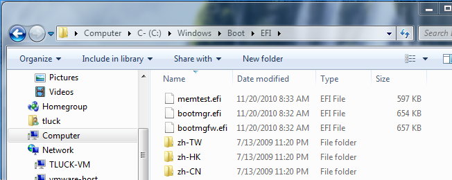

Matanel Sindilevich Posted January 2, 2014 Share Posted January 2, 2014 @tluck as far as boot menu... Apparently, after upgrading to the latest Clover build b2428, the boot entries got in order, with only one entry for Windows. So maybe the double-icon for Windows was just a glitch of previous Clover builds. the bootmgfw.efi on my system is from microsoft vs clover these 2 boot mechanisms work independently and don't interfere with each other /EFI/CLOVER ... for OSX /EFI/Microsoft ... for Windows Did you install Windows prior to Mac OS? I did install Mac OS first, then installed Windows (both in UEFI mode, of course). In that scenario Windows boot loader would prevail and boot straight into Windows, instead of showing the Clover boot menu. Therefore, I had to copy CLOVERX64.efi from Clover to Microsoft folder as bootmgfw.efi, per this blog: http://www.tonymacx86.com/hp-probook/103945-dual-booting-w8-os-x-uefi-4.html. as far as clover pkg installation, i would install to get the OSX resident stuff - it will not overwrite the configuration OEM stuff. you can pick out and remove the extra stuff it installs such as the 32bit stuff or just replace the whole CLOVER folder from the zip. the latest zip was b2428. Wow, that is exactly what I needed -- an example of Clover installation options. I didn't see using RC scripts anywhere, though. Am I wrong? Basically, I learned the following is customized by you, whereas other stuff flows in untouched from Clover, correct? <ZIP file>/T420/EFI/CLOVER/ACPI/patched folder <ZIP file>/T420/EFI/CLOVER/kexts folder <ZIP file>/T420/EFI/CLOVER/OEM folder <ZIP file>/T420/EFI/CLOVER/config.1366x768.plist file And <ZIP file>/T420/EFI/CLOVER/config.1600x900.plist file As for ssdtPRgen-clover.sh it does generate two files: ssdt_pr.aml and ssdt_pr.dsl. But you only guide to copy the .AML one over. Why not both of them? It probably seems like a lot of questions. The reason is I am a newbie in this area and want to understand how things work. I have had a real iMac for 8 years up until recently, when its power module has died. Now trying to get Mac OS glory back with a backup hardware. My ultimate goal for now is trying to understand what is going on under the covers in Hackintosh and try to get a newer laptop model work with Mac OS -- Lenovo T440P. Now only I have a theoretical knowledge for auto-generation of DSDT's (by Clover) and SSDT's (by ssdtPRgen-clover.sh). But area of KEXT modification seems too unexplored now. Also the ease you guys exchange pieces of AML and DSL files for DSDT and SSDT... Just awesome. Link to comment https://www.insanelymac.com/forum/topic/285678-lenovo-thinkpad-t420-with-uefi-only/page/33/#findComment-1981138 Share on other sites More sharing options...
tluck Posted January 2, 2014 Share Posted January 2, 2014 the install order does NOT matter all that much. if you just installed windows natively then i think you end up with the microsoft version of /EFI/BOOT/BOOTx64.efi but then clover replaces that (BOOTx64.efi is a copy of CLOVERx64.efi). you can also remove that entry from the boot list. or add it specifically. anyway you can get the MS boot loader from the windows install ... my efi folder looks like this: I like it this way so that they are independent - clover does a nice job of listing the windows boot option and the rest is pure MS. .aml is the compiled assembly file and .dsl files are the decompiled source. the aml files are used at boot. have fun. Link to comment https://www.insanelymac.com/forum/topic/285678-lenovo-thinkpad-t420-with-uefi-only/page/33/#findComment-1981154 Share on other sites More sharing options...
