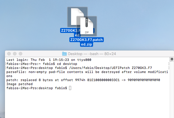

On 2/2/2018 at 3:47 PM, camillionario said:
The BIOS patch works !!
I managed to flash BIOS and unlock MSR ok, I have restarted a couple of times and everything is perfect.
Attached Bios Modified if someone is interested. (BIOS VERSION 7)
Thanks Fabiosun
Z270GK3.F7.patched.zip
