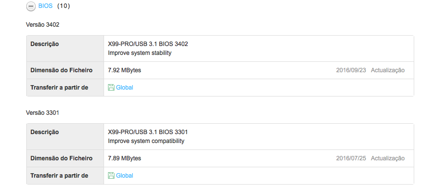

Fergarth Posted September 27, 2016 Share Posted September 27, 2016 Last Bios from Asus Site Link to comment https://www.insanelymac.com/forum/topic/285444-uefipatch-uefi-patching-utility/page/77/#findComment-2286541 Share on other sites More sharing options...
