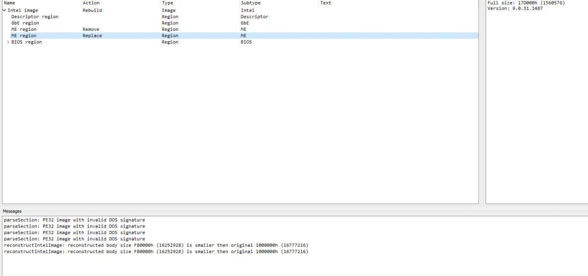

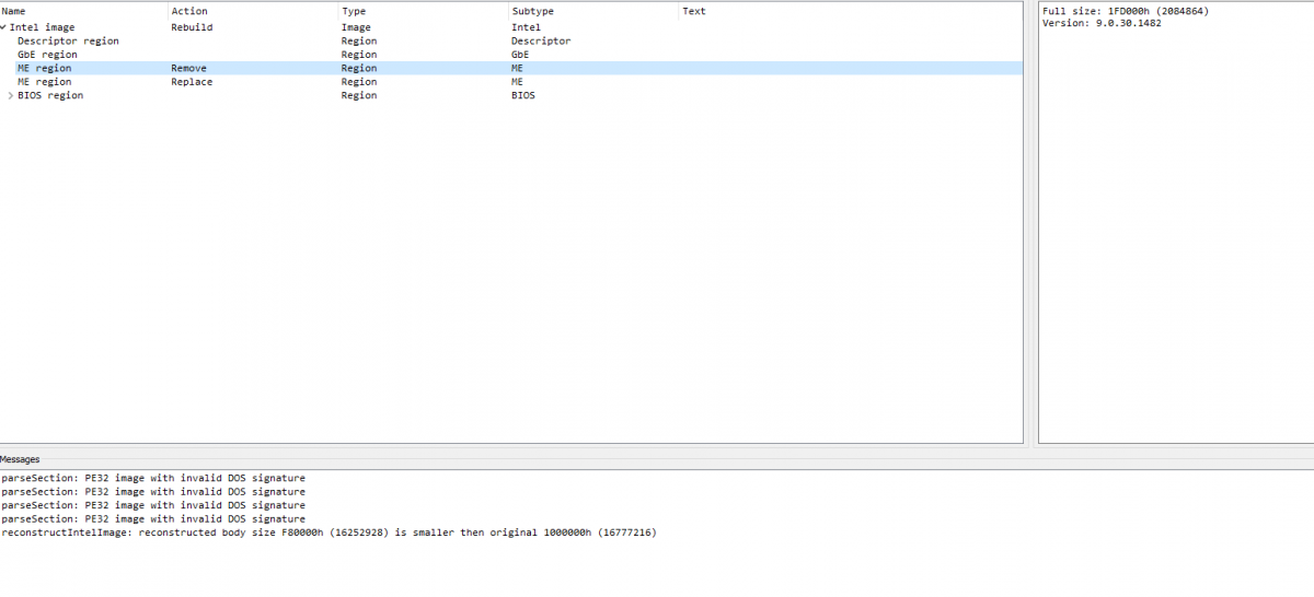

Kynyo Posted December 8, 2015 Share Posted December 8, 2015 Hello everyone! I don't know if i'm posting into correct section but I'd like to update my Management Engine FIrmware and UEFITool gives me this error: reconstructIntelImage: reconstructed body size F80000h (16252928) is smaller then original 1000000h (16777216) So, it's that normal, or it because i'm trying to modify a genuine gigabyte BIOS file? Actually, I saw that ME Region it's unlocked, so it's not a problem replacing the firmware with a new version. It seems pretty comod because otherwise I have to flash it from Windows using specific tools and i want to put directly into BIOS using this UEFITool feature. @CodeRush, thanks for this great tool, it's really helping the entire community! Link to comment https://www.insanelymac.com/forum/topic/285444-uefipatch-uefi-patching-utility/page/75/#findComment-2194899 Share on other sites More sharing options...

CodeRush Posted December 9, 2015 Author Share Posted December 9, 2015 Kynyo, it's a bug in both Gigabyte descriptor and UEFITool, will try to get rid of it, thanks for pointing me out. You can use hex editor to replace the ME region manually, but I don't recommend doing it at all, use FwUpdLcl to update the existing one, if nothing blocks ypu from it. Link to comment https://www.insanelymac.com/forum/topic/285444-uefipatch-uefi-patching-utility/page/75/#findComment-2195400 Share on other sites More sharing options...

Kynyo Posted December 9, 2015 Share Posted December 9, 2015 Kynyo, it's a bug in both Gigabyte descriptor and UEFITool, will try to get rid of it, thanks for pointing me out. You can use hex editor to replace the ME region manually, but I don't recommend doing it at all, use FwUpdLcl to update the existing one, if nothing blocks ypu from it. Ok, Thanks! Link to comment https://www.insanelymac.com/forum/topic/285444-uefipatch-uefi-patching-utility/page/75/#findComment-2195511 Share on other sites More sharing options...
