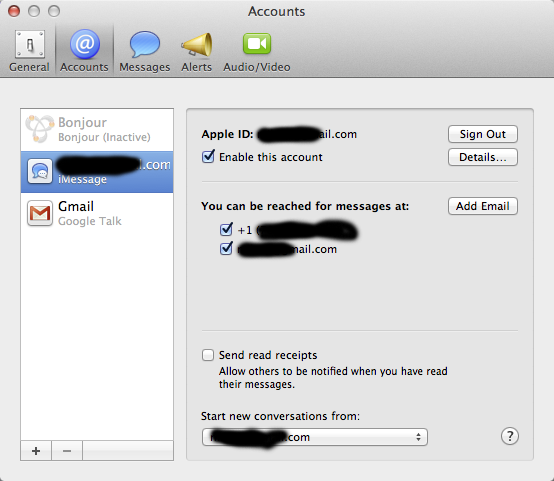

Ok! Huge progress to report. I was able to sign into iMessage and register!
Here is what I learned:
  • My serial number is set to a real MacPro 3,1 serial (which is what I'm set up as in SMBIOS)
  • I manually set the NVRAM MLB variable to the board serial of a real MacPro3,1
  • I manually set the NVRAM ROM variable to my MAC address (Gigabyte onboard NIC, not Apple)
  • My IOPower values for Gq3489ugfi, Fyp98tpgj and kbjfrfpoJU are all set, but do not correspond to what a real MacPro report
  • My MAC address is that of a Gigabyte NIC, not Apple
  • My Hardware UUID is as it always was, and does not correspond to a real MAC
  • The problem was my IOPower values in NVRAM where blank - I tested using real values from a MacPro3,1 by the method described below:
    • oycqAZloTNDm: <00000000 00000000 00000000 00000000 00>
    • abKPld1EcMni: <00000000 00000000 00000000 00000000 00>
I did a quick little hack in GDB to set these two values and was able to sign in without an issue. Here is how I did that:
  • Set those 2 values in NVRAM using the nvram command (effectively placing them in IODeviceTree:/options)
  • I put a breakpoints at the instructions 0x39c18 and 0x39c8c from IMDAppleServices (disassemble in Hopper demo to see what these are)
  • Began to sign into iMessage, breakpoint #1 eventually trips
  • Looked at the stack to see what was being placed into %rsi (the value pointing to IODeviceTree:/options) and continued
  • Breakpoint #2 trips moments later, but I've stopped after it has placed the IOPower pointer into %rsi, at which point I replace it with what I found in the previous breakpoint. Effectively making IMDAppleServices pull the values from IODeviceTree:/options (where I can easily set it), as opposed to IOPower.
  • Viola - iMessage signs in!
Long story short:
  • IOPower Gq3489ugfi, Fyp98tpgj and kbjfrfpoJU are all used and require values, but the value doesn't seem to matter - whatever is setting them now seems to be doing so appropriately.
  • SMBIOS values I have set include: SMfamily, SMproductname, SMboardproduct, SMserial, SMbiosversion, SMmanufacturer, SMbiosvendor. Based on verbose logging of imagent, the family, product name, board product, and serial are used for sure.
  • Hardware UUID is used, but value doesn't seem to matter
  • ROM and MLB NVRAM values are required and seem to trigger the new authentication method as opposed to the Beta method. The ROM value seems to be happy if it matches your primary network interface. Not sure about MLB - it is definitely the board serial, but whether it must be valid, or further to that - match your platform serial in some way, I'm not sure.
  • IOPower NVRAM values oycqAZloTNDm and abKPld1EcMni must be set - no idea what they are however.
