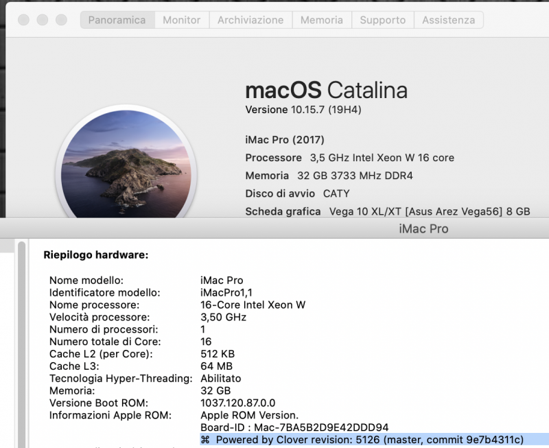

52 minutes ago, Jief_Machak said:
I can't find it because there is too much in the last 3 days, but I think I saw a message about someone having something that works in OC but not in Clover. Am I right ?
@Jief_Machak Maybe you are referring to the discussion between @Andres ZeroCross and @Slice about IgnoreInvalidFlexRatio = True. It's page #987 :) the problem is happened in his Lenovo X250 (Broadwell, I suppose).
from me Clover now works everywhere, chirao that everyone has to put to point kexts and config on their hack, alone without doing anything, unlikely functions.

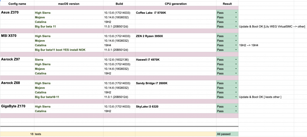

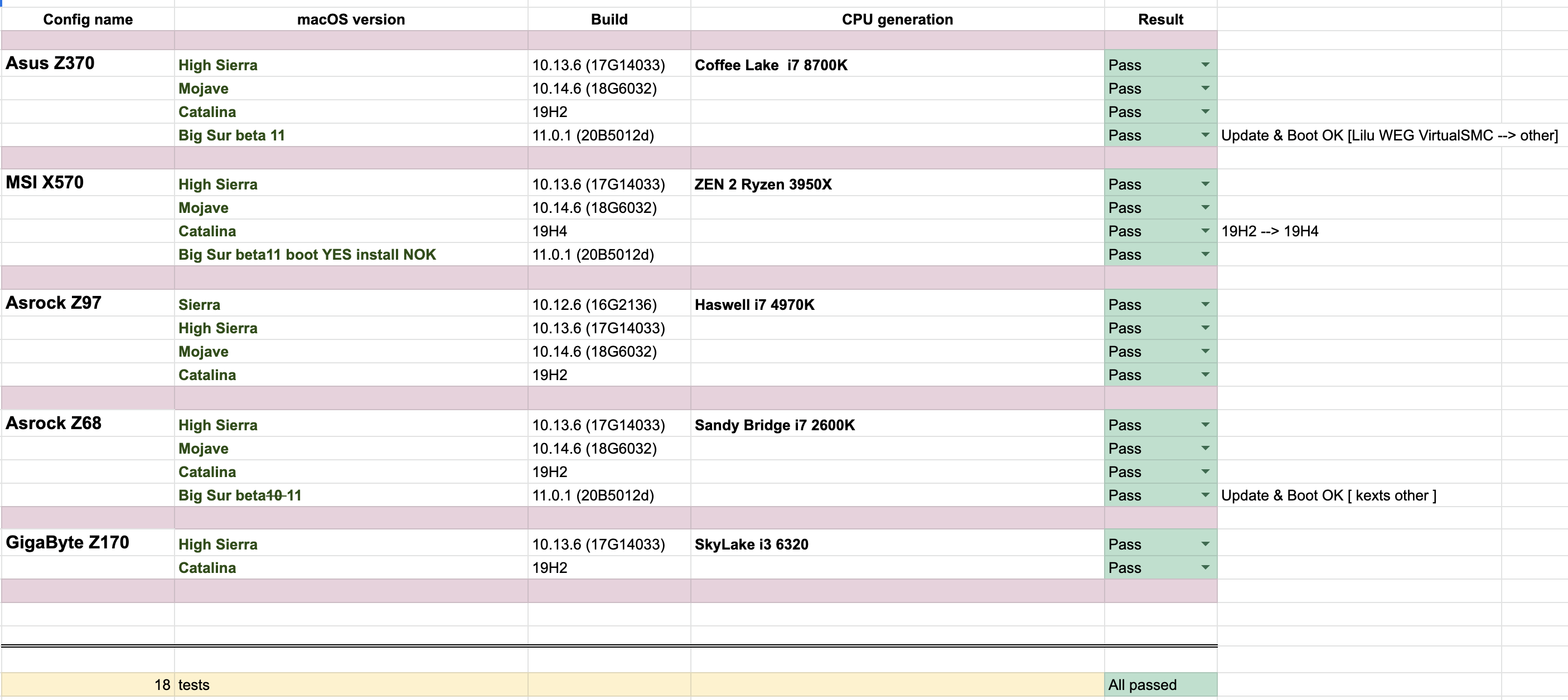

1696148948_Schermata2020-11-02alle16_16_06.thumb.png.22353386240ba2c2dfc3b74bb485df0c.png
I only have a few quirks when I update BigSur or as yesterday on the X570 catalina from H2 to H4 (downloaded full installer) on the first restart ... no panic :D
1620839258_Schermata2020-11-01alle23_14_
verified the systemversions of the preboots of catalina and bigsur, but nothing strange detected
finished updating using icon to the right of catalina
755576635_Schermata2020-11-01alle22_56_5

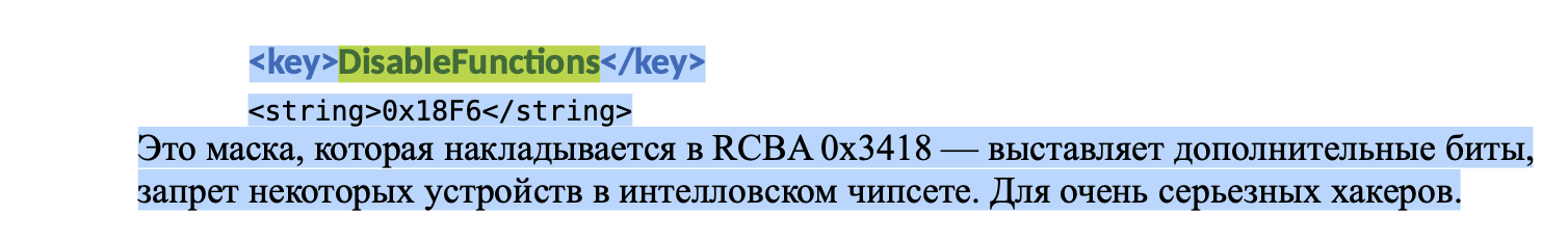

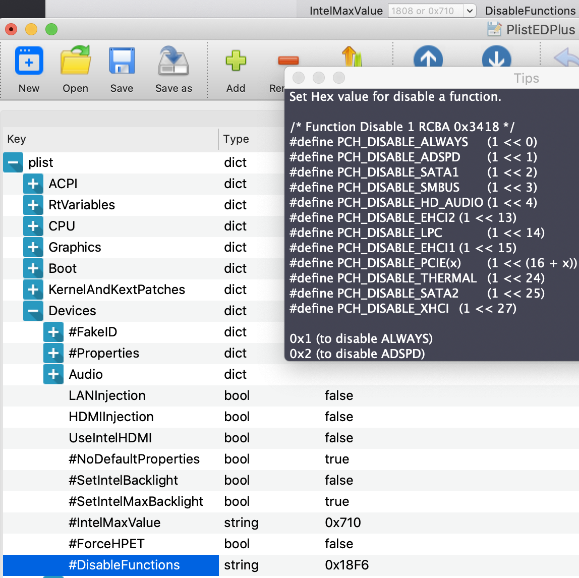

@ellaosx the value was found in the sample-config for DisableFunctions, I have no idea what it represents....
Unknown documentation, only the original developer knows LOL

if you read here you will understand better:
not long ago there was the guide.pdf in Russian
1689515523_Schermata2020-11-02alle17_08_02.thumb.png.8b5e20e446bddb78109d1ab202ee1ddf.png
1401979855_Schermata2020-11-02alle17_14_20.thumb.png.3aba061c05c8d0883ad99cfb7307d7e4.png
<key>DisableFunctions</key>
       <string>0x18F6</string>
This mask, which is superimposed in RCBA 0x3418 - exposes additional bits, banning some devices in the Intel chipset. For very serious hackers.
Edited by iCanaro

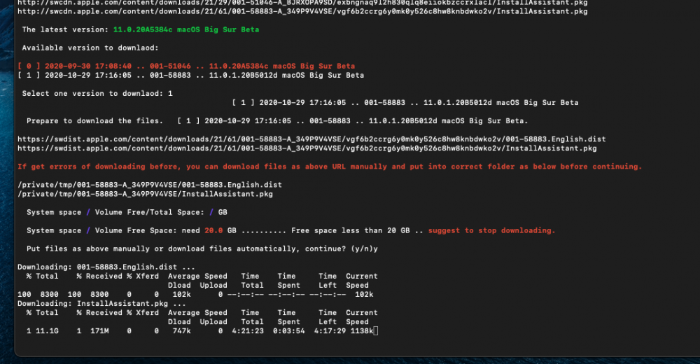

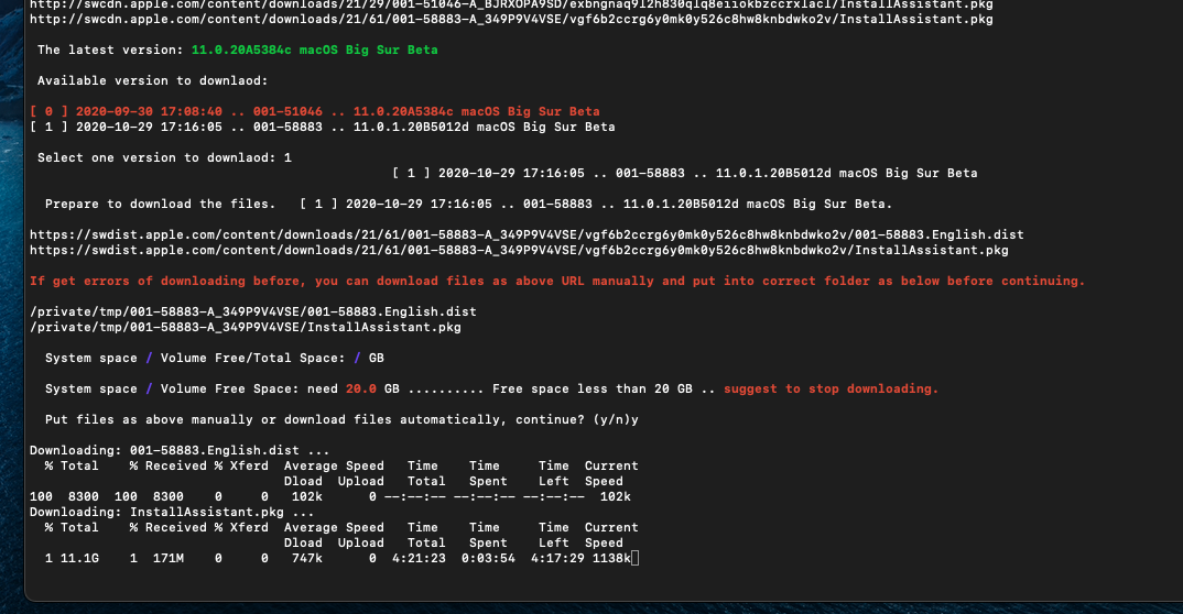

Strange today, downloading bigsur 11.0.1 is very slow.
Have tried test speednet, no problem.
Is the problem likely to come from the apple server?
  • Confused 1

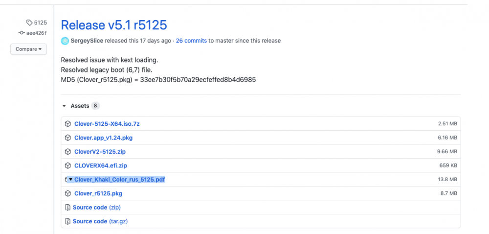

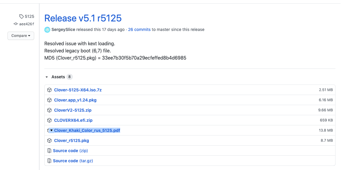

it was available on github for a while, then I don't know why it was taken off... but I save everything locally, so if you want it, here it is
https://mega.nz/file/riYFzYAZ#6vPlcaRAAAKInXpFiRGEHOhoZiDJvY4aO3Nb9X6YUic
  • Thanks 3
It is still present on github.
But one man was going to translate it to Italian. We are waiting?
  • Thanks 2

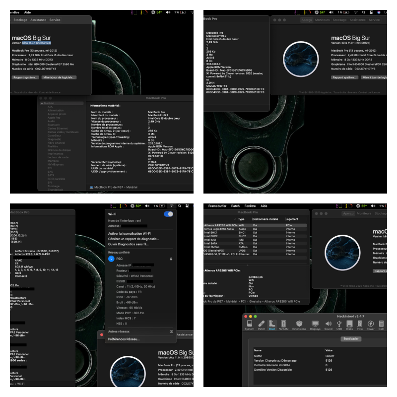

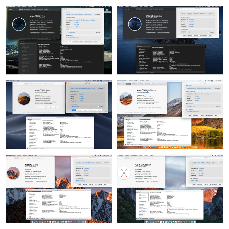

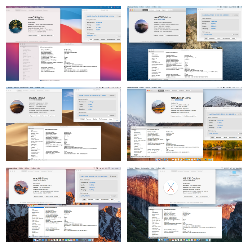

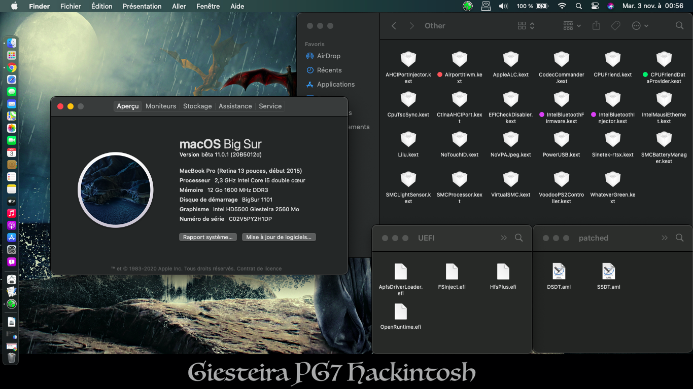

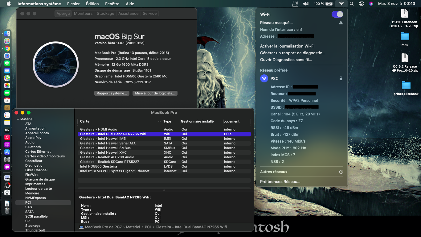

Dell Vostro 2520
intel i5-3210M
intel HD4000
Cirrus CS4213 = Kext VoodooHDA "ALC NO Signal" (AppleHDA CS4213 Mirone)
Atheros AR9285 = Dual Kext (AirPortAtheros40.kext ID inser pci168c, 2b) + (HS80211Family.kext) Dossier Kext / Other Clover
Système de démarrage OK = El Capitan a BigSur beta 11.0.1
programme d'installation BigSur Beta 11.0.1 complet CLOVER r5126
* Atheros Wifi !!!!
inser kext (ID AirPortAtheros40.kext inser pci168c, 2b) + (HS80211Family.kext) Dossier Kext
Compliquee a faire fonctionner !!!!!
* sur les AIO "All In One" HP ça fonctionne directement
** sur mes ordinateur portable NE marche pas directe
suivre ces pas
faire boot avec OpenCore et mettre les kext sur le dossier Kext aussi que sur Config.plist (auto avec ProperTree)
une fois sur le système activez le Wifi car il marche directe avec OpenCore
récupérez les Kext une fois le Wifi ACTIVEE avec Opencore "et oui les kext qui sont sur OpenCore"
remettre les Kext que sur activee le WIfi sur OPENCORE et pas outres, sur le EFI Clover r5126 dans le dossier avec les outres kext
redémarrer
réinitialiser la NVRAM aussi que Clean NVRAM !!! important les deux!
botte AVEC Clover
une fois sur le BigSur votre Wifi doit être deja activee et vous demande meme plus de password !!!
dans mon cas je arrive a le faire commeça peut etre il auras des outres astuces
desole par la langue de l'écriture sur le forum mais pour le pas a pas j'ai donc prefere car le traductor fausse pas mal!
les kext Wifi vous les trouvez bien sur ici sur le Forum
traductor !!!
Boot system OK = El Capitan a BigSur beta 11.0.1
BigSur Beta 11.0.1 full installer CLOVER r5126
* Atheros Wifi !!!! insert kext (ID AirPortAtheros40.kext insert pci168c, 2b) + (HS80211Family.kext) Kext folder
Complicated to operate !!!!!
* on HP "All In One" AIOs it works directly
** on my laptops DOES NOT work directly follow these steps boot with OpenCore and put the kext on the Kext folder as well as on Config.plist (auto with ProperTree) once on the system activate the Wifi because it works directly with OpenCore recover the Kext once the Wifi ACTIVATED with Opencore "and yes the kext which are on OpenCore" put back the Kext that on activated the WIfi on OPENCORE and not on the EFI Clover r5126 in the folder with the kext on to restart reset NVRAM as well as Clean NVRAM !!! important both! boot WITH Clover once on the BigSur your Wifi must already be activated and even asks you for more password !!! in my case I manage to do it as it can be he will have other tips sorry by the language of the writing on the forum but for the step by step I therefore preferred because the traductor falsify a lot! the kext Wifi you find them of course here on the Forum
Divulgacher

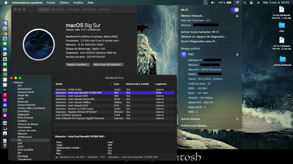

EliteBook 820 G2
intel i5-5300U
intel HD5500 (patch DSDT no fournie)
Wifi Intel AC7265
bootloader Clover r5126
install + Boot BigSur Beta 11.0.1 100% OK
Spoiler
1666534388_Capturedecran2020-11-03a00_56_22.thumb.png.5e923d174d38a8eacd58ff1b07b022b2.png1549637319_IntelWifi.thumb.png.c2d318bf8120201983bf15c33b6bf509.png1988113850_elitebooksystem.thumb.png.06a2efc7316f58eb1f6d6f1181efc8f2.png
CLOVER.zip
  • Thanks 2
3 hours ago, naiclub said:
Who has problems with compilers? some clover
Terminal Saved Output4.text
As far as I remember the folder src is required
Not
/Users/baby/CloverBootloader
but
/Users/baby/src/CloverBootloader
