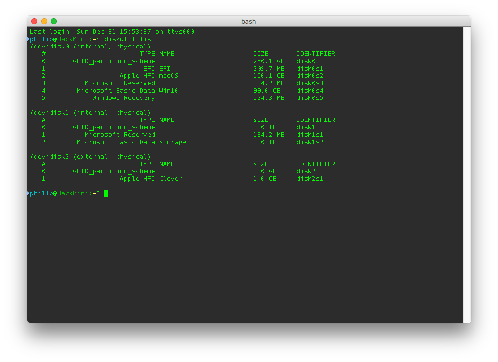

Some shots/dumps from Terminal with sudo diskutil list would be helpful.
apianti, no, I used "diskutil list" after macos diskutility formatting. there is no efi partition.  The MBR+msdos combination works fine though, as I wrote. So my bios seems to be capable of reading FAT16. Also I assume FAT16 actually nowadays is the same as FAT32. I don't have linux.
And I'll repeat myself then it was not a properly formatted GPT disk.... Don't make that assumption about FAT16 and FAT32 because it's 100% not accurate. Almost all Linux distros can run from a USB without needed to be installed, just by burning the ISO to the USB.

As apianti said, something wrong happens in Disk Utility with this USB drive. The GPT formatted drive always has an EFI partition at the beginning, no matter what FS should be used for the rest.
I agree. I feel like disk utility never works right. I try not to format a whole disk in disk utility because it usually does not end up well. Will only reformat an HFS+ partition I created in linux to make it correctly journaled.

FlashDrives under 1Gb are always formats without EFI partition in macOS Disk Utility.
