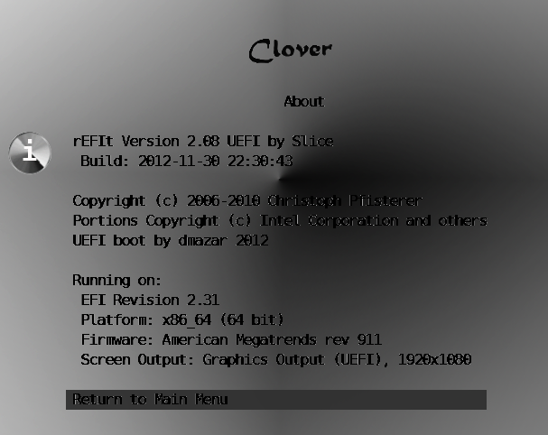

Slice Posted November 30, 2012 Share Posted November 30, 2012 Don't know what is the problem with sleep/wake. Nov 30 22:44:08 localhost WindowServer[97]: handle_will_sleep_auth_and_shield_windows: no action for lock state 1 Nov 30 22:44:08 localhost kernel[0]: Wake reason: PWRB (User) Clover-911-test.zip Test, please, this combination for UEFI boot. My config is almost empty. <key>ACPI</key> <dict> <key>DsdtName</key> <string>DSDT-n.aml</string> <key>DropOemSSDT</key> <string>Yes</string> <key>GenerateCStates</key> <string>Yes</string> <key>GeneratePStates</key> <string>Yes</string> <key>PLimitDict</key> <string>0</string> <key>UnderVoltStep</key> <string>0</string> <key>EnableC6</key> <string>No</string> <key>EnableC4</key> <string>No</string> <key>EnableC2</key> <string>Yes</string> <key>EnableISS</key> <string>Yes</string> <key>ResetAddress</key> <string>0xCF9</string> <key>ResetValue</key> <string>0x06</string> <key>smartUPS</key> <string>No</string> <key>PatchNMI</key> <string>No</string> <key>FixDsdtMask</key> <string>0xB1BF</string> </dict> <key>Graphics</key> <dict> <key>GraphicsInjector</key> <string>Yes</string> <key>FBName</key> <string>Ipomoea</string> <key>LoadVBios</key> <string>No</string> <key>VideoPorts</key> <string>3</string> <key>PatchVBios</key> <string>Yes</string> </dict> <key>CPU</key> <dict> <key>Turbo</key> <string>No</string> <key>ProcessorType</key> <string>0x0903</string> <key>BusSpeedkHz</key> <string>99790</string> <key>QPI</key> <string>6400</string> </dict> <key>KernelAndKextPatches</key> <dict> <key>KernelCpu</key> <string>No</string> <key>ATIConnectorsController</key> <string>6000</string> <key>ATIConnectorsData</key> <string>000400000403000000010000120401050008000004020000000100001102040310000000100000000001000000000002</string> <key>ATIConnectorsPatch</key> <string>040000000403000000010000100001061000000010000000000100000000000100080000040200000001000012040403</string> <key>AsusAICPUPM</key> <string>No</string> <key>AppleRTC</key> <string>Yes</string> <key>KextsToPatch</key> <dict> <key>0</key> <dict> <key>Name</key> <string>VoodooHDA</string> <key>Find</key> <data>SGVhZHBob25lcwA=</data> <key>Replace</key> <data>VGVsZXBob25lcwA=</data> </dict> <key>1</key> <dict> <key>Name</key> <string>AppleAHCIPort</string> <key>Find</key> <data>RXh0ZXJuYWw=</data> <key>Replace</key> <data>SW50ZXJuYWw=</data> </dict> </dict> </dict> and serials/uuid/volumes Link to comment https://www.insanelymac.com/forum/topic/284656-clover-general-discussion/page/24/#findComment-1870133 Share on other sites More sharing options...

shiecldk Posted December 1, 2012 Share Posted December 1, 2012 @Slice Wake works better with the drivers64UEFI in r911. But I still need -v to get it wake. I've tried to boot with "WithKexts" in normal boot (none -v), but still no luck. So the problem is not about kernelcache. And darkwake=0 dosen't work on my system. (need to press power button twice to get it wake) Link to comment https://www.insanelymac.com/forum/topic/284656-clover-general-discussion/page/24/#findComment-1870329 Share on other sites More sharing options...
