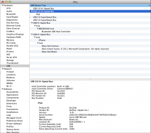

Stefan Milev Posted September 13, 2014 Share Posted September 13, 2014 Thanks guys for your replays. This is what is in config.plist: <key>USB</key> <dict> <key>FixOwnership</key> <true/> <key>HighCurrent</key> <true/> <key>Inject</key> <true/> </dict> I tried all the USB ports, the keyboard was just an example. 2.0 and 3.0 all say the same 500 mA. I've seen screens from people using the generic driver and getting around 2A. By the way I'm talking about current, not voltage. Voltage on USB ports should be always constant 5 volts. Link to comment https://www.insanelymac.com/forum/topic/284656-clover-general-discussion/page/222/#findComment-2060204 Share on other sites More sharing options...

Stefan Milev Posted September 13, 2014 Share Posted September 13, 2014 I just tried that, but for me there were no difference. iPhone charges with or without this in config. iPad is what I'm after. A screenshot from the genericUSBHCI topic which shows what I'm after. Pay attention to the last raw where it says extra current 1600 mA. Link to comment https://www.insanelymac.com/forum/topic/284656-clover-general-discussion/page/222/#findComment-2060350 Share on other sites More sharing options...

Maniac10 Posted September 13, 2014 Share Posted September 13, 2014 I can't see your ioreg nor DSDT cause I'm on my iPad right now, but I can see you have enabled the DSDT USB fix but not the DTGP one, and the first won't work without the second. Try enabling the AddDTGP_0001 fix and check the current again. Ignore this if you already have the method in your custom DSDT, I'll take a better look at the dumps on monday in my hack. Link to comment https://www.insanelymac.com/forum/topic/284656-clover-general-discussion/page/222/#findComment-2060415 Share on other sites More sharing options...
Stefan Milev Posted September 14, 2014 Share Posted September 14, 2014 I have a custom DSDT but I don't have this fix in it.I tried removing the DSDT and enabling it in config plus USB fix, but there were no result and I couldn't boot. Kernel panic and fast reboot. Link to comment https://www.insanelymac.com/forum/topic/284656-clover-general-discussion/page/222/#findComment-2060473 Share on other sites More sharing options...
Maniac10 Posted September 14, 2014 Share Posted September 14, 2014 Don't remove the DSDT, the fixes can be applied on top of the custom one as long as there's no DSM method in your USB devices. If you do have them you can delete them so they don't overlap. Alternatively you can enable the corresponding DSM drop table or add the current fix to the existing DSDT. Link to comment https://www.insanelymac.com/forum/topic/284656-clover-general-discussion/page/222/#findComment-2060521 Share on other sites More sharing options...
Stefan Milev Posted September 14, 2014 Share Posted September 14, 2014 I will try on top no problem as I didn't do it in DSDT, but it didn't when I tried before. What do you have in USB section if you plug something more power hungry? Does anyone at all have the extra current without using genericUSBHCI kext? The thing is that I'm not even sure that it's possible because I have seen it anywhere besides the above mentioned topic. Would be nice if I have confirmation that it's possible. Link to comment https://www.insanelymac.com/forum/topic/284656-clover-general-discussion/page/222/#findComment-2060538 Share on other sites More sharing options...
Maniac10 Posted September 15, 2014 Share Posted September 15, 2014 As I told you before, the USB DSDT fix requires the DTGP method, it won't work otherwise. I charge my iPad with my hack all the time, without the extenal kext. I don't remember the exact current amount but it works just fine. I'll show you the USB system profile section later, when I'm back in my hack. Link to comment https://www.insanelymac.com/forum/topic/284656-clover-general-discussion/page/222/#findComment-2060678 Share on other sites More sharing options...
