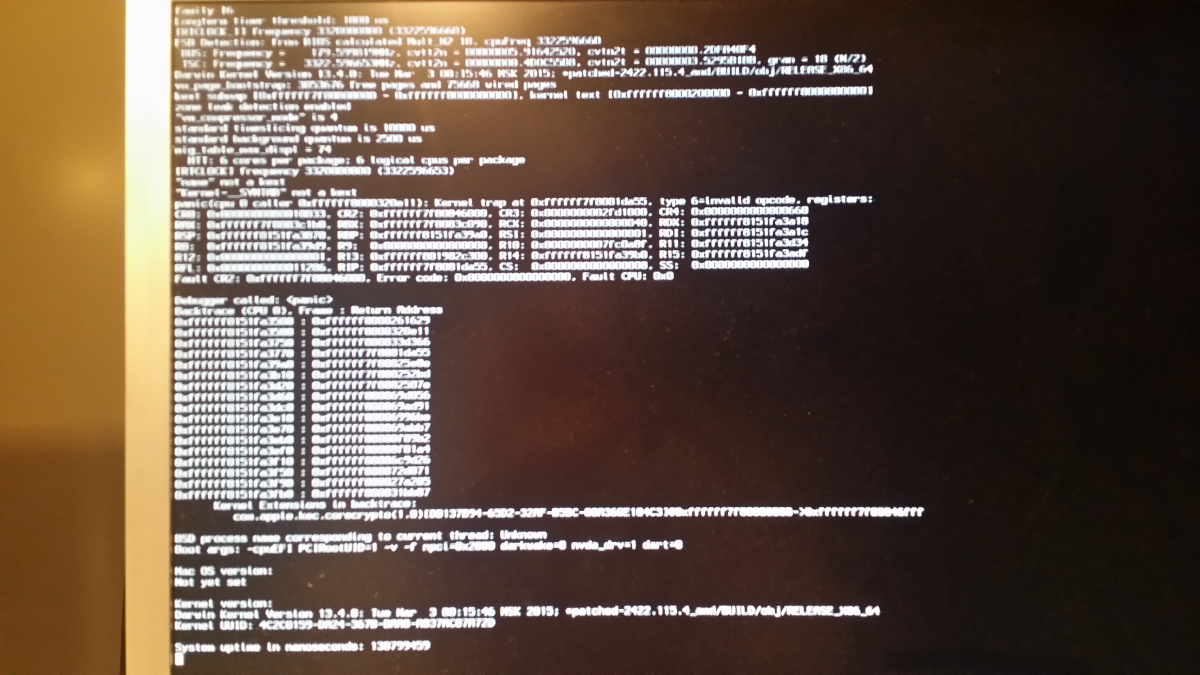

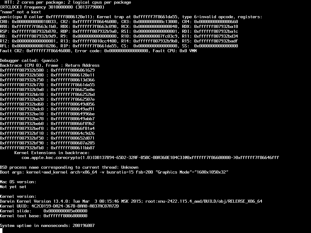

spakk Posted March 3, 2015 Share Posted March 3, 2015 (edited) Hi Bronya, tested with my hardware, unfortunately with kernel panic (Mavericks 10.9.5 last Build) the test I have done without the boot file that you have added to the package. Edited March 3, 2015 by spakk Link to comment https://www.insanelymac.com/forum/topic/281450-mavericks-kernel-testing-on-amd-formerly-mountain-lion-kernel-testing-on-amd/page/254/#findComment-2117424 Share on other sites More sharing options...
Bronya Posted March 3, 2015 Share Posted March 3, 2015 Hi spakk , thank ! Wait for kernel )) 1 Link to comment https://www.insanelymac.com/forum/topic/281450-mavericks-kernel-testing-on-amd-formerly-mountain-lion-kernel-testing-on-amd/page/254/#findComment-2117429 Share on other sites More sharing options...
non@me Posted March 3, 2015 Share Posted March 3, 2015 I also have kernel panic with the latest Bronya kernel on my Phenom II x4 945 / VMware Workstation. Link to comment https://www.insanelymac.com/forum/topic/281450-mavericks-kernel-testing-on-amd-formerly-mountain-lion-kernel-testing-on-amd/page/254/#findComment-2117431 Share on other sites More sharing options...
Bronya Posted March 3, 2015 Share Posted March 3, 2015 I fix and tested on my Athlon II X2 250 - this work. Kernel work only on 10.9.5 . I found ... Wait... 1 Link to comment https://www.insanelymac.com/forum/topic/281450-mavericks-kernel-testing-on-amd-formerly-mountain-lion-kernel-testing-on-amd/page/254/#findComment-2117435 Share on other sites More sharing options...

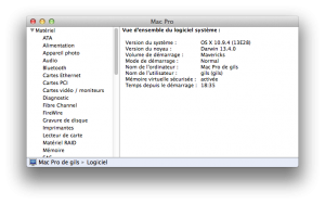

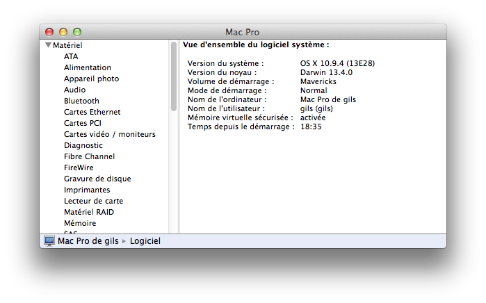

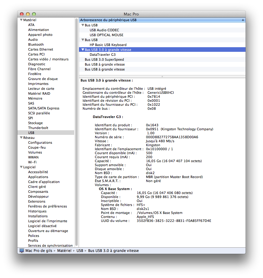

gils83 Posted March 3, 2015 Share Posted March 3, 2015 Hi ! Try kernel 10.9.5 and boot and sound ! Also have "opcode error" or no )) If problem sound - this i think this other problem , maybe tsc or ssse3 )) In archive two files - boot and kernel . mach_10.9.5_bronya_rc2.zip slleep work usb3 work 2 Link to comment https://www.insanelymac.com/forum/topic/281450-mavericks-kernel-testing-on-amd-formerly-mountain-lion-kernel-testing-on-amd/page/254/#findComment-2117440 Share on other sites More sharing options...
Bronya Posted March 3, 2015 Share Posted March 3, 2015 Kernel fix ! )) Try ))) mach_10.9.5_bronya_rc3.zip 3 Link to comment https://www.insanelymac.com/forum/topic/281450-mavericks-kernel-testing-on-amd-formerly-mountain-lion-kernel-testing-on-amd/page/254/#findComment-2117503 Share on other sites More sharing options...

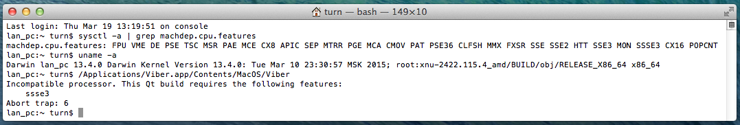

Turntablist Posted March 19, 2015 Share Posted March 19, 2015 AMD Athlon 64 x2 6000+ ASUS M3A78 DDR2 800 3Gb NVIDIA Geforce 8400 GS ESI Juli@ OS X 10.9.5 Everything works great with mach_10.9.5_bronya_rc4 and VoodooTSCSyncAMD.kext. Any chance to run Viber? Link to comment https://www.insanelymac.com/forum/topic/281450-mavericks-kernel-testing-on-amd-formerly-mountain-lion-kernel-testing-on-amd/page/254/#findComment-2121243 Share on other sites More sharing options...

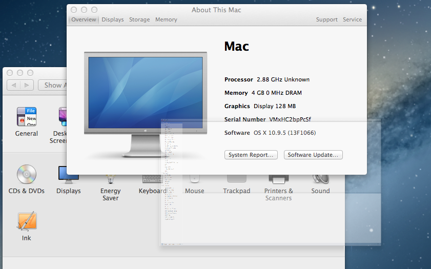

non@me Posted March 21, 2015 Share Posted March 21, 2015 I have the following problem with mach_10.9.5_bronya_rc4 kernel running on Phenom II x4 955 / WMware Workstation: it is impossible to open About This Mac -> System Report. The system hangs for a while and then all applications are relaunched. There were no such problem with some older kernels dated to October-November 2014. Link to comment https://www.insanelymac.com/forum/topic/281450-mavericks-kernel-testing-on-amd-formerly-mountain-lion-kernel-testing-on-amd/page/254/#findComment-2121738 Share on other sites More sharing options...
Bronya Posted March 21, 2015 Share Posted March 21, 2015 I have the following problem with mach_10.9.5_bronya_rc4 kernel running on Phenom II x4 955 / WMware Workstation: it is impossible to open About This Mac -> System Report. The system hangs for a while and then all applications are relaunched. There were no such problem with some older kernels dated to October-November 2014. Hi ! You tried with my boot ? Link to comment https://www.insanelymac.com/forum/topic/281450-mavericks-kernel-testing-on-amd-formerly-mountain-lion-kernel-testing-on-amd/page/254/#findComment-2121930 Share on other sites More sharing options...
non@me Posted March 22, 2015 Share Posted March 22, 2015 Hi ! You tried with my boot ? No, I didn't try to use your boot because WMware has its own built-in loader. Link to comment https://www.insanelymac.com/forum/topic/281450-mavericks-kernel-testing-on-amd-formerly-mountain-lion-kernel-testing-on-amd/page/254/#findComment-2122051 Share on other sites More sharing options...
