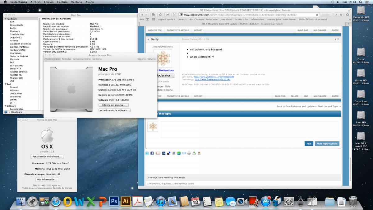

allenwkk Posted June 20, 2012 Share Posted June 20, 2012 for my ASUS P6T SE with GT9800 , I tried update from DP4 to 248 but it said unexpected error... Tried to reinstall DP4 over a Lion partition, then install DP4 again... then install the update to 248... this time it works... need to reinstall -boot loader -AppleHDA -add the Realtek plugin in the IONetworkfamily.kext -got the "cannot log in to Apple store problem" ; need to delete the library/preference/systemconfiguration/network.plist and remove the network interface in preference' reboot ; and then add the network interface again the benefits of all the hard work is that -248 solved the HDD eject after wakeup from sleep problem... now it sleeps and wake up very well. Link to comment https://www.insanelymac.com/forum/topic/279890-os-x-mountain-lion-dp4-update-12a248-180612/#findComment-1827996 Share on other sites More sharing options...
Derty Posted June 20, 2012 Share Posted June 20, 2012 not problem. only hda good, whats is different??? problem, dont return from sleep, disk not wake Link to comment https://www.insanelymac.com/forum/topic/279890-os-x-mountain-lion-dp4-update-12a248-180612/#findComment-1828012 Share on other sites More sharing options...

Derty Posted June 20, 2012 Share Posted June 20, 2012 Where is kernel log? :hammer: sudo dmesg Darwin Kernel Version 12.0.0: Fri Jun 15 18:06:48 PDT 2012; root:xnu-2050.7.2~2/RELEASE_X86_64 vm_page_bootstrap: 2028118 free pages and 52650 wired pages kext submap [0xffffff7f8073e000 - 0xffffff8000000000], kernel text [0xffffff8000200000 - 0xffffff800073e000] zone leak detection enabled standard timeslicing quantum is 10000 us standard background quantum is 2500 us mig_table_max_displ = 74 corecrypto kext started! Running kernel space in FIPS MODE Plist hmac value is 735d392b68241ef173d81097b1c8ce9ba283521626d1c973ac376838c466757d Computed hmac value is 735d392b68241ef173d81097b1c8ce9ba283521626d1c973ac376838c466757d corecrypto.kext FIPS integrity POST test passed! corecrypto.kext FIPS AES CBC POST test passed! corecrypto.kext FIPS TDES CBC POST test passed! corecrypto.kext FIPS SHA POST test passed! corecrypto.kext FIPS HMAC POST test passed! corecrypto.kext FIPS ECDSA POST test passed! corecrypto.kext FIPS DRBG POST test passed! corecrypto.kext FIPS POST passed! AppleACPICPU: ProcessorId=0 LocalApicId=0 Enabled AppleACPICPU: ProcessorId=1 LocalApicId=2 Enabled AppleACPICPU: ProcessorId=2 LocalApicId=4 Enabled AppleACPICPU: ProcessorId=3 LocalApicId=6 Enabled AppleACPICPU: ProcessorId=4 LocalApicId=4 Disabled AppleACPICPU: ProcessorId=5 LocalApicId=5 Disabled AppleACPICPU: ProcessorId=6 LocalApicId=6 Disabled AppleACPICPU: ProcessorId=7 LocalApicId=7 Disabled calling mpo_policy_init for Sandbox Security policy loaded: Seatbelt sandbox policy (Sandbox) calling mpo_policy_init for Quarantine Security policy loaded: Quarantine policy (Quarantine) calling mpo_policy_init for TMSafetyNet Security policy loaded: Safety net for Time Machine (TMSafetyNet) Copyright (c) 1982, 1986, 1989, 1991, 1993 The Regents of the University of California. All rights reserved. MAC Framework successfully initialized using 16384 buffer headers and 10240 cluster IO buffer headers IOAPIC: Version 0x20 Vectors 64:87 ACPI: System State [s0 S3 S4 S5] (S3) PFM64 (36 cpu) 0xf10000000, 0xf0000000 [ PCI configuration begin ] console relocated to 0xf1d000000 PCI configuration changed (bridge=4 device=3 cardbus=0) [ PCI configuration end, bridges 8 devices 29 ] AppleIntelCPUPowerManagement: Turbo Ratios 1144 AppleIntelCPUPowerManagement: (built 18:20:33 Jun 15 2012) initialization complete RTC: Only single RAM bank (128 bytes) HWSensors Project v1.0.8 Copyright 2012 netkas, slice, usr-sse2, kozlek, navi, THe KiNG. All rights reserved. FakeSMCDevice: 23 preconfigured key(s) added SMC: successfully initialized IntelThermal: CPU family 0x6, model 0x1e, stepping 0x5, cores 4, threads 4, TJmax 99 SuperIODevice: found ITE IT8720F on port=0x2e address=0x290 mbinit: done [96 MB total pool size, (64/32) split] Pthread support ABORTS when sync kernel primitives misused IT87xMonitor: started FireWire runtime power conservation disabled. (2) com.apple.AppleFSCompressionTypeDataless kmod start rooting via boot-uuid from /chosen: 7EEA7E9A-BE39-3F7B-A276-C736CD4B1822 Waiting on <dict ID="0"><key>IOProviderClass</key><string ID="1">IOResources</string><key>IOResourceMatch</key><string ID="2">boot-uuid-media</string></dict> com.apple.AppleFSCompressionTypeZlib kmod start com.apple.AppleFSCompressionTypeDataless load succeeded com.apple.AppleFSCompressionTypeZlib load succeeded AppleIntelCPUPowerManagementClient: ready identified as RTL8168D/8111D identified as RTL8168D/8111D FireWire (OHCI) TI ID 8024 PCI now active, GUID 007b38ff0000241d; max speed s400. Got boot device = IOService:/AppleACPIPlatformExpert/PCI0/AppleACPIPCI/SATA@1F,2/AppleIntelPchSeriesAHCI/PRT4@4/IOAHCIDevice@0/AppleAHCIDiskDriver/IOAHCIBlockStorageDevice/IOBlockStorageDriver/WDC WD15EADS-00P8B0 Media/IOGUIDPartitionScheme/Sin t\M-C\M--tulo 1@2 BSD root: disk2s2, major 1, minor 10 jnl: unknown-dev: replay_journal: from: 29900288 to: 33232896 (joffset 0xe91000) Kext com.roxio.BluRaySupport - library kext com.apple.kernel.iokit not found. Can't load kext com.roxio.BluRaySupport - failed to resolve library dependencies. Kext com.roxio.BluRaySupport failed to load (0xdc00800e). Failed to load kext com.roxio.BluRaySupport (error 0xdc00800e). Couldn't alloc class "com_roxio_bluraysupport" USBMSC Identifier (non-unique): SH13TPL02997 0xbb4 0xff9 0x226 jnl: unknown-dev: journal replay done. Kernel is LP64 hfs: Removed 9 orphaned / unlinked files and 72 directories jnl: disk0s2: replay_journal: from: 23390208 to: 24659456 (joffset 0xa2a000) jnl: disk0s2: journal replay done. Waiting for DSMOS... macx_swapon SUCCESS jnl: disk0s4: replay_journal: from: 23265280 to: 24262656 (joffset 0x12f4000) jnl: disk0s4: journal replay done. Previous Shutdown Cause: 3 jnl: disk3s2: replay_journal: from: 56147968 to: 57221120 (joffset 0x138a000) jnl: disk3s2: journal replay done. jnl: disk3s3: replay_journal: from: 19664896 to: 19920384 (joffset 0x998000) NVDAGF100HAL loaded and registered. [AGPM Controller] unknownPlatform jnl: disk3s3: journal replay done. jnl: disk3s4: replay_journal: from: 53821952 to: 54159360 (joffset 0x1d19000) jnl: disk2s3: replay_journal: from: 48229888 to: 50025984 (joffset 0x1d1b000) jnl: disk3s4: journal replay done. DSMOS has arrived [iOBluetoothHCIController][start] -- completed NTFS driver 3.10 [Flags: R/W]. NTFS volume name Reservado para el sistema, version 3.1. NTFS volume name , version 3.1. com_chucko_RealtekR1000: Ethernet address 00:24:1d:c0:8f:2b com_chucko_RealtekR1000: Ethernet address 00:24:1d:c0:8f:29 jnl: disk2s3: journal replay done. Link to comment https://www.insanelymac.com/forum/topic/279890-os-x-mountain-lion-dp4-update-12a248-180612/#findComment-1828117 Share on other sites More sharing options...
