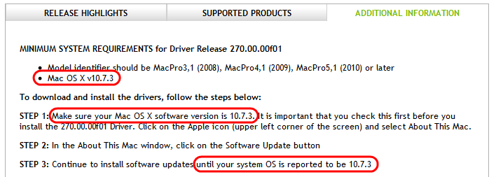

nvidia released some lion (10.7.3) / macpro drivers today.
driver version is a bit older than the current 10.7.3 drivers (7.10.2 vs 7.18.11).
changes:
  • device id / Info.plist editing isn't necessary any more, since NVDAGF100Hal.kext uses the same "match all vga devices" method as the mountain lion kext.
  • opencl works ootb for gf100/gf110 cards (all others still need to patch GeForceGLDriver and libclh.dylib)
  • ATY_Init isn't required on mac pros any more
http://www.nvidia.com/object/macosx-270.00.00f01-driver.html
