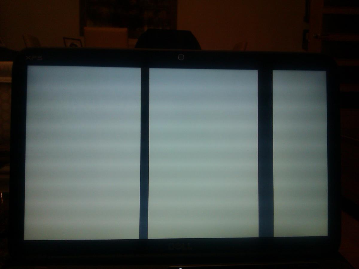

jnxjn Posted February 7, 2012 Share Posted February 7, 2012 After the install, i put the DSDT in the extras folder (HD screen not full HD) through macdrive in windows. The screen is really weird looking with a whole bunch of random lines, but there's sound so I know I'm in the setup part. However, i can boot into safe mode fine and the screen is okay, but i have all the kexts and the packages in a usb, and whenever i plug in the usb, I get a kernel panic immediately. What could i have done wrong in the process? Specs: 720p screen 8gb ram 2gb gt540 graphics i7-2670QM @ 2.20GHz (yes for the busratio flag i did busratio=22 not 20) A06 bios Yea so basically my only problems so far is the kernel panic with the usb plugged in, and the native screen not working. It's the whole screen that looks messed up Thanks for any input! Link to comment https://www.insanelymac.com/forum/topic/272645-guide-installing-lion-on-sandy-bridge-dell-xps-l502x/page/2/#findComment-1793729 Share on other sites More sharing options...
calreyru1978 Posted February 7, 2012 Share Posted February 7, 2012 @jnxjn: I have the same problems as you. The one about de usb can be solve pluging the usb just after you boot with Bootle (while you see the screen full of letters). After MACos is loaded you can use the USB. About the problem with the DSDT some one called Alex DeWolf had the same problem and it was solved by DoiX this way: 11 January 2012 - 09:36 PM DoiX, on 11 January 2012 - 02:48 AM, said: Well, the only thing i can think of is that you are using the FULL HD DSDT instead of the normal one... http://dl.dropbox.com/u/16173714/DSDT-HD.aml.zip copy it to extra and add to org.chameleon.boot.plist <key>DSDT</key> <string>/Extra/DSDT.aml</string> I have not still try it in my laptop, but if make it work let me know. Bye. Link to comment https://www.insanelymac.com/forum/topic/272645-guide-installing-lion-on-sandy-bridge-dell-xps-l502x/page/2/#findComment-1793775 Share on other sites More sharing options...
AKennedy_4 Posted February 7, 2012 Author Share Posted February 7, 2012 calreyru1978 is right to an extent. Make sure your using the right DSDT and its put in the extra folder. This will solve the USB drive problem and screen all in one. Now to make sure you have the DSDT loaded, boot with RBootLE and enter these boot flags (Change the bus ratio value to your own as specified in the guide): -v GraphicsEnabler=No cpus=1 busratio=20 DSDT=/Extra/DSDT.aml You should boot with native resolution now What calreyru1978 mentioned above is easier to be done through the installation of DoiX's package, but has the same results if you choose that route Link to comment https://www.insanelymac.com/forum/topic/272645-guide-installing-lion-on-sandy-bridge-dell-xps-l502x/page/2/#findComment-1793854 Share on other sites More sharing options...
jnxjn Posted February 8, 2012 Share Posted February 8, 2012 I managed to boot with the DSDT=/Extra/DSDT.aml flag. Now my problem is booting up without the cd. I used DoiX's package and installed what the guide said to install, edited and replaced the boot.plist as the guide says, deleted the nullcpu kext and I'm still not able to boot without the cd. Anyway, I then boot with the cd, and manage to install [url="http://www.insanelymac.com/forum/topic/279450-why-insanelymac-does-not-support-tonymacx86/"]#####[/url] and all of the options it tells me to select. The bootloader is v1.7 from the new [url="http://www.insanelymac.com/forum/topic/279450-why-insanelymac-does-not-support-tonymacx86/"]#####[/url]. Now, i reboot and get a kernel panic. The "please hold power button to restart" screen is blocking some words, but i managed to catch a few letters consisting of achi (not in that order) and an audio family thing too. Any suggestions what might be wrong? Btw I'm still on 10.7.1 so I didn't do the part where it says to change to the 10.7.2 AICPUPM, and didn't install the combo update. While in osx though, I faced a minor problem. The sound works but there is some weird white noise coming from the speakers. Also while booting up, there is a popping noise too then after that the speakers start to make the white noise. Any way to fix that or do I have to live with it? Thanks again! Link to comment https://www.insanelymac.com/forum/topic/272645-guide-installing-lion-on-sandy-bridge-dell-xps-l502x/page/2/#findComment-1794060 Share on other sites More sharing options...

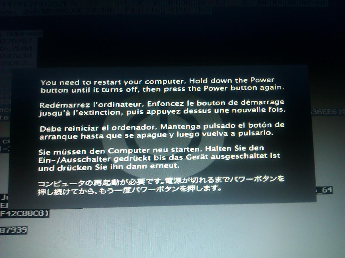

calreyru1978 Posted February 8, 2012 Share Posted February 8, 2012 Hello egain. I think we (jnxjn) and me have the same problems. I have reinstall osx and folow 100% the guide (using the HD DSDT (the one I need) suggested in the topic). The result has been the same blank screen (see the screen shot). I have also installed the FULL HD DSDT, just in case, and i was not able to rebootLE my osx. I have reinstalled once more osx and try the DSDT from here http://dl.dropbox.co...DSDT-HD.aml.zip, and I have been able to restart osx, but not to reboot without bootLE. I'm almost sure that the problem is the DSDT. I don't know else can I do.... Link to comment https://www.insanelymac.com/forum/topic/272645-guide-installing-lion-on-sandy-bridge-dell-xps-l502x/page/2/#findComment-1794080 Share on other sites More sharing options...

AKennedy_4 Posted February 8, 2012 Author Share Posted February 8, 2012 If graphics are workin and USB 2.0 ports are working the DSDT isn't your problem. The system isn't booting because you misinstalled the kext. Try reinstalling through the pack I providied Link to comment https://www.insanelymac.com/forum/topic/272645-guide-installing-lion-on-sandy-bridge-dell-xps-l502x/page/2/#findComment-1794129 Share on other sites More sharing options...

calreyru1978 Posted February 8, 2012 Share Posted February 8, 2012 When do you edit the SMbios?? After or before installing the Kext? I can not be missintalling the kext because just after finishing the instalation and before installing the kext if I copy the HD DSDT to extra an I reboot I can not rebootle (blank screen). I'll try SMbios edition and I'll tell you. Thanks in advance. Link to comment https://www.insanelymac.com/forum/topic/272645-guide-installing-lion-on-sandy-bridge-dell-xps-l502x/page/2/#findComment-1794192 Share on other sites More sharing options...
calreyru1978 Posted February 8, 2012 Share Posted February 8, 2012 Editing SMBios did not work..... No more than the same kermel panic when rebooting wihtout bootLE Some more idea about it?? Thanks Link to comment https://www.insanelymac.com/forum/topic/272645-guide-installing-lion-on-sandy-bridge-dell-xps-l502x/page/2/#findComment-1794333 Share on other sites More sharing options...
AKennedy_4 Posted February 9, 2012 Author Share Posted February 9, 2012 That because your entire issue has to do with installing the Kext. You need to install the Kext from my pack (Zip file), using Kext Wizard. After install run kext utility and disk utility. This should correct that problem. As for the screen issue, you are right, that should be a Smbios issue. I think it can also be solved by deleting SNBIntelGraphics.kext or something like that. But I think NotMeAgain documented this Link to comment https://www.insanelymac.com/forum/topic/272645-guide-installing-lion-on-sandy-bridge-dell-xps-l502x/page/2/#findComment-1794342 Share on other sites More sharing options...
jnxjn Posted February 9, 2012 Share Posted February 9, 2012 Ok so I deleted voodooHDA and I don't get that sound anymore. Then i installed DoiX's v6 package. I can finally boot up fine, finally get native resolution and all, but only problem is that there is no sound but I'll try fixing that tomorrow when i have time. What i plan to do is delete the audio kexts installed by the packager (AppleHDA and the ALC one? correct me if I'm wrong) and then installing the kexts provided from your pack. If that doesn't work I'll stick with voodoo hda. Btw I think it's a kext install issue as there is like a circle and a line in the middle of it when i try to adjust the sound. And i still get the error (system extension cannot be used) for applehda, dellxpsalc) One problem I couldn't figure out though, is the battery meter. It shows a battery with an x in the middle. Other than that, everything is working flawlessly, except for wifi but I'm going to order the dw1510 soon. I had the apple branded bcm94321mc from my other hackintosh laptop, only problem is that the xps came with only 1 antenna cable, so only 1 card would hook up. Quick couple of questions tho, 1) compared to the dw1510 how is the performance of the apple branded 94321mc? 2) will it work in windows 7? Sorry for the long post but thanks! EDIT: i tried putting it to sleep and all it does is the screen goes black and i can hear the fans actually run a bit faster. It also won't wake up. I thought sleep works, or do i need a sleepenabler.kext? Also, I am on A06 bios And when i turn off or reboot osx, it doesn't shut down. It stays as a black screen and the only way to turn it off is by holding the power button Link to comment https://www.insanelymac.com/forum/topic/272645-guide-installing-lion-on-sandy-bridge-dell-xps-l502x/page/2/#findComment-1794380 Share on other sites More sharing options...
calreyru1978 Posted February 9, 2012 Share Posted February 9, 2012 @'jnxjn' Was your blank screen the same a mine?? (in order to solve the same way as you) @NotMeAgain Is there something else left that I have to do to make osx run. I have done what you said, and always get the same kernel panic. @AKennedy_4 I have installed DoiX's v6 package + kext utility + disk utility + reboot = kernel panic. your packege + kext utility + disk utility + reboot = kernel panic. DoiX's v5 package + kext utility + disk utility + reboot = kernel panic. @You all The only differences in my instalation are. 1) Just before the DVD finished installing Lion, the system ask me to plug a keyboard to go on. I do it, I pass that screen and I can go on without the keyboard. 2) After the configuration (name, hour, etc....) I rebootLE typing -v GrahpicsEnabler=no busratio=22 cpus=1 and I can run OSX without any DSDT (I mean graphics works) . The problems came after that if I copy (in win7) the DSDT, install Kext. May it be something about the Lion version I've installed (I think mine is 10.7.1, I do not have my laptop in here)? Thanks in advance Link to comment https://www.insanelymac.com/forum/topic/272645-guide-installing-lion-on-sandy-bridge-dell-xps-l502x/page/2/#findComment-1794411 Share on other sites More sharing options...
