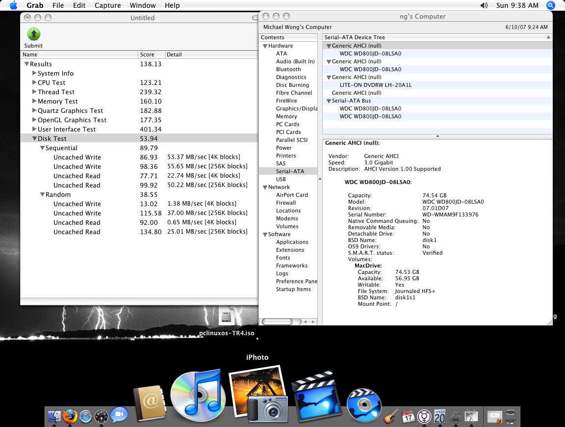

mjaleo Posted June 8, 2007 Share Posted June 8, 2007 I've re-read this thread twice now and still cannot get the damn hard drive to run faster. My Xbench scores are terrible for the HD. I tried plugging it into the purple SATA port, setting the BIOS settings you guys talked about, but I get "BOOT MGR IS MISSING, CTRL + ALT + DEL TO RESTART" I dunno Results 45.12 System Info Xbench Version 1.3 System Version 10.4.8 (8L2127) Physical RAM 2048 MB Model ADP2,1 Drive Type WDC WD2500JS-60NCB1 CPU Test 104.50 GCD Loop 237.28 12.51 Mops/sec Floating Point Basic 114.21 2.71 Gflop/sec vecLib FFT 84.12 2.78 Gflop/sec Floating Point Library 74.53 12.98 Mops/sec Thread Test 198.61 Computation 181.22 3.67 Mops/sec, 4 threads Lock Contention 219.70 9.45 Mlocks/sec, 4 threads Memory Test 138.65 System 119.56 Allocate 114.57 420.74 Kalloc/sec Fill 130.90 6364.80 MB/sec Copy 114.63 2367.60 MB/sec Stream 164.99 Copy 153.30 3166.41 MB/sec Scale 152.24 3145.26 MB/sec Add 181.01 3855.80 MB/sec Triad 177.71 3801.70 MB/sec Quartz Graphics Test 149.39 Line 121.68 8.10 Klines/sec [50% alpha] Rectangle 153.26 45.75 Krects/sec [50% alpha] Circle 147.76 12.04 Kcircles/sec [50% alpha] Bezier 133.63 3.37 Kbeziers/sec [50% alpha] Text 223.43 13.98 Kchars/sec OpenGL Graphics Test 147.52 Spinning Squares 147.52 187.14 frames/sec User Interface Test 370.93 Elements 370.93 1.70 Krefresh/sec Disk Test 8.54 Sequential 5.98 Uncached Write 4.95 3.04 MB/sec [4K blocks] Uncached Write 5.20 2.94 MB/sec [256K blocks] Uncached Read 9.63 2.82 MB/sec [4K blocks] Uncached Read 5.84 2.94 MB/sec [256K blocks] Random 14.94 Uncached Write 12.79 1.35 MB/sec [4K blocks] Uncached Write 9.19 2.94 MB/sec [256K blocks] Uncached Read 70.62 0.50 MB/sec [4K blocks] Uncached Read 15.00 2.78 MB/sec [256K blocks] Link to comment Share on other sites More sharing options...

yoursagentsmith Posted June 12, 2007 Share Posted June 12, 2007 mjaleo, where is the test program you used to check hd transfer rate? My system seems fast but I'd like to check it too Link to comment Share on other sites More sharing options...
foxboroman Posted June 14, 2007 Share Posted June 14, 2007 mjaleo, where is the test program you used to check hd transfer rate? My system seems fast but I'd like to check it too :pirate2: He used "XBench".... You will need to download it from the link below. http://www.xbench.com/ Please post your results here. :pirate2: Link to comment Share on other sites More sharing options...
foxboroman Posted June 14, 2007 Share Posted June 14, 2007 I've read nearly every thread on the site, tried most of it... If someone could help me with the post I made above I would appreciate it. Been trying for a while to get this working. I had the same error. What solved my problem was booting off the XP disk and deleting both partitions. Set bios settings (SATA native, IDE). Reboot on osX86 disk. I used Jas 10.4.8 (sourced from tbp). Used disk utility, erase 4 times and erased free space. Installed osX86. Booted, patched kext file to get the drives in AHCI mode, instructions are on this site. Set bios to AHCI on both. Rebooted. Installed sound driver. I am happy with speed. :censored2: Everything you need can be found on this site, except the iso torrent file. Link to sound driver. sound driver What else can you do? Install "Parallels" this will allow you to install XP, Vista, and Linux..... Very cool. Here are some screen shots of Parallels. installed_starting_updates.tiff parallels_for_u.tiff The sad truth is that it is easier to install XP in Parallels and the 91 update and the ensuing reboots are less painful; because you can browse in osX86 while the virtual machine reboots. Speed is not bad. I am using a E6600 and everything is snappy..... It is as fast as an AMD 3000 or better <purely subjective opinion, no benchmark to support> Link to comment Share on other sites More sharing options...
