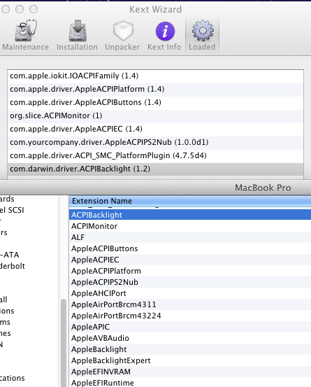

Hi hotKoffy
After wakeup from sleep, sometimes I can't adjust brightness. The brightness value changes in IOReg, but the brightness don't change.
BTW, I'm using 10.7.2
Edit:
When brightness adjusting is OK, your kext shows in the Kext Wizard and System Information
When brightness adjusting is lost as I described before, your kext only shows in the Kext Wizard.
Just a helpful hint ...

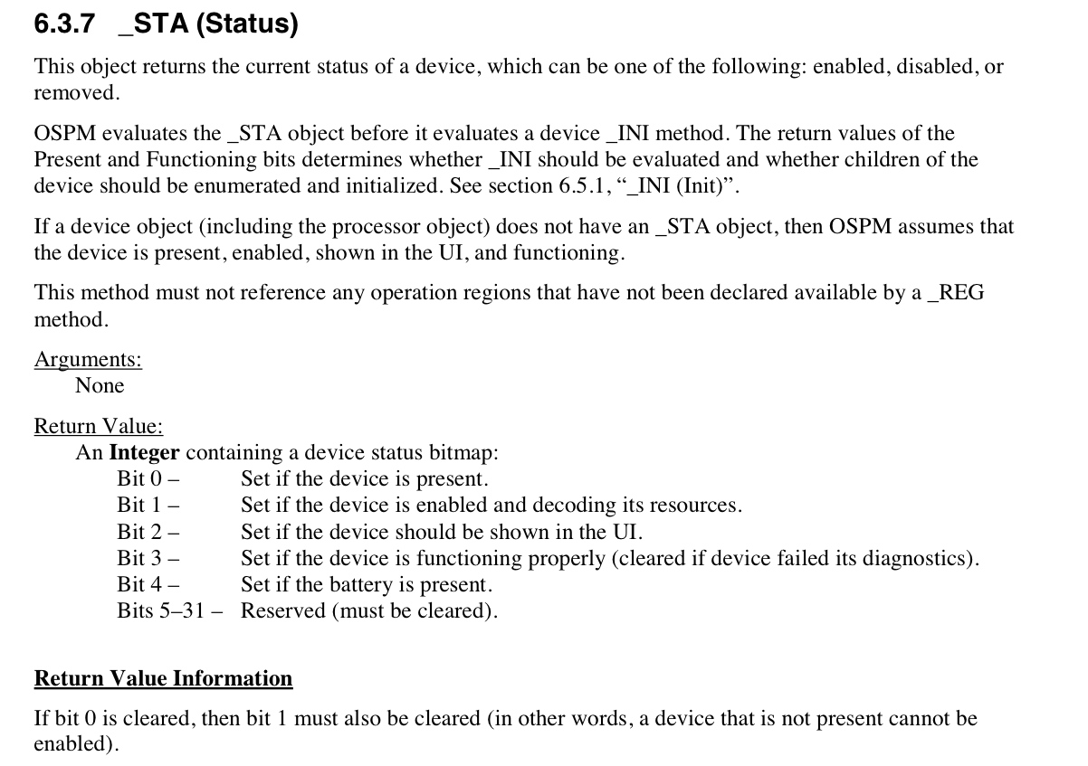

You should check your dsdt battery _STA
And ask 'gsly' for the sources.
On the original driver _STA is used for battery state.
