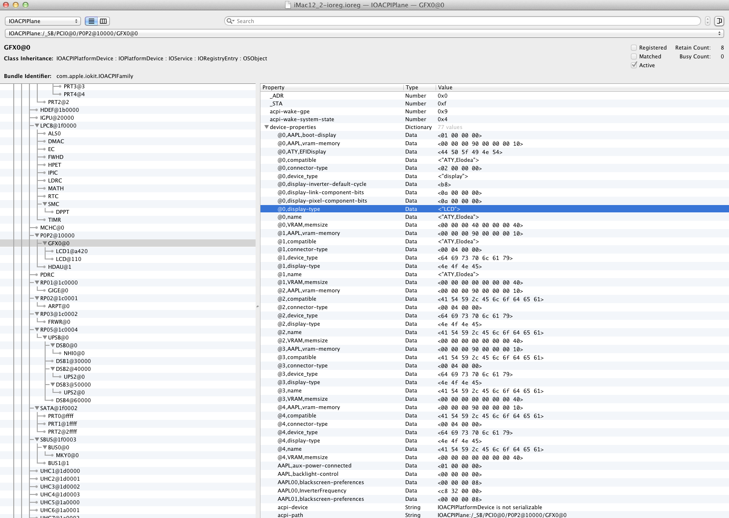

Looking into imac 12.2 properties is interesting:
try injecting display type
Edit:
Cyrus the Great use this for his ATI 4850
"@0,display-type",
Buffer (0x05)
"LVDS"
Try LVDS or LCD

That did not work. i've tried that several times, but the system seemed to omit the setting and insisted on using "CRT". :(
the os get display type from framebuffer personality may be you must patch the framebuffer that using for your card .
this is mucha guide about modding framebuffer personality:
http://www.insanelymac.com/forum/index.php?showtopic=252061

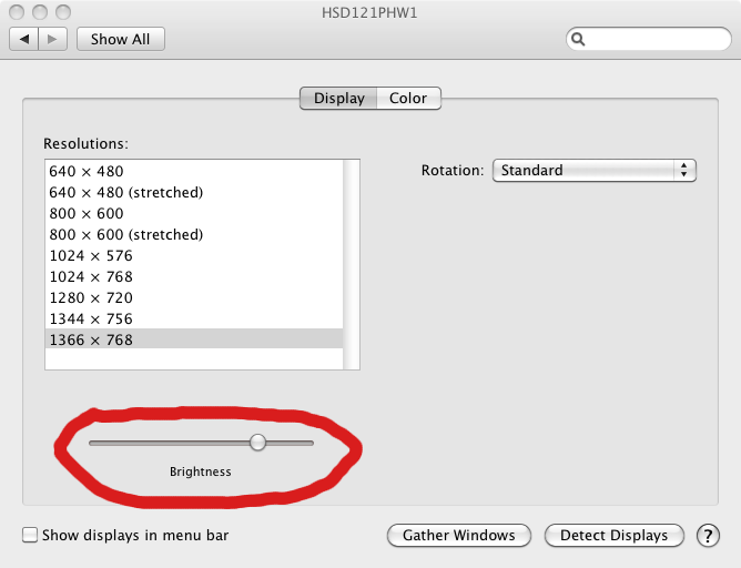

For me the kext provided super smooth brightness control via the slider but no Fn key control.
How ever with the newer version the brightness value does not remain fixed with newer boots and the laptop boots with maximum brightness with every boot.
With the previous release pf ACPI Backlight Driver the brightness level remained fixed once set,and did not change to max with the next boot.
What changed?

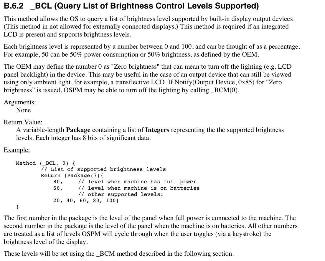

I've finish to followed ACPI specification:
When the driver initialize, it get the current brightness and look if the AC adapter is plugged.
If the PC is on AC, it took the max between the current value and the first entry in _BCL
If the PC is on Battery, it took the min between the current value and the second entry in _BCL.
So if you wants to change the behaviour for your laptop, edit in your DSDT the package returned by _BCL:
First entry : a minimum value if you are on AC (didn't need to save power)
Second entry : a max auto value if you are on battery.
If you don't like this behaviour and want to get the old one, put the min of the values of _BCL in the first entry and the max in the second.

Hi hotKoffy, I download the v1.1 backlight driver, and works well around. But the problem as describe before, I have ten steps of brightness control, and use the slider to adjust the level to 9, close the display preference. When i reopen it, it jump to max level, the IO also shows nine. Here is my brightness control code and some screenshots:
Method (_BCL, 0, NotSerialized)
					Return (Package (0x0D)
						0x5A,
						0x28,
						Zero,
						0x0A,
						0x14,
						0x1E,
						0x28,
						0x32,
						0x3C,
						0x46,
						0x50,
						0x5A,
						0x64
				Method (_BCM, 1, NotSerialized)
					Divide (Arg0, 0x0A, Local0, Local1)
					Store (Local1, ^^^LPCB.EC.BRTS)
				Method (_BQC, 0, NotSerialized)
					Multiply (^^^LPCB.EC.BRTS, 0x0A, Local0)
					Return (Local0)

Seems that your DSDT returns the index in _BCL instead of the value itself. I've see some checks about this in Linux drivers but I've not coded this (this is a DSDT bug).
try this:
Store (Arg0, ^^^LPCB.EC.BRTS)
Return (^^^LPCB.EC.BRTS)
You can also extend the table between Zero and 0x64 (100% of PWM), it will gives smooth transitions during brightness level change.

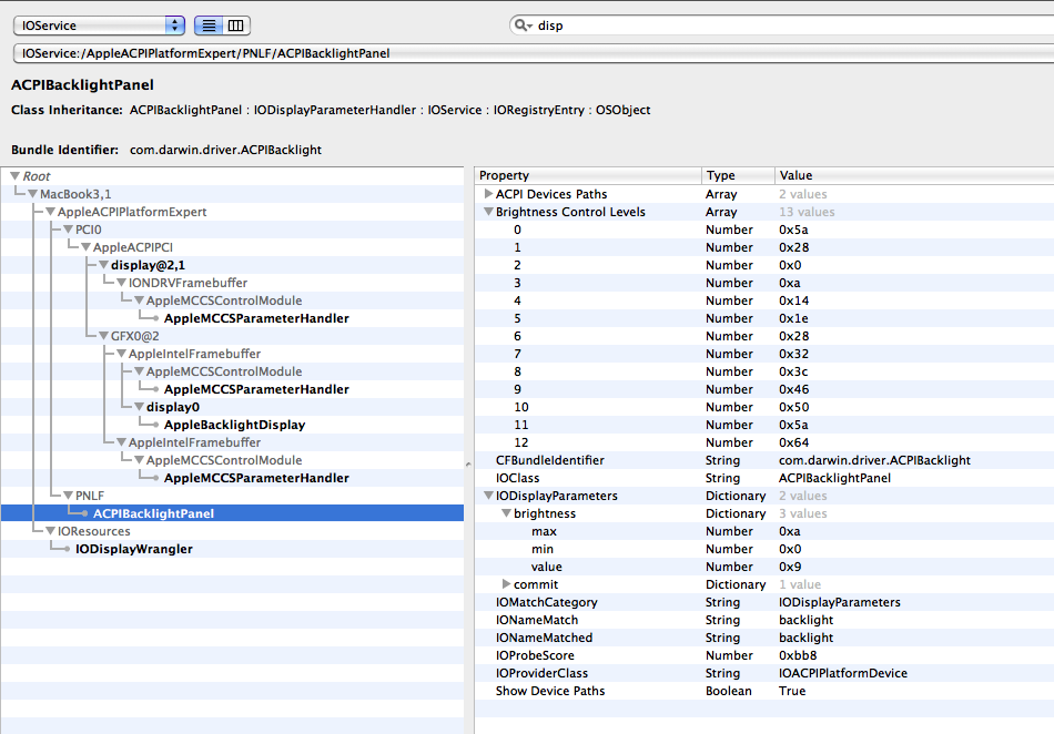

Hello, I added the values to my dsdt (GFX0) and your kext loads and I have slider in preference pane and hotkeys work(I see the sun bezel) but the brightness does not change at all.
Oct 13 13:44:07 Jamezelles-Mac-Pro kernel[0]: ACPIBacklightPanel: Found Backlight Device: LCDD
Oct 13 13:44:07 Jamezelles-Mac-Pro kernel[0]: ACPIBacklightPanel: ACPI Method _DOS found. Device path: _SB.PCI0.PEG1.GFX0
Oct 13 13:44:07 Jamezelles-Mac-Pro kernel[0]: ACPIBacklightPanel: ACPI Methods _BCL _BCM _BQC found. Device path: _SB.PCI0.PEG1.GFX0.LCDD
Oct 13 13:44:07 Jamezelles-Mac-Pro kernel[0]: ACPIBacklightPanel: Version 1.0
I attached my ioreg dump and dsdt, any help is appreciated.

This is a driver for laptops which backlight are controlled by ACPI Methods: if you have _DOS _BCL _BCM _BQC in you DSDT.
This driver provides native backlight management for laptops with backlight managed by ACPI : slider in the display pref pane and sun bezel when you press backlight up/down hotkey (with an other driver than can understand

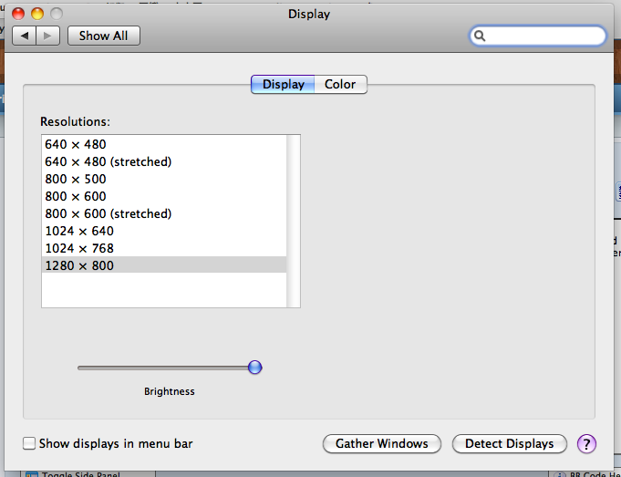

However, when I put the slider on the lowest setting in System Preferences, the brightness of the screen stays on max.
Any ideas?

'mathq' you forgot about this code in your DSDT:
						"AAPL,HasPanel",
					Buffer (0x04)
						0x01, 0x00, 0x00, 0x00
					"AAPL,Haslid",
					Buffer (0x04)
					"AAPL,backlight-control",
					Buffer (0x04)
					"@0,backlight-control",
					Buffer (0x04)
			"@0,AAPL,boot-display",
					Buffer (0x04)
		"@0,built-in",
					Buffer ()
						One

Oct 14 15:41:57 localhost kernel[0]: ACPIBacklightPanel: LCDD _BCL 13
Oct 14 15:41:57 localhost kernel[0]: ACPIBacklightPanel: getIndexForLevel(36) is 3
Oct 14 15:41:57 localhost kernel[0]: ACPIBacklightPanel: getIndexForLevel(72) is 7
Oct 14 15:41:57 localhost kernel[0]: ACPIBacklightPanel::queryACPICurentBrightnessLevel()
Oct 14 15:41:57 localhost kernel[0]: ACPIBacklightPanel: queryACPICurentBrightnessLevel _BQC = 8
Oct 14 15:41:57 localhost kernel[0]: ACPIBacklightPanel: getIndexForLevel(8) not found !
Oct 14 15:41:57 localhost kernel[0]: ACPIBacklightPanel: getBatteryDevice() matching not null
Oct 14 15:41:57 localhost kernel[0]: ACPIBacklightPanel: min = 0, max = 10, value = 3

_BQC is returning an out of range 650 value. (not responsible of KP)
If (IGDS)
Return (QBQC ())
Else
Return (Divide (Multiply (QBQC (), 0xFF), 0x64, ))
It is possible that IGDS is setup by BIOS. There is a lot of tests about it in the DSDT.
