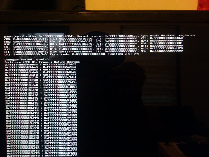

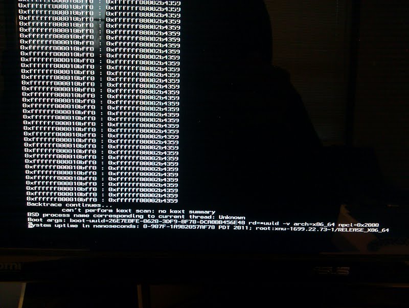

I keep getting this screen when I boot up the computer. Why?
Specs:
Mobo: EVGA nForce 780i
CPU: Core 2 Extreme
RAM: 8 Gigs
Video Cards: x2 Nvidia Geforce 9800 GTX+
