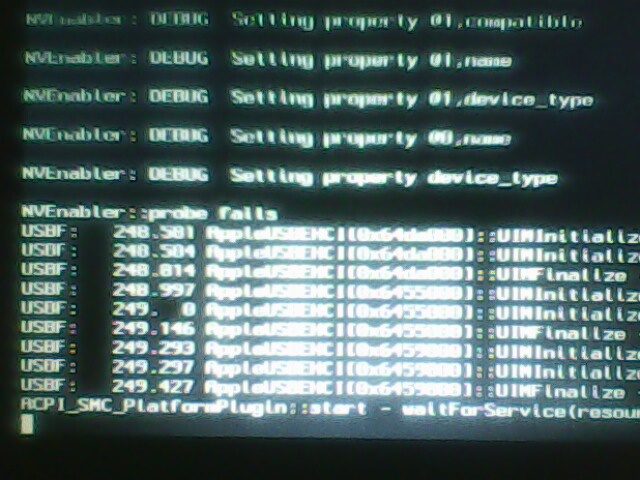

I’m having some video card related problems. Currently the only way I can boot into Lion 10.7.2 is if I remove my 2nd video card. If I keep both video cards in my system all I get is a grey screen instead of a desktop. If I boot with just one video card then my system is fine. Before I updated to 10.7.2 I was using an EFI string for just my 1st video card and Lion 10.7 was fine because it didn’t even know I had a 2nd video card installed. Now with 10.7.2 the EFI string is no longer working. I could not boot with it. I now have to use GraphicsEnabler=Yes but with it I am getting a grey screen at boot. Does anyone one have any ideas on how to get this working. When I had 10.6.7 installed GraphicsEnabler=Yes worked without any problems. Snow Leopard saw I had two video cards and booted fine. With 10.6.8 and up I had to use the single card EFI string otherwise my system would get stuck with a grey screen in Lion 10.7 and a blue screen in Snow Leopard 10.6.8.
Have you tried NVEnabler 64, which is what I use with OS X 10.7.2.........?
I did. Same affect as if I use GraphicsEnabler=Yes.
You may have to modify the NVCAP data string, assuming that you already have the device IDs in the appropriate nVidia graphics kexts.....
EDIT: If NVEnabler 64 does not work, then try what mohamed khairy says worked for him......he edited chameleon nvidia.c by renaming parent to child......by modifying line 81 as follows:

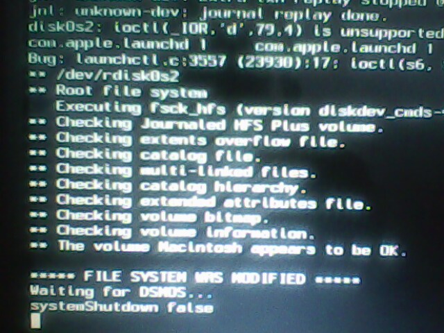

Hi verdant, I try to install iATKOS L2 (Mac OS X Lion 10.7.2) on my Desktop PC. When the DVD Boots I always get "Still waiting for root device..." message :worried_anim: . These are my details PC's spec:
Model : Acer ASPIRE M1800.
MoBo : nVIDIA nForce 7100-620i (HW Profiler on Mac said; nForce 630i).
CPU : DualCore Intel Pentium E5200, 2500 MHz (12.5 x 200).
RAM : 2 GB (2x1 GB Visipro DDR2/SDRAM).
VGA : onBoard NVIDIA GeForce 7050 / NVIDIA nForce 620i (256 MB).
Disk (for OSX) : SAMSUNG PATA @30 GB (Primary Slave), LG PATA DVD-ROM (Primary Master), SATA Disks were unplugged.
Others : nForce Ethernet (Disabled via BIOS Option), VIA FireWire, ALC888 OnBoard SoundCard, CardReader, USB Mouse & Keyboard.
Misc. : No AHCI Option on BIOS, No HPET or VT.
By using CDBoot Intel NVEnabler I've successfully installed iATKOS S3 v2 on my 30 GB PATA HDD, but it won't boot after restarted anymore. Now, I wanna try to install OS X Lion; is my PC supported for this amazing OS...? :wink2:
Any suggestion, plz..!? This my mail: asyifa13@gmail.com
Thanks & I apologize for my bad English. (I'm Indonesian, :king: )

Your nForce 620i/630i chipset MOBO should probably be fully AHCI compliant, meaning that you cannot use an AppleNForceATA.kext...........however, Aspire M series desktops such as M3641, M5641 have the problem of a "locked feature" BIOS..........the same may be true of the M1800........
But before giving up, see these two topics:
