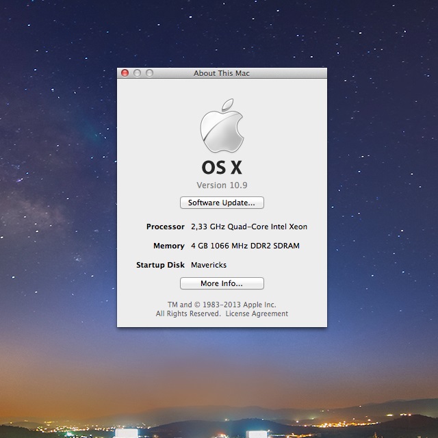

xopher Posted June 24, 2013 Share Posted June 24, 2013 Okay, so I installed Mavericks - just to see if it works, and how well it works. Successfully I might add. I followed this guide: http://www.insanelymac.com/forum/topic/289062-109-mavericks-simple-vanilla-hackintosh-install-guide/ I have the latest Chameleon (2.2 r2251) kozleks FakeSMC and HWSensors https://bitbucket.org/kozlek/hwsensors/downloads lnx2mac's driver for ethernet http://lnx2mac.blogspot.fi/p/realtekrtl81xx-osx-driver.html and these kexts for audio: https://www.dropbox.com/s/1fox4hfgiy87nsx/EP45-UD3R-ALC889a.zip Everything seems to be running just fine, but I'm sure there's something missing or in need of tweaking. Where's the fun otherwise This is my bdmesg: Chameleon 2.2svn (svn-r2251) [2013-06-23 23:03:56] msr(454): ia32_perf_stat 0x06000825 max: 8 current: 8 CPU: Brand String: Intel(R) Core(TM)2 Quad CPU Q8400 @ 2.66GHz CPU: Vendor/Family/ExtFamily: 0x756e6547/0x6/0x0 CPU: Model/ExtModel/Stepping: 0x17/0x1/0xa CPU: MaxCoef/CurrCoef: 0x8/0x8 CPU: MaxDiv/CurrDiv: 0x0/0x0 CPU: TSCFreq: 3200MHz CPU: FSBFreq: 400MHz CPU: CPUFreq: 3200MHz CPU: NoCores/NoThreads: 4/4 CPU: Features: 0x0000025f Attempting to read GPT Read GPT Reading GPT partition 1, type C12A7328-F81F-11D2-BA4B-00A0C93EC93B Reading GPT partition 2, type 48465300-0000-11AA-AA11-00306543ECAC Read HFS+ file: [hd(0,2)/System/Library/CoreServices/SystemVersion.plist] 478 bytes. Read HFS+ file: [hd(0,2)/Extra/org.chameleon.Boot.plist] 588 bytes. Attempting to read GPT Read GPT Reading GPT partition 1, type C12A7328-F81F-11D2-BA4B-00A0C93EC93B Reading GPT partition 2, type 48465300-0000-11AA-AA11-00306543ECAC Attempting to read GPT Read GPT Reading GPT partition 1, type C12A7328-F81F-11D2-BA4B-00A0C93EC93B Reading GPT partition 2, type 48465300-0000-11AA-AA11-00306543ECAC Reading GPT partition 3, type EBD0A0A2-B9E5-4433-87C0-68B6B72699C7 Read HFS+ file: [hd(2,2)/System/Library/CoreServices/SystemVersion.plist] 476 bytes. Attempting to read GPT Read GPT Reading GPT partition 1, type C12A7328-F81F-11D2-BA4B-00A0C93EC93B Reading GPT partition 2, type 48465300-0000-11AA-AA11-00306543ECAC Read HFS+ file: [hd(3,2)/System/Library/CoreServices/SystemVersion.plist] 476 bytes. Module 'Symbols.dylib' by 'Chameleon' Loaded. Description: Chameleon symbols for linking Version: 0 Compat: 0 Read HFS+ file: [hd(0,2)/Extra/modules/FileNVRAM.dylib] 56068 bytes. Module 'FileNVRAM.dylib' by 'Unknown' Loaded. Description: Version: 0 Compat: 0 Read HFS+ file: [hd(0,2)/Extra/modules/Keylayout.dylib] 13464 bytes. Module 'Keylayout.dylib' by 'Unknown' Loaded. Description: Version: 0 Compat: 0 Read HFS+ file: [hd(0,2)/Extra/Keymaps/mac-se.lyt] 464 bytes. Read HFS+ file: [hd(0,2)/Extra/modules/Sata.dylib] 12980 bytes. Module 'Sata.dylib' by 'Unknown' Loaded. Description: Version: 0 Compat: 0 Read HFS+ file: [hd(2,2)/Extra/nvram.00000000-0000-0000-0000-001fd0d4825b.plist] 1226 bytes. Read HFS+ file: [hd(0,2)/Extra/Themes/Default/theme.plist] 2709 bytes. Read HFS+ file: [hd(0,2)/Extra/Themes/Default/background.png] 2938 bytes. Read HFS+ file: [hd(0,2)/Extra/Themes/Default/logo.png] 3016 bytes. Read HFS+ file: [hd(0,2)/Extra/Themes/Default/device_generic.png] 16789 bytes. Read HFS+ file: [hd(0,2)/Extra/Themes/Default/device_hfsplus.png] 16789 bytes. Read HFS+ file: [hd(0,2)/Extra/Themes/Default/device_ext3.png] 16789 bytes. Read HFS+ file: [hd(0,2)/Extra/Themes/Default/device_fat16.png] 24086 bytes. Read HFS+ file: [hd(0,2)/Extra/Themes/Default/device_fat32.png] 16789 bytes. Read HFS+ file: [hd(0,2)/Extra/Themes/Default/device_ntfs.png] 16789 bytes. Read HFS+ file: [hd(0,2)/Extra/Themes/Default/device_cdrom.png] 24086 bytes. Read HFS+ file: [hd(0,2)/Extra/Themes/Default/device_selection.png] 6079 bytes. Read HFS+ file: [hd(0,2)/Extra/Themes/Default/device_scroll_prev.png] 4061 bytes. Read HFS+ file: [hd(0,2)/Extra/Themes/Default/device_scroll_next.png] 3968 bytes. Read HFS+ file: [hd(0,2)/Extra/Themes/Default/menu_boot.png] 621 bytes. Read HFS+ file: [hd(0,2)/Extra/Themes/Default/menu_verbose.png] 2817 bytes. Read HFS+ file: [hd(0,2)/Extra/Themes/Default/menu_ignore_caches.png] 2817 bytes. Read HFS+ file: [hd(0,2)/Extra/Themes/Default/menu_single_user.png] 2817 bytes. Read HFS+ file: [hd(0,2)/Extra/Themes/Default/menu_memory_info.png] 621 bytes. Read HFS+ file: [hd(0,2)/Extra/Themes/Default/menu_video_info.png] 621 bytes. Read HFS+ file: [hd(0,2)/Extra/Themes/Default/menu_help.png] 621 bytes. Read HFS+ file: [hd(0,2)/Extra/Themes/Default/menu_verbose_disabled.png] 2817 bytes. Read HFS+ file: [hd(0,2)/Extra/Themes/Default/menu_ignore_caches_disabled.png] 2817 bytes. Read HFS+ file: [hd(0,2)/Extra/Themes/Default/menu_single_user_disabled.png] 2817 bytes. Read HFS+ file: [hd(0,2)/Extra/Themes/Default/menu_selection.png] 3220 bytes. Read HFS+ file: [hd(0,2)/Extra/Themes/Default/progress_bar.png] 2806 bytes. Read HFS+ file: [hd(0,2)/Extra/Themes/Default/progress_bar_background.png] 2801 bytes. Read HFS+ file: [hd(0,2)/Extra/Themes/Default/text_scroll_prev.png] 2935 bytes. Read HFS+ file: [hd(0,2)/Extra/Themes/Default/text_scroll_next.png] 2940 bytes. Read HFS+ file: [hd(0,2)/Extra/Themes/Default/font_console.png] 13715 bytes. Read HFS+ file: [hd(0,2)/Extra/Themes/Default/font_small.png] 8303 bytes. Read HFS+ file: [hd(2,2)/Library/Preferences/SystemConfiguration/com.apple.Boot.plist] 232 bytes. Read HFS+ file: [hd(2,2)/Extra/org.chameleon.Boot.plist] 638 bytes. Loading Darwin 10.9 Loading kernel cache /System/Library/Caches/com.apple.kext.caches/Startup/kernelcache Read HFS+ file: [hd(2,2)/System/Library/Caches/com.apple.kext.caches/Startup/kernelcache] 4096 bytes. Read HFS+ file: [hd(2,2)/System/Library/Caches/com.apple.kext.caches/Startup/kernelcache] 17343204 bytes. Read HFS+ file: [hd(2,2)/Extra/DSDT.aml] 15917 bytes. Using PCI-Root-UID value: 1 Framebuffer @0xE0000000 MMIO @0xFDDC0000 I/O Port @0x0000EE00 ROM Addr @0x00000000 ATI card POSTed, reading Video BIOS from legacy space Framebuffer set to device's default: Duckweed # of ports set to framebuffer's default: 4 ATI Barts AMD Radeon HD 6870 Series 1024MB (Duckweed) [1002:6738] (subsys [1043:03b0]):: PciRoot(0x1)/Pci(0x1,0x0)/Pci(0x0,0x0) LAN Controller [10ec:8168] :: PciRoot(0x1)/Pci(0x1c,0x4)/Pci(0x0,0x0) Setting up lan keys Read HFS+ file: [hd(2,2)/Extra/smbios.plist] 814 bytes. Intel P45/G45 DRAM Controller [8086:2e20] at 00:00.0 Frequency detected: 533 MHz (1066) Dual Channel CAS:5 tRC:5 tRP:5 RAS:15 (5-5-5-15) SMBus CmdReg: 0x3 Scanning SMBus [8086:3a30], mmio: 0xfdffc004, ioport: 0x500, hostc: 0x1 SPD[0] (size): 255 @0x50 SPD[0] (size): 128 @0x51 Slot: 1 Type 19 2048MB (DDR2 SDRAM) 1066MHz Vendor=Kingston PartNo=2G-UDIMM SerialNo=D9CCA793 SPD[0] (size): 255 @0x52 SPD[0] (size): 128 @0x53 Slot: 3 Type 19 2048MB (DDR2 SDRAM) 1066MHz Vendor=Kingston PartNo=2G-UDIMM SerialNo=BBCCD75F SPD[0] (size): 255 @0x54 SPD[0] (size): 255 @0x55 SPD[0] (size): 255 @0x56 SPD[0] (size): 255 @0x57 CPU is Intel(R) Core(TM)2 Quad CPU Q8400 @ 2.66GHz, family 0x6, model 0x17 Type: 0, Length: 24, Handle: 0x0 BIOSInformation: vendor: Apple Computer, Inc. version: MP31.88Z.006C.B05.0802291410 releaseDate: 02/29/08 Type: 1, Length: 27, Handle: 0x1 SystemInformation: manufacturer: Apple Computer, Inc. productName: MacPro3,1 version: 1.0 serialNumber: CK941606XYL uuid: 00000000-0000-0000-0000-001FD0D4825B wakeupReason: 0x6 skuNumber: Ë family: Mac Pro Type: 2, Length: 8, Handle: 0x2 BaseBoard: manufacturer: Apple Inc. product: Mac-F42C88C8 version: x.x serialNumber: Ë assetTagNumber: locationInChassis: boardType: 0x20 Type: 3, Length: 17, Handle: 0x3 SystemEnclosure: manufacturer: Gigabyte Technology Co., Ltd. type: 3 version: serialNumber: assetTagNumber: Type: 4, Length: 35, Handle: 0x4 ProcessorInformation: socketDesignation: Socket 775 processorType: 3 processorFamily: 0x1 manufacturer: Intel processorID: 0x1067A processorVersion: Intel(R) Core(TM)2 Quad CPU externalClock: 400MHz maximumClock: 3200MHz currentClock: 3200MHz serialNumber: Ë assetTag: Ë partNumber: Ë Type: 5, Length: 24, Handle: 0x5 Type: 6, Length: 12, Handle: 0x6 Type: 6, Length: 12, Handle: 0x7 Type: 6, Length: 12, Handle: 0x8 Type: 6, Length: 12, Handle: 0x9 Type: 7, Length: 19, Handle: 0xa Type: 7, Length: 19, Handle: 0xb Type: 8, Length: 9, Handle: 0xc Type: 8, Length: 9, Handle: 0xd Type: 8, Length: 9, Handle: 0xe Type: 8, Length: 9, Handle: 0xf Type: 8, Length: 9, Handle: 0x10 Type: 8, Length: 9, Handle: 0x11 Type: 8, Length: 9, Handle: 0x12 Type: 8, Length: 9, Handle: 0x13 Type: 8, Length: 9, Handle: 0x14 Type: 8, Length: 9, Handle: 0x15 Type: 9, Length: 13, Handle: 0x16 Type: 9, Length: 13, Handle: 0x17 Type: 9, Length: 13, Handle: 0x18 Type: 13, Length: 22, Handle: 0x19 Type: 16, Length: 15, Handle: 0x1a Type: 17, Length: 27, Handle: 0x1b MemoryDevice: deviceLocator: A0 bankLocator: Bank0/1 memoryType: RAM memorySpeed: 0MHz manufacturer: N/A serialNumber: N/A assetTag: Ë partNumber: N/A Type: 17, Length: 27, Handle: 0x1c MemoryDevice: deviceLocator: A1 bankLocator: Bank2/3 memoryType: DDR2 SDRAM memorySpeed: 1066MHz manufacturer: Kingston serialNumber: D9CCA793 assetTag: Ë partNumber: 2G-UDIMM Type: 17, Length: 27, Handle: 0x1d MemoryDevice: deviceLocator: A2 bankLocator: Bank4/5 memoryType: RAM memorySpeed: 0MHz manufacturer: N/A serialNumber: N/A assetTag: Ë partNumber: N/A Type: 17, Length: 27, Handle: 0x1e MemoryDevice: deviceLocator: A3 bankLocator: Bank6/7 memoryType: DDR2 SDRAM memorySpeed: 1066MHz manufacturer: Kingston serialNumber: BBCCD75F assetTag: Ë partNumber: 2G-UDIMM Type: 19, Length: 15, Handle: 0x1f Type: 20, Length: 19, Handle: 0x20 Type: 20, Length: 19, Handle: 0x21 Type: 20, Length: 19, Handle: 0x22 Type: 20, Length: 19, Handle: 0x23 Type: 32, Length: 11, Handle: 0x24 Type: 64, Length: 22, Handle: 0x25 Type: 131, Length: 6, Handle: 0x25 AppleProcessorType: ProcessorType: 0x501 Type: 127, Length: 4, Handle: 0x26 Customizing SystemID with : 00000000-0000-0000-0000-001fd0d4825b Read HFS+ file: [hd(2,2)/Extra/DSDT.aml] 15917 bytes. ACPI table not found: SSDT.aml FADT: ACPI Restart Fix applied! FADT: Using custom DSDT! Found ACPI CPU: CPU0 Found ACPI CPU: CPU1 Found ACPI CPU: CPU2 Found ACPI CPU: CPU3 SSDT with CPU C-States generated successfully SSDT with CPU P-States generated successfully RSDT: Added 2 SSDT table(s) LoadDrivers: Loading from [/Extra/Extensions.mkext] Read HFS+ file: [hd(2,2)/Extra/Extensions.mkext] 4096 bytes. Read HFS+ file: [hd(2,2)/Extra/Extensions.mkext] 183839 bytes. Starting Darwin x86_64 Boot Args: boot-uuid=12950918-281B-3BF0-812B-BB7A2C24C700 rd=*uuid -v darkwake=0 Link to comment https://www.insanelymac.com/forum/topic/262015-guide-lion-on-ga-ep45-ud3r-very-close-to-perfection/page/12/#findComment-1927419 Share on other sites More sharing options...

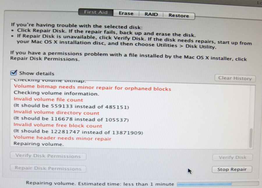

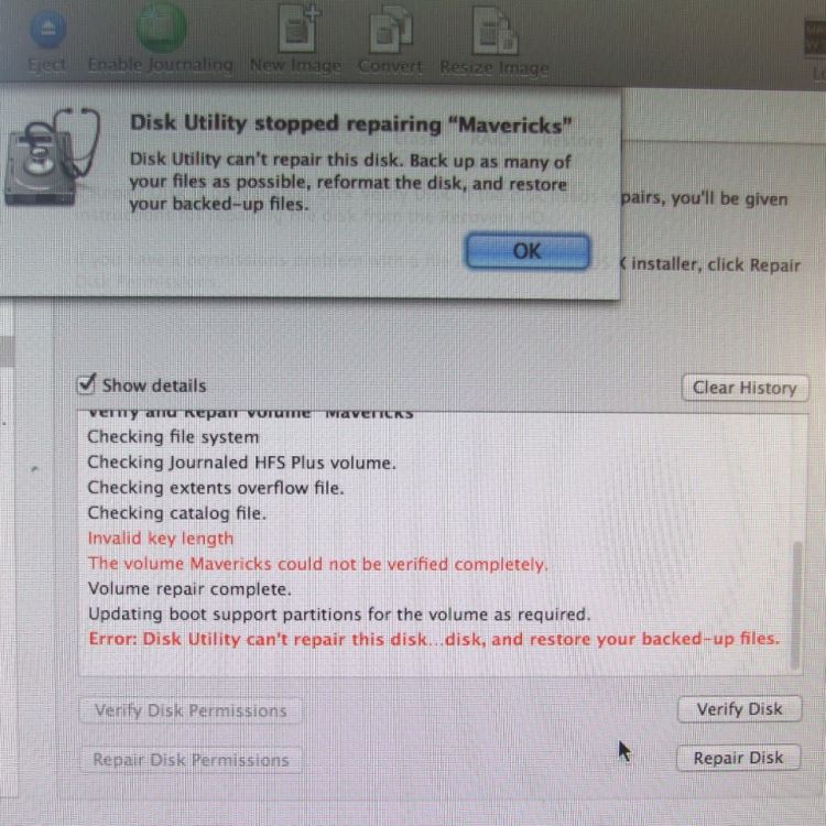

Bandes Posted October 24, 2013 Share Posted October 24, 2013 Ok so i won't post any screenshots now, cause my system killed itself. Mother{censored}ing weak fragile vulnerable {censored} HFS file system once again ! It took me one day to boot into windows cause the bootloader was on that HFS partition too. And now its the 5th day i am suffering with RAM errors. I had about 120 BSODs in these days. My old RAM settings suddenly just don't work. It was stable on 2.2 Volt(2x2Gb Geil PC8500). Now its only running on 1.92 Volt, but still not stable. On every other Voltage settings its more worse. Running memtest and prime95 so angry about this whole thing. I could not recover any {censored} file from that HFS partition yet. Although there is a software which shows the folders it {censored} saving files. Application folder and System folder gone for sure. Disk Utility is the {censored}. Tried to recover the partition with that it only made it worse. So freakin upset now. I am loosing my patience. Oh yeah, it was because i was trying out sleep mode on ML. On wake up it cleared the CMOS. And my RAM settings gone. Everything was on AUTO, and was working, now nothing works. Very dissapointed. Link to comment https://www.insanelymac.com/forum/topic/262015-guide-lion-on-ga-ep45-ud3r-very-close-to-perfection/page/12/#findComment-1957682 Share on other sites More sharing options...
Bandes Posted November 8, 2013 Share Posted November 8, 2013 Very busy two weeks behind me. It took me 10 days to find new stable working settings for my -as it looks like slightly damaged- memory modules. I was getting losing hope on that. I also managed to repair my Windows bootloader after trying many methods out, and finally i was able to recover all the needed files from my Mountain Lion HFS partition. This way i did not need a new partition since ML killed itself.. So i bought a USB Flash Drive, collected all the kexts and tools that was likely to be needed, took a deep breath and started installing Mavericks. After two days, i am nearly there. System is running fine. I have some minor issues, but nothing serious. I am still using Flash Drive to boot into Mavericks, but i will install Clover to my Hard Drive in the next days. Configuring it was not so easy, but i managed it with some work. Now it really looks a bit more advanced than Chameleon/Chimera. When i am finished with everything, i will make a small GUIDE about installing Mavericks for UD3LR. There are lot of tweaks needed for my taste which are not always OSX86 related. Such as turned off Key Repeating, Automatic Saving of editing documents (!) and other weird things which are present on 10.9. Link to comment https://www.insanelymac.com/forum/topic/262015-guide-lion-on-ga-ep45-ud3r-very-close-to-perfection/page/12/#findComment-1965546 Share on other sites More sharing options...

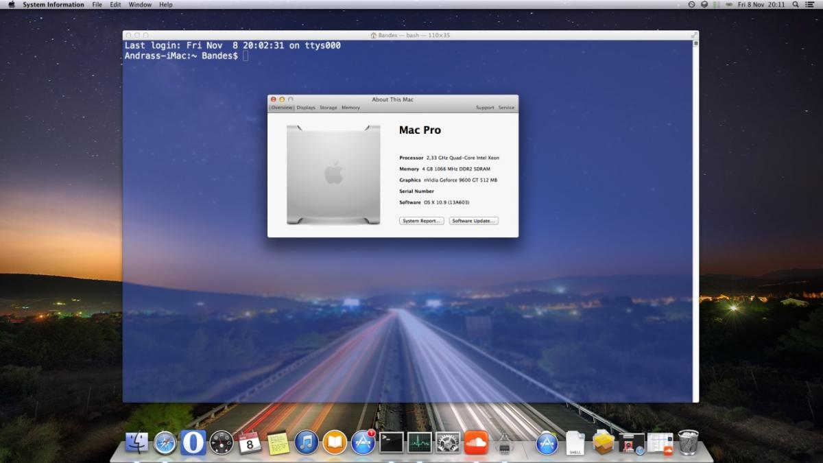

Bandes Posted November 9, 2013 Share Posted November 9, 2013 And Today : Link to comment https://www.insanelymac.com/forum/topic/262015-guide-lion-on-ga-ep45-ud3r-very-close-to-perfection/page/12/#findComment-1965986 Share on other sites More sharing options...
Bandes Posted November 13, 2013 Share Posted November 13, 2013 I started a topic about my experiences over the last week : http://www.insanelymac.com/forum/topic/293854-mac-hfs-drive-getting-damaged-sooo-easily/ 1 Link to comment https://www.insanelymac.com/forum/topic/262015-guide-lion-on-ga-ep45-ud3r-very-close-to-perfection/page/12/#findComment-1967327 Share on other sites More sharing options...
