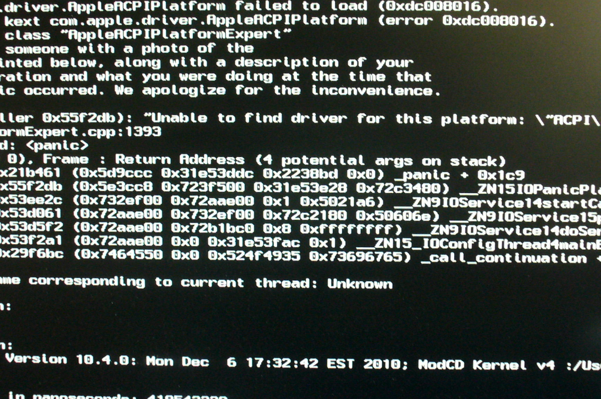

ZokkeR Posted July 25, 2011 Share Posted July 25, 2011 Hey guys, I'm having some problem too but first; awesome guide, everything worked perfect (unless the boot- thing). Well, I can boot in my Snow Leopard using ModCD but when I want Lion to boot alone, it sends out it's kext- lines (around 5-6 pages) and then reboots. I don't know why it does. Because I've also had this problem with my Snow Leopard, I decided to take my ModCD and do it this was. Well, I get some kernel- panic with it. It seems like the ModCD kernel is not working with Lion (no surprise I guess). In the attachments you can check out the Screenshot. I also used Hackboot but it's like I'd use Lion alone, it just restarts after the tons of line when using -v. Thank you in advance! My Specs: CPU: AMD Athlon II x4 640 MoBo: Asus M4A88TD-V Evo/USB 3 GPU: XFX Radeon HD 6870 1GB HDD: Sata 250GB set to AHCI Link to comment https://www.insanelymac.com/forum/topic/260594-guide-installing-lion-dp4-gm-without-usbvideo/page/6/#findComment-1722134 Share on other sites More sharing options...
mekilla Posted July 26, 2011 Share Posted July 26, 2011 I don't think there's a patched kernel out for AMD yet ZokkeR Link to comment https://www.insanelymac.com/forum/topic/260594-guide-installing-lion-dp4-gm-without-usbvideo/page/6/#findComment-1722844 Share on other sites More sharing options...

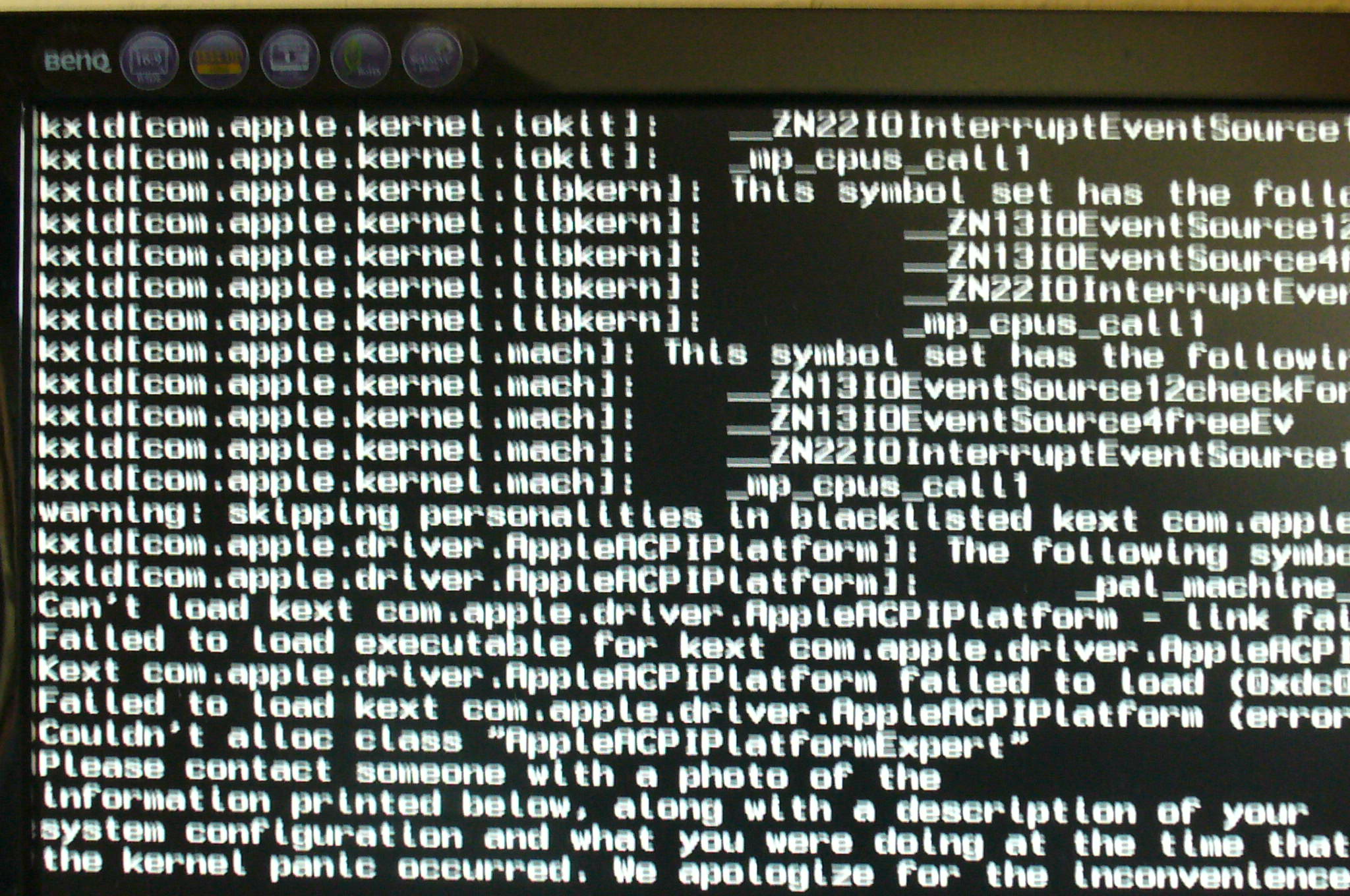

lamorun Posted August 11, 2011 Share Posted August 11, 2011 I followed this guide exactly. In the end, when the "Boot" partition loads, there is a wait at [PCI Configuration Begin] and then the screen goes blank (no kernel panic). Any idea why this happens? Hi guys Thank you for good informations. My system is constantly waiting for this screen shot [Pci configuration begin]. Thank you in advance for your help. Best regards. Intel 1366 Socket desktop pc : Free File Hosting, Online Storage & File Upload with FileServe i 1366.zip http://www.fileserve.com/file/bMVDWVJ/Core Same problem here. Asus N61jq i7 720qm ATI Raderon HD 5730M Link to comment https://www.insanelymac.com/forum/topic/260594-guide-installing-lion-dp4-gm-without-usbvideo/page/6/#findComment-1733321 Share on other sites More sharing options...
Stormed Posted August 11, 2011 Share Posted August 11, 2011 For those with the [Pci configuration begin] or [AppleACPIPlatform] eror. Replace these two kexts in S/L/E... delete the old ones first. ACPI_PCI.zip Link to comment https://www.insanelymac.com/forum/topic/260594-guide-installing-lion-dp4-gm-without-usbvideo/page/6/#findComment-1733447 Share on other sites More sharing options...

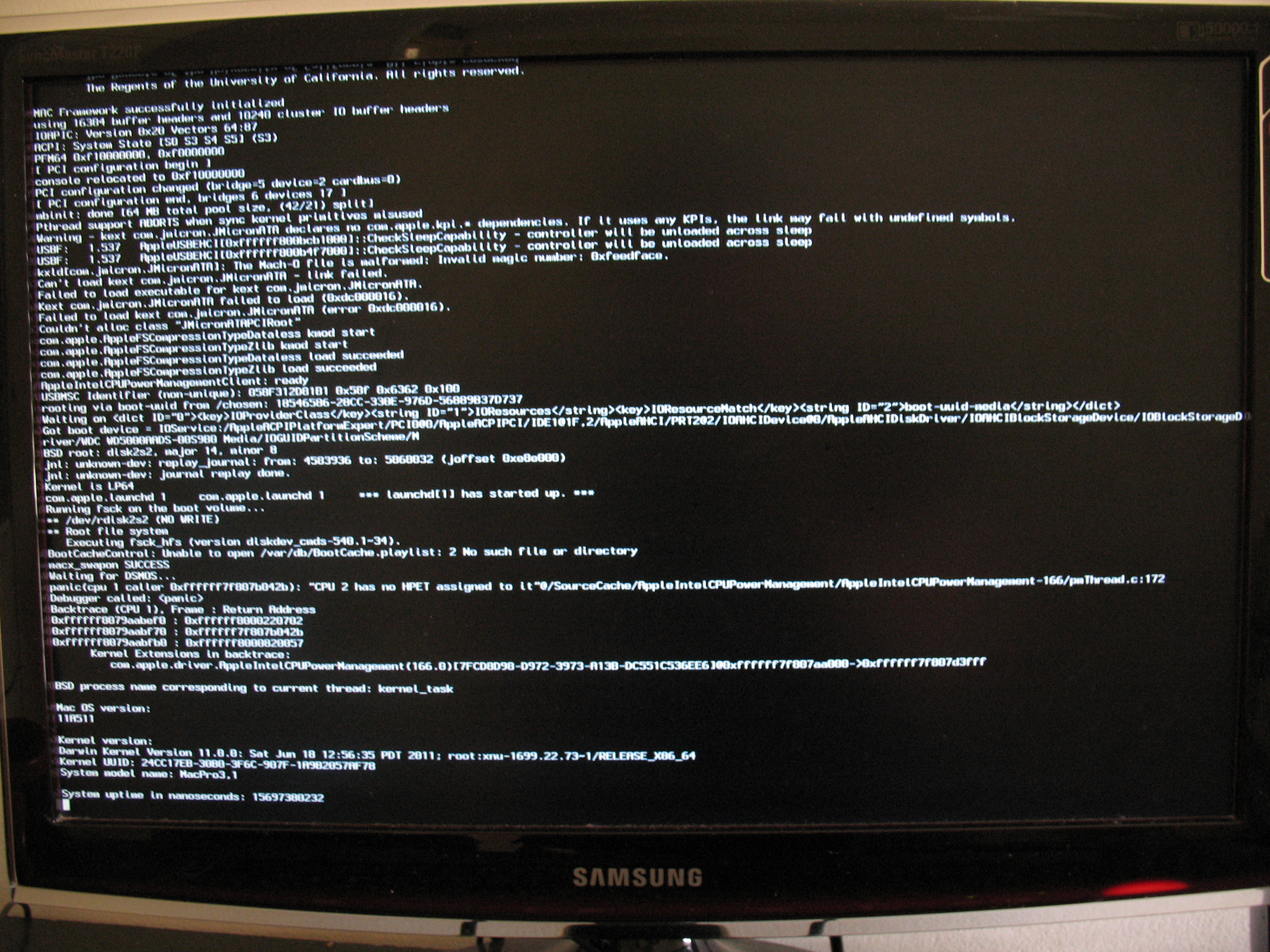

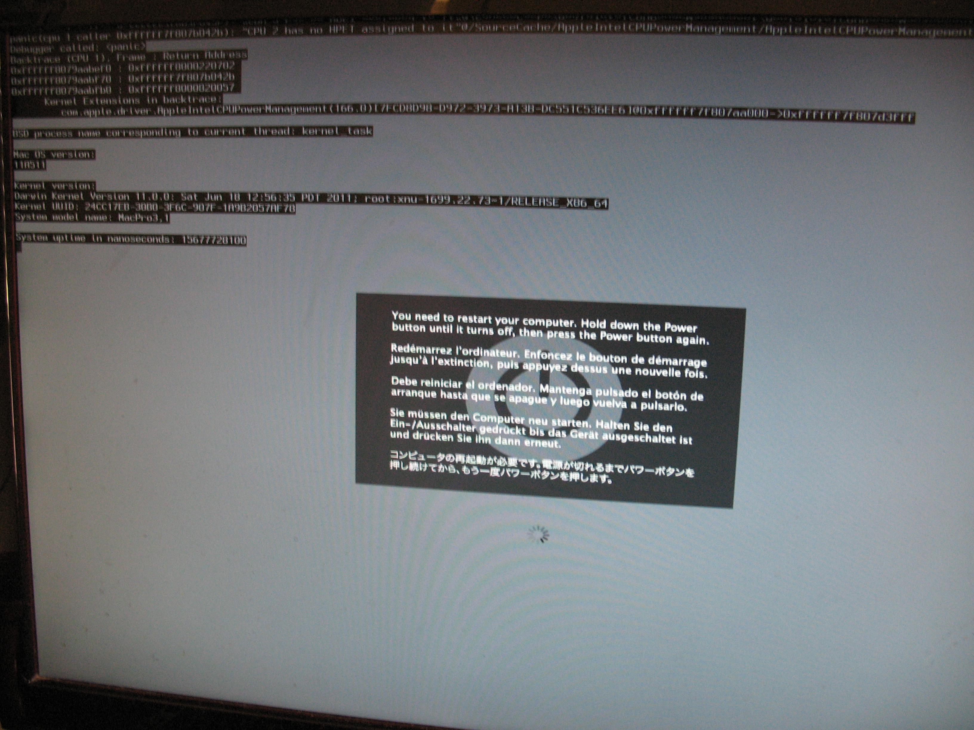

Eiszeit Posted August 12, 2011 Share Posted August 12, 2011 I installed Lion using your guide (I had working 10.6.8) but if fails to boot, the Installation process went perfectly fine, I even had the correct high resolution in the installer. My system is Q6600/EP43-DS3L/HD5450 Install with modified OSinstall.mpkg (because of "This version of OS X cannot be installed on this..." error) and all the kexts I had in E/E on 10.6.8 (I had no DSDT.aml). Could anyone please tell me what's wrong according to the error massage? I'm quite desperate because I don't have any working OS currently (writing from Ubuntu livecd), any help would be appreciated. Thanks. EDIT: I reinstalled with DSDT.aml this time, works, no I'm only missing sound. Link to comment https://www.insanelymac.com/forum/topic/260594-guide-installing-lion-dp4-gm-without-usbvideo/page/6/#findComment-1733730 Share on other sites More sharing options...
Stormed Posted August 12, 2011 Share Posted August 12, 2011 @Eiszeit, you can try removing the AppleIntelCPUPowerManagement.kext in the S/L/E and make sure that you have NullCPUPowerManagement.kext put in E/E.... hope this help! Link to comment https://www.insanelymac.com/forum/topic/260594-guide-installing-lion-dp4-gm-without-usbvideo/page/6/#findComment-1733885 Share on other sites More sharing options...
beanieutah Posted August 14, 2011 Share Posted August 14, 2011 k so I have been playing with this for two+ days so now I will ask for help. I have finally got it to start to load and get stuck on pic. any help would be awsome. EDIT: so I got past this point. Now when i get to the install screen i cant get the mouse to work. If I leave the voodops2 kext in extra folder I cant get to Install screen. But on top of that if i just hit enter and select english then it tells me that this version of mac cant be installed on this system. I have a dell Inspiron 1525. Link to comment https://www.insanelymac.com/forum/topic/260594-guide-installing-lion-dp4-gm-without-usbvideo/page/6/#findComment-1734470 Share on other sites More sharing options...
Eiszeit Posted August 14, 2011 Share Posted August 14, 2011 @Eiszeit, you can try removing the AppleIntelCPUPowerManagement.kext in the S/L/E and make sure that you have NullCPUPowerManagement.kext put in E/E.... hope this help! Thanks, I solved it at the end by installing 10.6.3 again, creating dtst.aml and reinstalling lion. worked perfectly. Thanks. Link to comment https://www.insanelymac.com/forum/topic/260594-guide-installing-lion-dp4-gm-without-usbvideo/page/6/#findComment-1734500 Share on other sites More sharing options...
