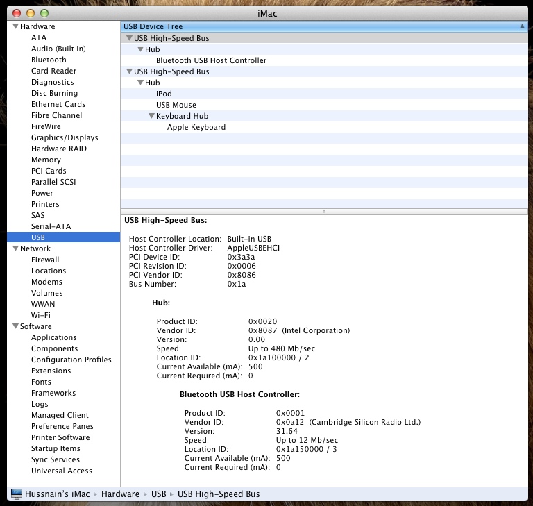

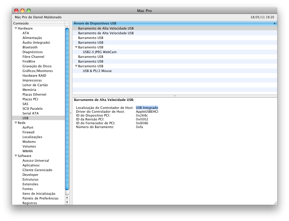

MaLd0n Posted May 18, 2011 Author Share Posted May 18, 2011 Mate somehow i got the java for 10.7 i run dsdt auto patcher here is my dsdt but sleep still doesnt work for me i was not able to attach file here .......... my link for dsdt / motherboard is ASUS P7P55D http://www.mediafire.com/?qoti3oypnhwow3z USB built in? Link to comment https://www.insanelymac.com/forum/topic/256729-lion-installation-via-usb-stick-using-chameleon/page/4/#findComment-1685666 Share on other sites More sharing options...
Hacki-Hacki Posted May 18, 2011 Share Posted May 18, 2011 i think that it is showing the bluetooth usb the one that i m using with magic mouse ...... its a generic one coast like 1.5$ the usb info i think its bluetooth and i m using it in front usb ports because of range problem Link to comment https://www.insanelymac.com/forum/topic/256729-lion-installation-via-usb-stick-using-chameleon/page/4/#findComment-1685677 Share on other sites More sharing options...
