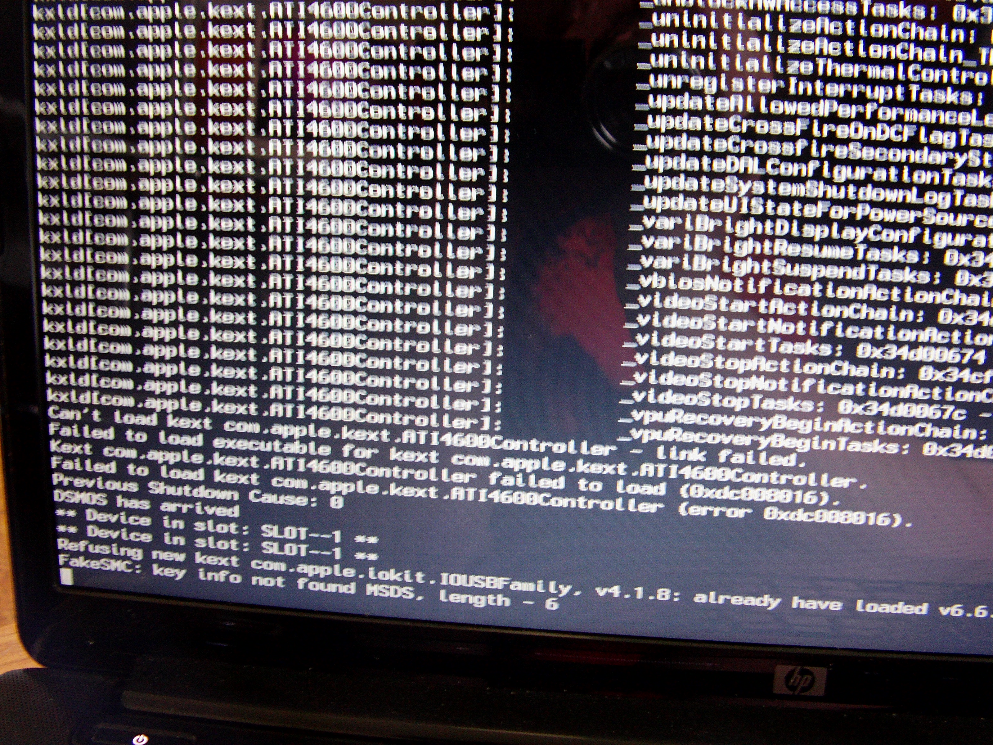

fistofkhesahn Posted May 7, 2011 Share Posted May 7, 2011 hey guys, I think I'm finally getting somewhere! Usually I only get to a white screen where boot up stops, or onto desktop with no kext loaded for my gfx card. Now I'm getting this: Does anyone know how I can fix the issue with not being able to load the kext? It does boot onto desktop, and I can move the curser around but it wont interact with anything. I have to vnc in, and control it from there. But the kext is obviously not loaded Link to comment Share on other sites More sharing options...
Martuzki Posted May 7, 2011 Share Posted May 7, 2011 Maybe you have no 10.6.7 on your HDD Link to comment Share on other sites More sharing options...
fistofkhesahn Posted May 7, 2011 Share Posted May 7, 2011 Ah sorry should have provided more info I guess :] I am running 10.6.7! retail dvd 10.6.3 install with osx86 mod cd! Then used the combo update to 10.6.7 Installed the kexts with [url="http://www.insanelymac.com/forum/topic/279450-why-insanelymac-does-not-support-tonymacx86/"]#####[/url]. Repaired cache and permissions. reboot with -f cpus=1. I then got onto desktop gfx card not recognized and the kexts not loaded. The I reboot with -v cpus=1 GraphicsEnabler=Yes. And that's how I got to the situation in my previous post! Link to comment Share on other sites More sharing options...
Lordadmiral Drake Posted May 7, 2011 Share Posted May 7, 2011 Can you attach yout kext(s) here plz? Your Laptops hardware is almost exactly the same as mine. Me having an Athlon X2 2.1GHz and DDR2 memory Link to comment Share on other sites More sharing options...
Cyrus the Great Posted May 7, 2011 Share Posted May 7, 2011 hey guys, I think I'm finally getting somewhere! Usually I only get to a white screen where boot up stops, or onto desktop with no kext loaded for my gfx card. Now I'm getting this: Does anyone know how I can fix the issue with not being able to load the kext? It does boot onto desktop, and I can move the curser around but it wont interact with anything. I have to vnc in, and control it from there. But the kext is obviously not loaded the problem its with your ati4600controller.kext . search forum and download kextutility .install all kext using it. and go to diskutility and take repairpremision fix in your mac drive. go back to kext utility and rebuild your cache (remove the repair premision fix tick) reboot Link to comment Share on other sites More sharing options...
fistofkhesahn Posted May 7, 2011 Share Posted May 7, 2011 Can you attach yout kext(s) here plz? Your Laptops hardware is almost exactly the same as mine. Me having an Athlon X2 2.1GHz and DDR2 memory I've had a major breakthrough! I took the kexts and rom from this post http://www.insanelymac.com/forum/index.php...t&p=1680267 Took Muchas Modded shrike boot file from http://www.insanelymac.com/forum/index.php...t&p=1655182 last in the post I booted with -v cpus=1 GraphicsEnabler=Yes PciRoot=1 Now My card is being recognized, kext loaded with a res of 1600x900 but for now it's only on VGA output, My internal display is black with flickering blue artifacts.. I remember reading in another topic about someone who had the same card and the 17.3" who got it working, so I guess il have to start diggin through posts, and hopefully get the internal working! Link to comment Share on other sites More sharing options...

Cyrus the Great Posted May 7, 2011 Share Posted May 7, 2011 I've had a major breakthrough! I took the kexts and rom from this post http://www.insanelymac.com/forum/index.php...t&p=1680267 Took Muchas Modded shrike boot file from http://www.insanelymac.com/forum/index.php...t&p=1655182 last in the post I booted with -v cpus=1 GraphicsEnabler=Yes PciRoot=1 Now My card is being recognized, kext loaded with a res of 1600x900 but for now it's only on VGA output, My internal display is black with flickering blue artifacts.. I remember reading in another topic about someone who had the same card and the 17.3" who got it working, so I guess il have to start diggin through posts, and hopefully get the internal working! I'm sorry to say, that I have no idea how to do that >_< download this radeon dump tools from bcc9 and get your memory dump using it (get your video memory dump using everest (search the google for it) and go to your mac os x copy your memory dump to desktop and renam it to memory.rom open terminaland and switch to desktop type (./radeon_bios_decode < memory.rom > encoder.txt) it save your sense id to desktop http://www.insanelymac.com/forum/index.php...st&id=90340 compare the output with this shrike modded (the last number in each line is for sense id )and just replace with id that getting from radon dump 02 00 00 00 40 00 00 00 09 01 00 00 12 00 00 07 LVDS 10 00 00 00 10 00 00 00 00 01 00 00 00 10 01 06 VGA 00 08 00 00 00 02 00 00 00 01 00 00 20 01 02 01 HDMI Link to comment Share on other sites More sharing options...
