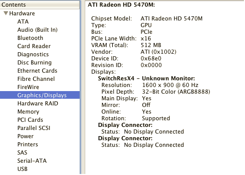

alycannn Posted May 4, 2011 Share Posted May 4, 2011 hi I have 5470 with true resolution but QE/CI is not enabled. I wan't to try DSDT.aml I have Asus K52JR I extract DSDT bin file with EVEREST but I can't compile it it's giving me many errors can you compile it for me? http://www.mediafire.com/?epgvn7g2bl5zl2z Link to comment https://www.insanelymac.com/forum/topic/255976-ati-native-drivers/page/3/#findComment-1678868 Share on other sites More sharing options...
samsonluk Posted May 4, 2011 Share Posted May 4, 2011 hi I have 5470 with true resolution but QE/CI is not enabled. I wan't to try DSDT.aml I have Asus K52JR I extract DSDT bin file with EVEREST but I can't compile it it's giving me many errors can you compile it for me? http://www.mediafire.com/?epgvn7g2bl5zl2z I guess that is the best we can get from HD 5470, I've tried DSDT.aml method but no help in enable QE/CI, I believe need to wait until someone can fix it from the kexts. Link to comment https://www.insanelymac.com/forum/topic/255976-ati-native-drivers/page/3/#findComment-1678878 Share on other sites More sharing options...
Title101 Posted May 4, 2011 Share Posted May 4, 2011 Yes. Good, it mean your HD 5470 is being correctly recognized... they are the same set of kexts being loaded in my notebook when GraphicsEnabler=Yes. Now you need to test different framebuffer with AtiConfig as the boot option, do you know how many output ports in your notebook? The default framebuffer is for 3 ports including the internal display. I believe I have three display ports. I have the VGA, HDMI, and the internal display. I tried a different framebuffer (Hoolock) but I got the same result. I can try some other frambuffer values but I suspect it's an issue with the internal display since I assume it uses LVDS and it may not be getting detected properly. Link to comment https://www.insanelymac.com/forum/topic/255976-ati-native-drivers/page/3/#findComment-1678922 Share on other sites More sharing options...
