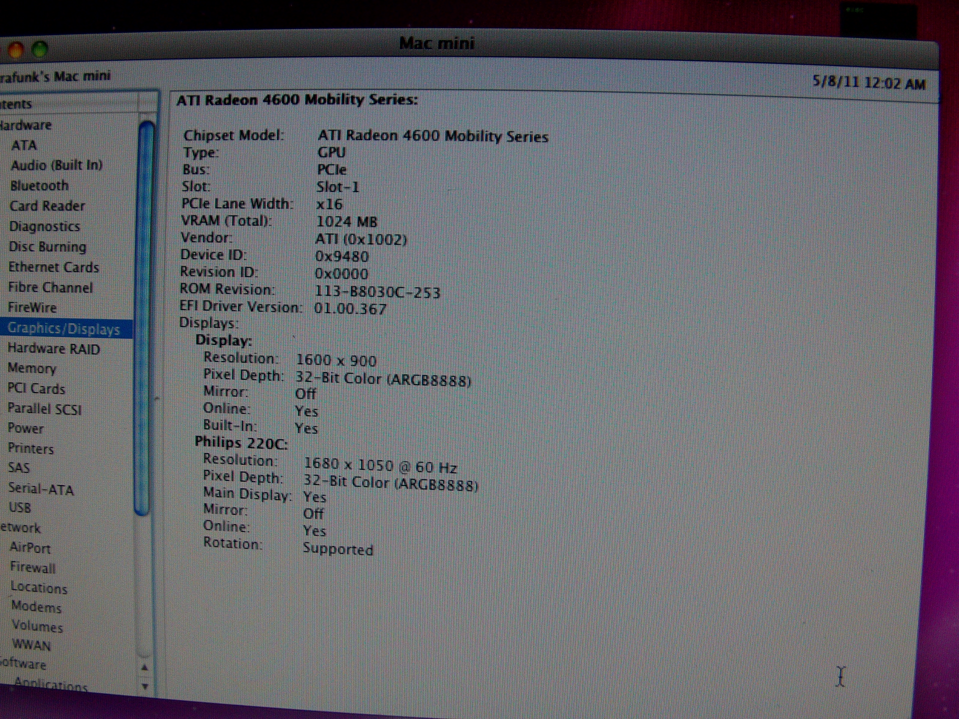

fistofkhesahn your resulation is higher than 1366*768 the problem is with it go to this link for dsdt fix for dual link:
http://www.insanelymac.com/forum/index.php...p;#entry1362685
if dsdt not fix your problem try this:
http://www.insanelymac.com/forum/index.php?showtopic=208410
Hmmm, there's no dsdt.aml in my extra folder O:
what do i do then? >_<
Ok I did what you wrote, but the encoder.txt didnt look anything like yours :/
Mine looks like this:
ATOM BIOS Rom:
SubsystemVendorID: 0x103c SubsystemID: 0x3637
IOBaseAddress: 0x7000
Filename: BR34877.001
BIOS Bootup Message:
BR34877.001 M96 DDR3 128bit 550e/667m
PCI ID: 1002:9480
Connector at index 0
Type [@offset 45486]: LVDS (7)
Encoder [@offset 45490]: INTERNAL_UNIPHY2 (0x21)
i2cid [@offset 45548]: 0x96, OSX senseid: 0x7
Connector at index 1
Type [@offset 45496]: VGA (1)
Encoder [@offset 45500]: INTERNAL_KLDSCP_DAC1 (0x15)
i2cid [@offset 45571]: 0x95, OSX senseid: 0x6
Connector at index 2
Type [@offset 45506]: HDMI-A (11)
Encoder [@offset 45510]: INTERNAL_UNIPHY (0x1e)
i2cid [@offset 45594]: 0x90, OSX senseid: 0x1
The weird thing is, that my laptops screen is black and backlit.
And as you can see on the image, the internal display is recognized and online
but as said, just black and back lit!
Image is taken on the monitor connected to the vga port.
