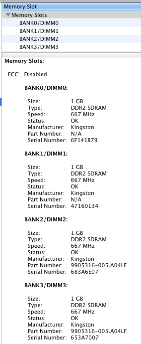

mrmojorisin17 Posted May 5, 2011 Share Posted May 5, 2011 Memory's problem resolved This is my smbios.plist: <key>SMmemmanufacter_1</key> <string>G.Skill</string> <key>SMmemmanufacter_2</key> <string>N/A</string> <key>SMmemmanufacter_3</key> <string>G.Skill</string> <key>SMmemmanufacter_4</key> <string>N/A</string> <key>SMmempart_1</key> <string>F3-12800CL7D-[color="#0000FF"]2[/color]GBXM</string> // changed from [color="#0000FF"]4[/color] according to BIOS <key>SMmempart_2</key> <string>N/A</string> <key>SMmempart_3</key> <string>F3-12800CL7D-[color="#0000FF"]2[/color]GBXM</string> // changed from [color="#0000FF"]4[/color] according to BIOS <key>SMmempart_4</key> <string>N/A</string> <key>SMmemserial_1</key> <string>N/A</string> <key>SMmemserial_2</key> <string>N/A</string> <key>SMmemserial_3</key> <string>N/A</string> <key>SMmemserial_4</key> <string>N/A</string> <key>SMmemspeed</key> <string>1600</string> <key>SMmemtype</key> <string>24</string> According to G.Skill's datasheet my mempart should be F3-12800CL7D-4GBXM. Don't know why if I put F3-12800CL7D-4GBXM in smbios.plist System Profiler gives me the error regarding memory's values reading. Link to comment https://www.insanelymac.com/forum/topic/255866-chameleon-v21-main-trunk/page/9/#findComment-1679349 Share on other sites More sharing options...

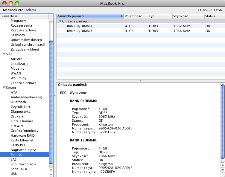

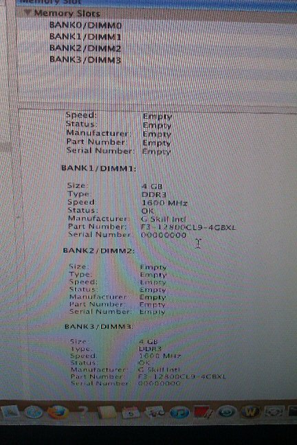

^Andy^ Posted May 5, 2011 Share Posted May 5, 2011 CPU is correctly recognized.The problem regarding only memory. Weird, here's what mine shows and that's not using an smbios file Sorry about the lousy quality but had to use my phone camera for the pic because screenshots not working - probably because of the 6970 and no kexts loaded for it Link to comment https://www.insanelymac.com/forum/topic/255866-chameleon-v21-main-trunk/page/9/#findComment-1679478 Share on other sites More sharing options...
crazybirdy Posted May 5, 2011 Share Posted May 5, 2011 Weird, here's what mine shows and that's not using an smbios file Sorry about the lousy quality but had to use my phone camera for the pic because screenshots not working - probably because of the 6970 and no kexts loaded for it Andy, Thanks for your nice work, mine is working too. But, I wonder about that, is it possible to reload com.apple.Boot.plist from second partition or logical partition which I have selected. Cause of I install XP, Win7, Snow on partition 1,2,3, and install Lion on logical partition 8. The booter always loads Boot.plist from Snow. my bdmesg is attached fyi. Read HFS+ file: [hd(0,3)/Extra/com.apple.Boot.plist] 462 bytes. Read HFS+ file: [hd(0,3)/Extra/Themes/Default/theme.plist] 2798 bytes. ............ Read HFS+ file: [hd(0,8)/mach_kernel] 7851296 bytes. Read HFS+ file: [hd(0,8)/Extra/Extensions/ACPIMonitor.kext/Contents/Info.plist] 2011 bytes. ............ Read HFS+ file: [hd(0,8)/System/Library/Extensions/ACard6280ATA.kext/Contents/Info.plist] 1850 bytes. ............ Read HFS+ file: [hd(0,3)/Extra/Themes/Default/font_small.png] 5525 bytes. Read HFS+ file: [hd(0,8)/Extra/com.apple.Boot.plist] 462 bytes. .....................[works fine] Read HFS+ file: [hd(0,8)/System/Library/CoreServices/SystemVersion.plist] 476 bytes. ............ Read HFS+ file: [hd(0,8)/Extra/SMBIOS.plist] 470 bytes. ............ Read HFS+ file: [hd(0,8)/Extra/DSDT.aml] 38540 bytes. ............ Read HFS+ file: [hd(0,8)/Extra/Themes/Default/boot.png] 6461 bytes. [EDIT] Forget my problem, I found it had already been solved. I can setup to boot 64bits on Snow and 32bits on Lion, the Boot.plist can be loaded from each selected partition and works fine. Chameleon_RC5_755_LionAndy_SNBv3(final) and Chameleon_RC5_755_Lion_SnowV7 both work fine. bdmesg.txt Link to comment https://www.insanelymac.com/forum/topic/255866-chameleon-v21-main-trunk/page/9/#findComment-1679497 Share on other sites More sharing options...

mrmojorisin17 Posted May 5, 2011 Share Posted May 5, 2011 Weird, here's what mine shows and that's not using an smbios file Hey man, I reinstalled you bootloader and now all appears to be ok Thanks for your work man, really appreciated. Link to comment https://www.insanelymac.com/forum/topic/255866-chameleon-v21-main-trunk/page/9/#findComment-1679508 Share on other sites More sharing options...

^Andy^ Posted May 5, 2011 Share Posted May 5, 2011 Hey man, I reinstalled you bootloader and now all appears to be ok Thanks for your work man, really appreciated. Odd, you must have still had the original version from a few days ago. Oh well at least it's working now Link to comment https://www.insanelymac.com/forum/topic/255866-chameleon-v21-main-trunk/page/9/#findComment-1679553 Share on other sites More sharing options...

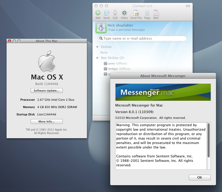

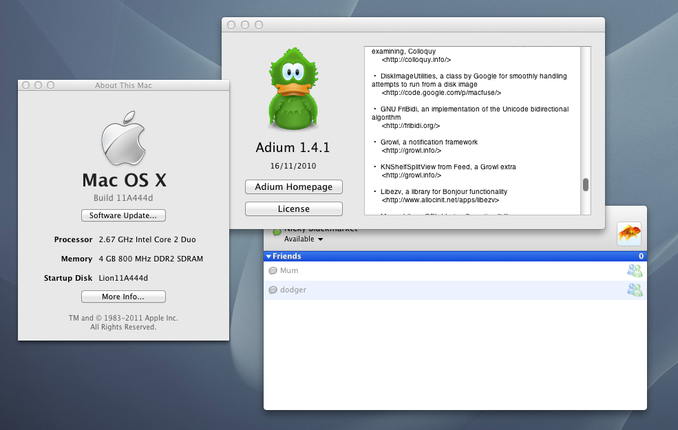

blackosx Posted May 6, 2011 Share Posted May 6, 2011 No one is having the kernel issues I mentioned earlier? I simply can't use any MSN related programs. I don't use the apps myself, but I've just download and tested Adium v1.4.1 and it works fine. I'll test MSN Messenger next. Yep , that works fine too. v8.0.1 Link to comment https://www.insanelymac.com/forum/topic/255866-chameleon-v21-main-trunk/page/9/#findComment-1679737 Share on other sites More sharing options...

asapreta Posted May 6, 2011 Share Posted May 6, 2011 I don't use the apps myself, but I've just download and tested Adium v1.4.1 and it works fine. I'll test MSN Messenger next. Yep , that works fine too. v8.0.1 Thanks for testing but I couldn't find either a solution or the real cause for the problem that only start to happen after the Lion was able to boot directly without DF in chamaleon. Link to comment https://www.insanelymac.com/forum/topic/255866-chameleon-v21-main-trunk/page/9/#findComment-1679893 Share on other sites More sharing options...
