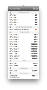

one more question - is native power management working on my machine? i have Q6600 and i can see the multiplier go to X6 (1.6Ghz) and X9 (2.4Ghz) only. im using generate P&C state in boot.plist
