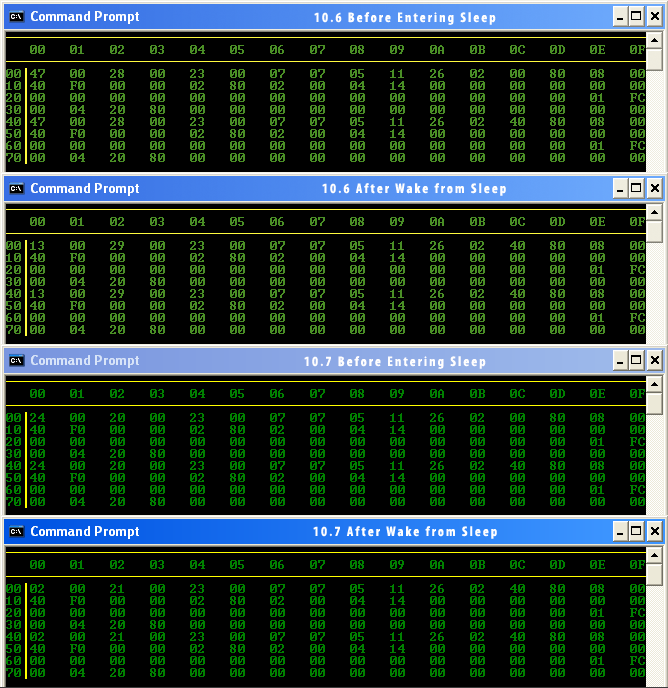

blackosx Posted May 7, 2011 Share Posted May 7, 2011 Related? Could be, but I don't have an eSATA drive to test with. I've been thinking, is there anyway to read the contents of CMOS from our hacks when booted in to OS X? This way we can capture it before entering sleep, then after to see what's changed or see if the checksum has changed, it might help? hmm... I've been reading and found this forum topic with a post to some assembler code, and the .COM executable for reading CMOS but it's for DOS. I might try to install a Windows VM from Lion and see if it works.... EDIT: Well I've tested this from both 10.6 where the CMOS doesn't get reset after reboot when having woken from sleep and again from 10.7 where I do get the CMOS reset after reboot when having woken from sleep. Differences between 10.6 and 10.7 (Values are Hex) Before entering sleep: Offset 10.6 10.7 00 47 24 02 28 20 0C 00 00 40 47 24 42 20 20 After waking from sleep: Offset 10.6 10.7 00 13 29 02 02 21 0C 40 40 40 13 29 42 02 21 Here's a collated image showing all four of the dumps from the Windows WM. What does this show? well I'm not really sure, but it might be food for thought for someone to build upon. UPDATE: Looking again I see the 00-3F is the data block and 40-7F is a duplicate of the first.? Nope, This is not right as otherwise, when offset 0C is changed, 4C should also be changed. I'm thinking the offset's 00 and 02 are the time, with 00 being seconds and 02 being minutes, so I guess these can be ignored which just leaves offset 0C which flips between 00 before sleep and 40 and after sleep. But these are the same for both 10.6 and 10.7 so the problem can't be there. Therefore, if these CMOS dumps are to be trusted, then maybe CMOS is changed by a different process in 10.7? (That can't be as OS X won't know about CMOS?) before reboot / shutdown depending on whether sleep has been used or not? UPDATE: Now I'm confused as booting in to 10.7 again and trying the same method shows offset 0C already set at 40 before entering sleep? I've also found a couple of other DOS tools, CMOSGET and CMOSPUT to read and write CMOS which I'll play with and I've also found a useful post showing what the various bytes are used for. So 00-0F is the RTC and 0C is a Status Register C... LATEST: Sorry for above ramblings as I was just reporting what I found as I went along. To further my understanding about the bytes read: 00-0D = RTC This can be split down in to the following: (Note I haven't included some of the bytes) 00 = Seconds 02 = Minutes 04 = Hours 06 = Day of the week 07 = Date of month 08 = Month 09 = Year 0A = Status Register A Set to 26 (00100110) which means: • Current time is not being set and ready to be read. • System is using 32.768Khz time base frequency • Bank 0 of CMOS RAM is accessed through RTC data register. • System initialised for the divider output frequency. 0B = Status Register B Set to 02 (00000010) which means: • The hour byte is set to 24 hour mode. 0C = Status Register C Set to 00 (00000000) when first read • Means nothing to report. Set to 40 (01000000) when read for a second time and after which means: • PF Flag=1 (A periodic interrupt has occurred). 0D = Status Register D Set to 80 (10000000) which means: • Valid RAM = 1. So contents of RAM are good. So to summise at this point: This all looks normal and doesn't really help here. Something is changing the CMOS data somehow? References found and used: CMOS Registers CMOS RAM Bank 0 More CMOS info at OS Dev Link to comment https://www.insanelymac.com/forum/topic/253992-cmos-resets-on-restarts-after-sleep-and-wake-in-107-lion/page/2/#findComment-1680501 Share on other sites More sharing options...

blackosx Posted May 9, 2011 Share Posted May 9, 2011 Unless all bootloaders are not doing something then it's more likely an ACPI issue, but the question is what exactly..? Can we get a list of mobo brands that are experiencing this problem? So far here we have reports from: Asus (stefano.85, allenwkk) EVGA (iLeopod) Foxconn (Vlada.) Gigabtye (rayap, Maxetto, Javimdq, blackosx, edgar87, kjellamund, MaLd0n) MSI (stellarola) bossob reported no issue but has failed to come back with any details of hardware etc. Link to comment https://www.insanelymac.com/forum/topic/253992-cmos-resets-on-restarts-after-sleep-and-wake-in-107-lion/page/2/#findComment-1681395 Share on other sites More sharing options...

blackosx Posted May 10, 2011 Share Posted May 10, 2011 Hi rayap I don't think we'll find anything in those log files. For reference though, the contents of my logs look pretty similar to yours. I'm looking to the ACPI tables, maybe the FACS, FADT or DSDT. Though TBH, I have nothing solid to work from, just guess work for now. Link to comment https://www.insanelymac.com/forum/topic/253992-cmos-resets-on-restarts-after-sleep-and-wake-in-107-lion/page/2/#findComment-1681560 Share on other sites More sharing options...

JUN Ho Posted May 11, 2011 Share Posted May 11, 2011 I have a same issue. My hack machine is Asus P5K-E Wifi. I found one temporary solution for this issue. Use AppleRTC.kext of snow leopard. It's not a fundamental solution, but it works for me. Link to comment https://www.insanelymac.com/forum/topic/253992-cmos-resets-on-restarts-after-sleep-and-wake-in-107-lion/page/2/#findComment-1682314 Share on other sites More sharing options...
stellarola Posted May 11, 2011 Share Posted May 11, 2011 I have a same issue. My hack machine is Asus P5K-E Wifi. I found one temporary solution for this issue. Use AppleRTC.kext of snow leopard. It's not a fundamental solution, but it works for me. I can confirm this works. So now it seems to be some sort of RTC issue? Interesting. -Stell Link to comment https://www.insanelymac.com/forum/topic/253992-cmos-resets-on-restarts-after-sleep-and-wake-in-107-lion/page/2/#findComment-1682385 Share on other sites More sharing options...
blackosx Posted May 11, 2011 Share Posted May 11, 2011 Use AppleRTC.kext of snow leopard. It's not a fundamental solution, but it works for me. Thanks for the nice work-around JUN Ho. This'll help for now until the problem with Lion's kext is found. Link to comment https://www.insanelymac.com/forum/topic/253992-cmos-resets-on-restarts-after-sleep-and-wake-in-107-lion/page/2/#findComment-1682424 Share on other sites More sharing options...
