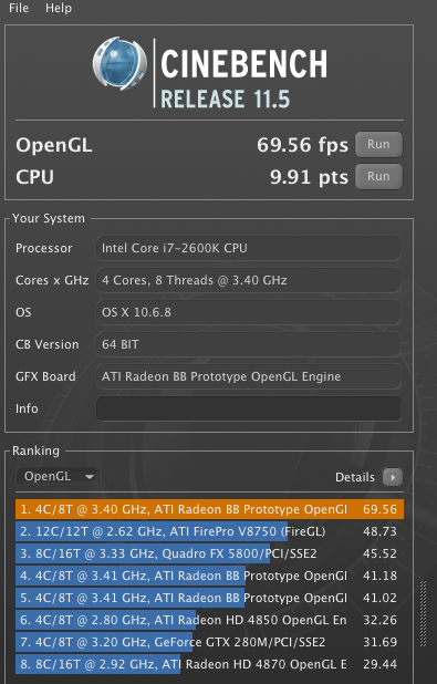

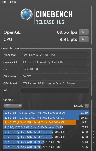

Time2Retire Posted May 16, 2011 Author Share Posted May 16, 2011 Let's have some fun (virtually impossible with Chameleon): Link to comment https://www.insanelymac.com/forum/topic/253642-dsdt-for-asus-p8p67-m-pro/page/12/#findComment-1684436 Share on other sites More sharing options...

flAked Posted May 16, 2011 Share Posted May 16, 2011 Let's have some fun (virtually impossible with Chameleon): You must use some sort of voodoo after all Link to comment https://www.insanelymac.com/forum/topic/253642-dsdt-for-asus-p8p67-m-pro/page/12/#findComment-1684442 Share on other sites More sharing options...

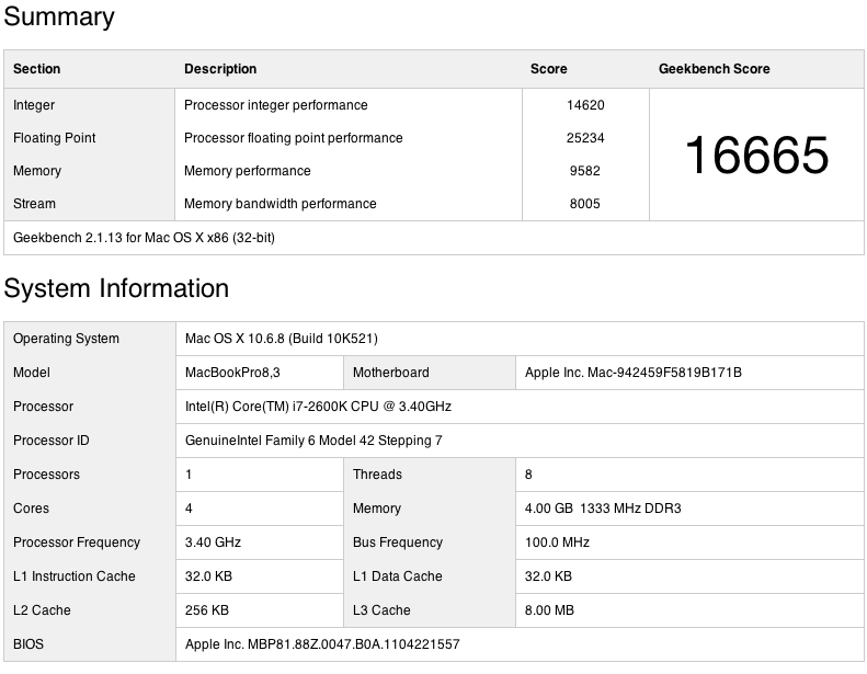

neil43 Posted May 17, 2011 Share Posted May 17, 2011 Let's have some fun (virtually impossible with Chameleon): Your performance numbers are outstanding. Please provide a system configuration outline of hardware, OS, boot environment, etc. Is this a product of the RevoBoot bootloader and your table extractions (referring to your post number one)? By comparison, my ASUS P8P67-Mpro with i7-2600k, 8GB Corsair 1600MHz with a GF 8800 GTS without a DSDT on OS X 10.6.7 with 64bit 10.7.3 kernel: Geekbench at 11309 and Cinebench at 28.74 fps and 6.59 pts. I am very impressed with your benchmark performance achievement. neil Link to comment https://www.insanelymac.com/forum/topic/253642-dsdt-for-asus-p8p67-m-pro/page/12/#findComment-1684697 Share on other sites More sharing options...
