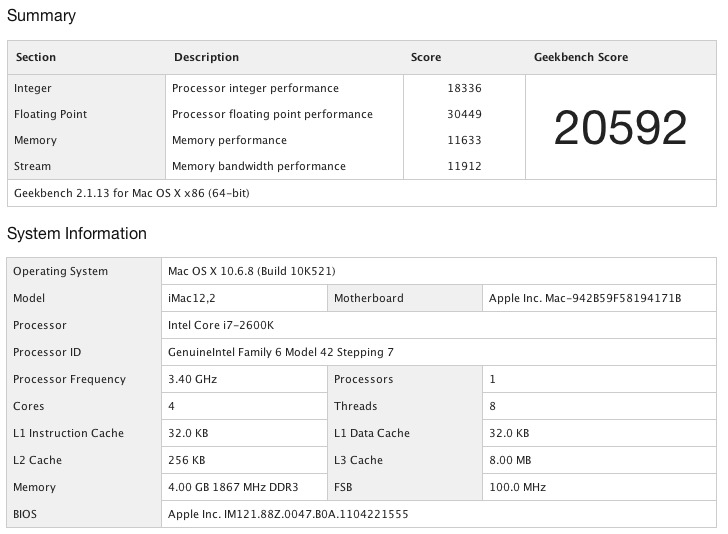

Time2Retire Posted May 17, 2011 Author Share Posted May 17, 2011 Your performance numbers are outstanding. Please provide a system configuration outline of hardware, OS, boot environment, etc. Is this a product of the RevoBoot bootloader and your table extractions (referring to your post number one)? By comparison, my ASUS P8P67-Mpro with i7-2600k, 8GB Corsair 1600MHz with a GF 8800 GTS without a DSDT on OS X 10.6.7 with 64bit 10.7.3 kernel: Geekbench at 11309 and Cinebench at 28.74 fps and 6.59 pts. I am very impressed with your benchmark performance achievement. neil Thanks Neil. And yes. This is RevoBoot with my stripped DSDT. And I have the same board as you, and the same processor, but I have slightly different / less RAM (2 * 2GB 2000MHz clocked at the stock frequency of 1333MHz). The biggest difference however is the installed graphics card (HIS Radeon 6850) plus a new and improved version of RevoBoot. Please note that this test run was done with the stock Intel CPU cooler (no insane water cooled OC) and the default setting of 100 for BCLK. Seem like we only need to push it like 100-200Mhz to crush the number 2 in my screenshot, the MacPro with 8C/16T @2.92 GHz, Intel Xeon CPU X5570's. Not to mention that the faster 3.3GHz model, with two W5590's can also be crushed with a little extra work. I would like to suggest to go for water cooling when you try p.s. 100 MHz extra gave me a score of 17044 but please note that this was with the 32-bit version of Geekbench (64-bit is faster = higher scores). Link to comment https://www.insanelymac.com/forum/topic/253642-dsdt-for-asus-p8p67-m-pro/page/13/#findComment-1684898 Share on other sites More sharing options...

Time2Retire Posted May 17, 2011 Author Share Posted May 17, 2011 Hockey training in a few minutes from now, but I wanted to share this quickly with you: http://browse.geekbench.ca/geekbench2/view/412994 Didn't know that changing the RAM frequency to 1867MHz helped so much – like I said I'm not much of an OC lady. Maybe that will change one day soon. Update: Just back from hockey. Before I left I asked my brother to look at it. If he could push it a little further... and thus I just had the huge pleasure to submit the following report: My goal was to be the first person to hit the 20K barrier, and I did... with the stock Intel cooler. Pretty amazing. I want to install a new triple channel water cooler set, but I am still waiting for some tailor made water blocks. Should allow me to push it to 5.7~6.0 GHz. Hopefully it arrives soon, or it'll be laying in a box for the next couple of months. Link to comment https://www.insanelymac.com/forum/topic/253642-dsdt-for-asus-p8p67-m-pro/page/13/#findComment-1685007 Share on other sites More sharing options...

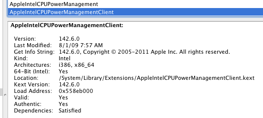

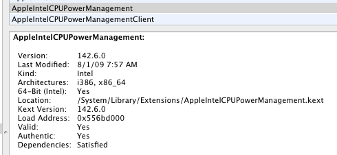

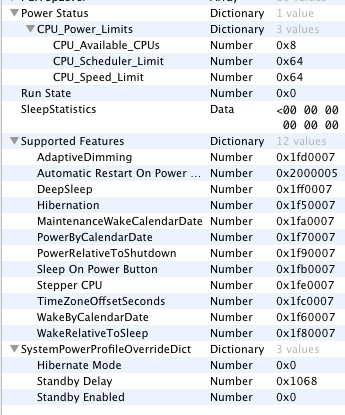

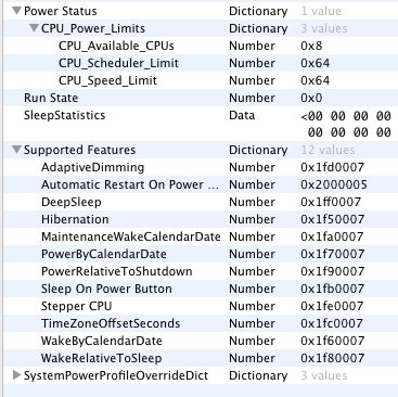

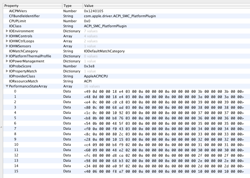

Time2Retire Posted May 18, 2011 Author Share Posted May 18, 2011 No more KP in AppleIntelCPUPowerManagement Time to solve these: AppleIntelCPUPowerManagement: Turbo Ratios 19999 AppleIntelCPUPowerManagement: (built 10:29:57 Apr 27 2011) initialization complete AppleIntelCPUPowerManagementClient: ready ACPI_SMC_PlatformPlugin::pushCPU_CSTData - _CST evaluation failed ACPI_SMC_PlatformPlugin::registerLPCDriver - WARNING - LPC device initialization failed: C-state power management not initialized Update: With the default ACPI tables of the UEFI BIOS I get this error: ACPI_SMC_CtrlLoop::loadStepperContext - pmCPUControl (pmioctlPStateContext_t) failed, result = 0x16 But that's just peanuts when you look at the following screen shots. Yup. Still some work to do here, but we're getting somewhere: Link to comment https://www.insanelymac.com/forum/topic/253642-dsdt-for-asus-p8p67-m-pro/page/13/#findComment-1685587 Share on other sites More sharing options...
