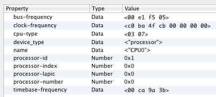

Time2Retire Posted May 5, 2011 Author Share Posted May 5, 2011 Slowly getting somewhere: Only drawback: This because Apple is using a new / updated version of AppleSMBIOS.kext Link to comment https://www.insanelymac.com/forum/topic/253642-dsdt-for-asus-p8p67-m-pro/page/7/#findComment-1679614 Share on other sites More sharing options...
flAked Posted May 5, 2011 Share Posted May 5, 2011 Great work! (if you need testing, send me a diff) Link to comment https://www.insanelymac.com/forum/topic/253642-dsdt-for-asus-p8p67-m-pro/page/7/#findComment-1679620 Share on other sites More sharing options...

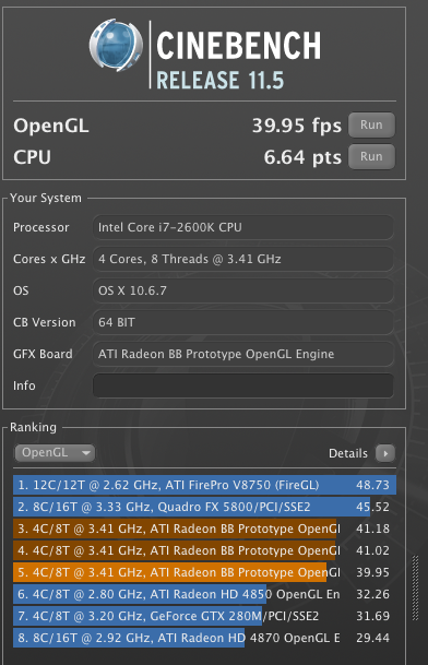

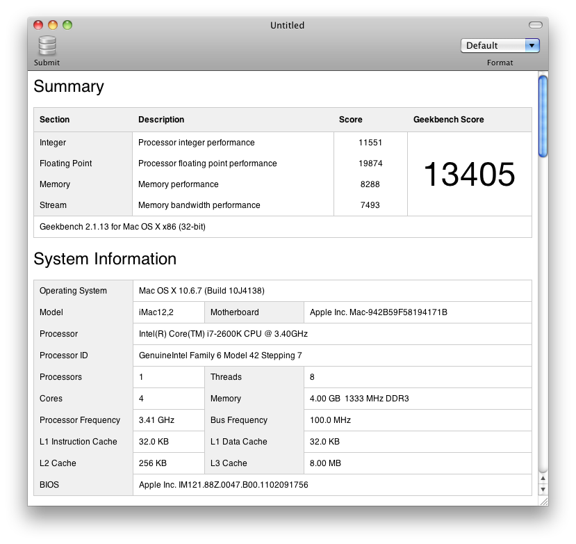

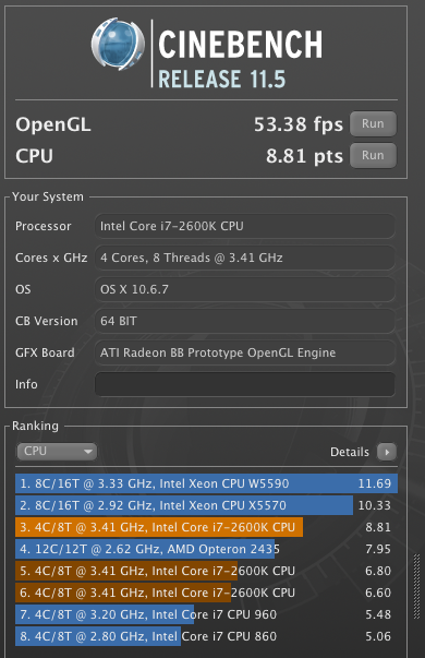

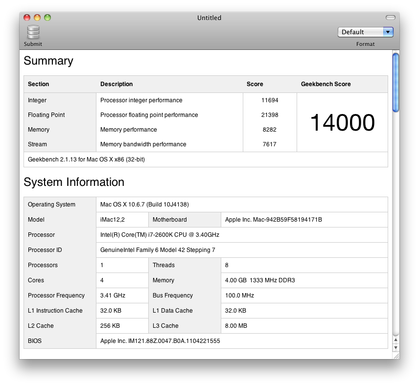

Time2Retire Posted May 5, 2011 Author Share Posted May 5, 2011 Great work! (if you need testing, send me a diff) Thanks. Will update github a.s.a.p. And here's my Cinebench 11.5 report: The right one is from before my changes – had a similar Geekbench improvement with RevoBoot (called Revolution at that time) back in the day that I worked on the HP G72. So what do you think of it? Note: Everything with default (factory) settings! p.s. I will take a break first because I am starting to make errors. Back later... Link to comment https://www.insanelymac.com/forum/topic/253642-dsdt-for-asus-p8p67-m-pro/page/7/#findComment-1679624 Share on other sites More sharing options...
flAked Posted May 6, 2011 Share Posted May 6, 2011 What do you think? Note: Everything with default (factory) settings! Could be Cinebenchs fault... If you look at this http://browse.geekbench.ca/geekbench2/view/404772 you'll see that you have much better memory performance, hence a higher score. Also remember that the iMac12 is on Z67 and they possibly adjusted the thermal threshold - and remember that we run a different system, slashed together without PowerManagement, which could have be active at the start of this Geekbench run. Those numbers are still reasonable, if you did something completely wrong, it would be more astronomical and probably crashed. BTW, Cinebench 11.5 only shows 2 Cores, 4 Threads @ 3.31 GHz and only 4.82 pts - which is totally wrong. I'll take another shot booting Revo. Link to comment https://www.insanelymac.com/forum/topic/253642-dsdt-for-asus-p8p67-m-pro/page/7/#findComment-1679642 Share on other sites More sharing options...
mrmojorisin17 Posted May 6, 2011 Share Posted May 6, 2011 Same here, Cinebench (11.5) shows only 2 Core and 4 Threads @ 3.31GHz and score is 5.04 pts. Link to comment https://www.insanelymac.com/forum/topic/253642-dsdt-for-asus-p8p67-m-pro/page/7/#findComment-1679735 Share on other sites More sharing options...

rafirafi Posted May 6, 2011 Share Posted May 6, 2011 {censored}. I found a serious error in my boot loader: RevoBoot -------- bus-frequency : 400000000 clock-frequency : 3411000000 timebased-frequency: 1000000000 MacBookPro8,3 ------------- bus-frequency : 100000000 clock-frequency : 2200000000 timebased-frequency: 1000000000 If that can help you with chameleon chimera branch and a core i5 2500 (10.6.7 imac upate) and a P8H67-V (hope this is close enought of your board): bus-frequency: 4294967295 clock-frequency: 3432000000 timebased-frequency: 1000000000 Link to comment https://www.insanelymac.com/forum/topic/253642-dsdt-for-asus-p8p67-m-pro/page/7/#findComment-1679765 Share on other sites More sharing options...
Time2Retire Posted May 6, 2011 Author Share Posted May 6, 2011 If that can help you with chameleon chimera branch and a core i5 2500 (10.6.7 imac upate) and a P8H67-V (hope this is close enought of your board): bus-frequency: 4294967295 Thanks. Your bus frequency is 430% of what it should be. Same problem. clock-frequency: 3432000000 This value is either wrong, or you've OC'ed your rig? timebased-frequency: 1000000000 This one is fine. Update: Audio stutter issue is slowly becoming a non-issue. Still there but now in rare circumstances only but I still want/need to figure out what is causing it. Turbo appears to working too because I see very different results in Geekbench – with a top score of almost 14.000 (be it only once). Link to comment https://www.insanelymac.com/forum/topic/253642-dsdt-for-asus-p8p67-m-pro/page/7/#findComment-1679770 Share on other sites More sharing options...
rafirafi Posted May 6, 2011 Share Posted May 6, 2011 Thanks. Your bus frequency is 430% of what it should be. Same problem. This value is either wrong, or you've OC'ed your rig? This is the value in BIOS, same under linux, I did something int he bios with the dram to push it a little, so it's ok. The difference with the real one is maybe just cause the CPU PM client is not loaded... Good investigation. Link to comment https://www.insanelymac.com/forum/topic/253642-dsdt-for-asus-p8p67-m-pro/page/7/#findComment-1679801 Share on other sites More sharing options...
flAked Posted May 6, 2011 Share Posted May 6, 2011 Thanks. Your bus frequency is 430% of what it should be. Same problem. That's the same I got, 0xFFFFFFFF = 4294967295 This is the value in BIOS, same under linux, I did something int he bios with the dram to push it a little, so it's ok.The difference with the real one is maybe just cause the CPU PM client is not loaded... Good investigation. How did you extract the fsb-value under linux, dmidecode? Link to comment https://www.insanelymac.com/forum/topic/253642-dsdt-for-asus-p8p67-m-pro/page/7/#findComment-1679802 Share on other sites More sharing options...
Time2Retire Posted May 6, 2011 Author Share Posted May 6, 2011 That's the same I got, 0xFFFFFFFF = 4294967295 That's the limiter. Look here (AppleSMBIOS.cpp): gPEClockFrequencyInfo.bus_clock_rate_hz = (rateInTs < (1ULL << 32)) ? (uint32_t) rateInTs : 0xFFFFFFFF; Anything above it (4294967296 / 0x100000000) gets reset to: 0xFFFFFFFF hence the 4294967295 And there's the new iMac LATER!!!! Link to comment https://www.insanelymac.com/forum/topic/253642-dsdt-for-asus-p8p67-m-pro/page/7/#findComment-1679809 Share on other sites More sharing options...
