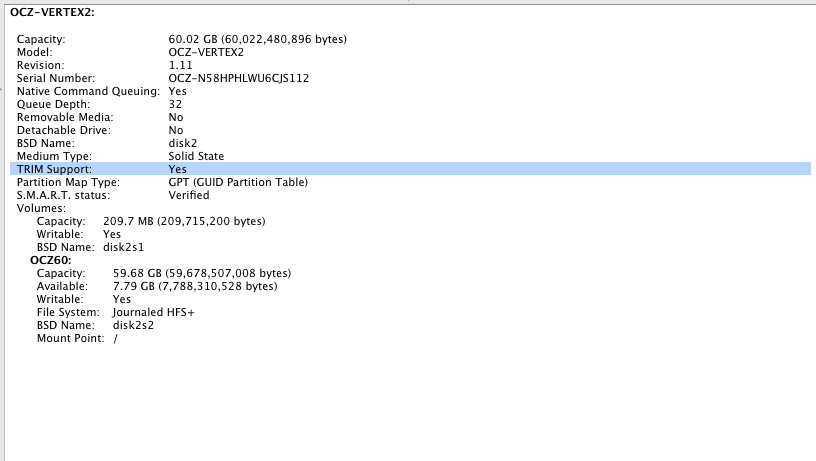

magnifico Posted March 28, 2011 Share Posted March 28, 2011 Installation went well. Xbench scores before and after; BEFORE PATCH System Info Xbench Version 1.3 System Version 10.6.7 (10J869) Physical RAM 4096 MB Model iMac8,1 Drive Type OCZ-VERTEX2 3.5 Disk Test 351.36 Sequential 212.97 Uncached Write 274.16 168.33 MB/sec [4K blocks] Uncached Write 291.89 165.15 MB/sec [256K blocks] Uncached Read 108.13 31.64 MB/sec [4K blocks] Uncached Read 406.43 204.27 MB/sec [256K blocks] Random 1003.40 Uncached Write 1290.74 136.64 MB/sec [4K blocks] Uncached Write 505.85 161.94 MB/sec [256K blocks] Uncached Read 3328.23 23.58 MB/sec [4K blocks] Uncached Read 1070.26 198.59 MB/sec [256K blocks] AFTER PATCH System Info Xbench Version 1.3 System Version 10.6.7 (10J869) Physical RAM 4096 MB Model iMac8,1 Drive Type OCZ-VERTEX2 3.5 Disk Test 345.48 Sequential 207.31 Uncached Write 271.01 166.40 MB/sec [4K blocks] Uncached Write 275.40 155.82 MB/sec [256K blocks] Uncached Read 109.20 31.96 MB/sec [4K blocks] Uncached Read 355.02 178.43 MB/sec [256K blocks] Random 1035.90 Uncached Write 1376.90 145.76 MB/sec [4K blocks] Uncached Write 525.05 168.09 MB/sec [256K blocks] Uncached Read 3360.08 23.81 MB/sec [4K blocks] Uncached Read 1071.93 198.91 MB/sec [256K blocks] Strange....all strange Please use diglloydTools for this bench... Link to comment https://www.insanelymac.com/forum/topic/253369-activate-trim-support-on-any-ssd/page/2/#findComment-1662123 Share on other sites More sharing options...
stefano.85 Posted March 28, 2011 Share Posted March 28, 2011 Apparently works perfect here on both my hack in rig and my girlfriend's macbook pro mid 2010. Both have OCZ vertex2E 60gb (the last ones with 25nm architecture) and 10.6.7 snow leopard. p.s. now that we have a patched kext it is necessary to install it in S/L/E or maybe in the future we can use it also in e/e?? As always.... thx for this hack! regards, stefano Link to comment https://www.insanelymac.com/forum/topic/253369-activate-trim-support-on-any-ssd/page/2/#findComment-1662152 Share on other sites More sharing options...

Maniac10 Posted March 28, 2011 Share Posted March 28, 2011 There's no way to check on osx for now. I've read somewhere that it actually works and proved it by removing a file and then checked with linux if there was some trace left of the space where the file was and there wasn't (something like that ) BTW, the fix worked with my Corsair F60. Link to comment https://www.insanelymac.com/forum/topic/253369-activate-trim-support-on-any-ssd/page/2/#findComment-1662193 Share on other sites More sharing options...

pirloui Posted June 18, 2011 Share Posted June 18, 2011 Intel SSD 320: (80Gb) Works fine with H55M-UD2H, xBench gives 260 before and 300 after trim activation. On G31M-ES2L however, the status does not show up at all, and after some research it looks like ich7 doesn't really support trim, or you need some special windows drivers. Too bad. Link to comment https://www.insanelymac.com/forum/topic/253369-activate-trim-support-on-any-ssd/page/2/#findComment-1699943 Share on other sites More sharing options...
humph Posted June 19, 2011 Share Posted June 19, 2011 ..On G31M-ES2L however, the status does not show up at all, and after some research it looks like ich7 doesn't really support trim, or you need some special windows drivers. Too bad. It would appear that generally ICH7s are OK, from this Intel link: Intel ICH Features Anyway MBP2,2 with ICH7-M and Intel 320 is showing Yes for TRIM support here. Link to comment https://www.insanelymac.com/forum/topic/253369-activate-trim-support-on-any-ssd/page/2/#findComment-1700385 Share on other sites More sharing options...
kocoman Posted June 19, 2011 Share Posted June 19, 2011 I tried TRIM on Nvidia chipset (With the TRIM 1.1 patcher), but it does not work Corsair CSSD-V32GB2: Capacity: 32.02 GB (32,017,047,552 bytes) Model: Corsair CSSD-V32GB2 Revision: 1.100000 Serial Number: xx Removable Media: No Detachable Drive: No BSD Name: disk0 Protocol: ata Unit Number: 0 Socket Type: Serial-ATA Partition Map Type: GPT (GUID Partition Table) S.M.A.R.T. status: Verified Volumes: disk0s1: Capacity: 209.7 MB (209,715,200 b it does not detect solid state I am using: AppleNForceATA.imk64bit in Lion Link to comment https://www.insanelymac.com/forum/topic/253369-activate-trim-support-on-any-ssd/page/2/#findComment-1700466 Share on other sites More sharing options...

trexplorer Posted July 1, 2011 Share Posted July 1, 2011 Adding patched kext or using terminal commands did not work for me (X58-UD3R running 10.6.8). Applying the patch finally worked. Xbench no change in speed before / after (330.) 60GB OCZ Vertex 2 (1st gen). cheers .. Link to comment https://www.insanelymac.com/forum/topic/253369-activate-trim-support-on-any-ssd/page/2/#findComment-1706369 Share on other sites More sharing options...
Graebags Posted July 4, 2011 Share Posted July 4, 2011 Ran the terminal command on 10.7 (11a511), and it appears to have activated Trim for my G.Skills Falcon2 and OCZ Agility3 disks. A bit early yet to report beyond that. Thanks for providing it. Link to comment https://www.insanelymac.com/forum/topic/253369-activate-trim-support-on-any-ssd/page/2/#findComment-1708477 Share on other sites More sharing options...

teme Posted August 12, 2011 Share Posted August 12, 2011 just tried it on my hack running 10.6.7 i get this SSD G2 series 64GB: Capacity: 60.02 GB (60,022,480,896 bytes) Model: SSD G2 series 64GB Revision: 3.4.3 Serial Number: 10000000000000000680 Native Command Queuing: Yes Queue Depth: 32 Removable Media: Yes Detachable Drive: No BSD Name: disk1 Medium Type: Solid State TRIM Support: Yes Partition Map Type: GPT (GUID Partition Table) S.M.A.R.T. status: Verified Volumes: Capacity: 209.7 MB (209,715,200 bytes) Writable: Yes BSD Name: disk1s1 Macintosh SSD: Capacity: 59.68 GB (59,678,507,008 bytes) Available: 51.61 GB (51,611,791,360 bytes) Writable: Yes File System: Journaled HFS+ BSD Name: disk1s2 Mount Point: / I see Trim Support: Yes. Does it means i'm good to go? Thanks Link to comment https://www.insanelymac.com/forum/topic/253369-activate-trim-support-on-any-ssd/page/2/#findComment-1733587 Share on other sites More sharing options...

westwaerts Posted December 28, 2011 Share Posted December 28, 2011 konsole says TRIM ON, trim says NOT WORKING, sys profiler says TRIM NO version 2 beta 4.0 on samsung 830 64GB, rebooted, so i did it the manual method, edited the kext in hexeditor (APPLE SSD replaced with the name of my drive (first 9 digits)) and it works. Link to comment https://www.insanelymac.com/forum/topic/253369-activate-trim-support-on-any-ssd/page/2/#findComment-1781689 Share on other sites More sharing options...
buoo Posted August 2, 2012 Share Posted August 2, 2012 Ok in ML 10.8.0 sudo perl -pi -e 's|\x41\x50\x50\x4C\x45\x20\x53\x53\x44|\x00\x00\x00\x00\x00\x00\x00\x00\x00|g' /System/Library/Extensions/IOAHCIFamily.kext/Contents/PlugIns/IOAHCIBlockStorage.kext/Contents/MacOS/IOAHCIBlockStorage Link to comment https://www.insanelymac.com/forum/topic/253369-activate-trim-support-on-any-ssd/page/2/#findComment-1840246 Share on other sites More sharing options...
