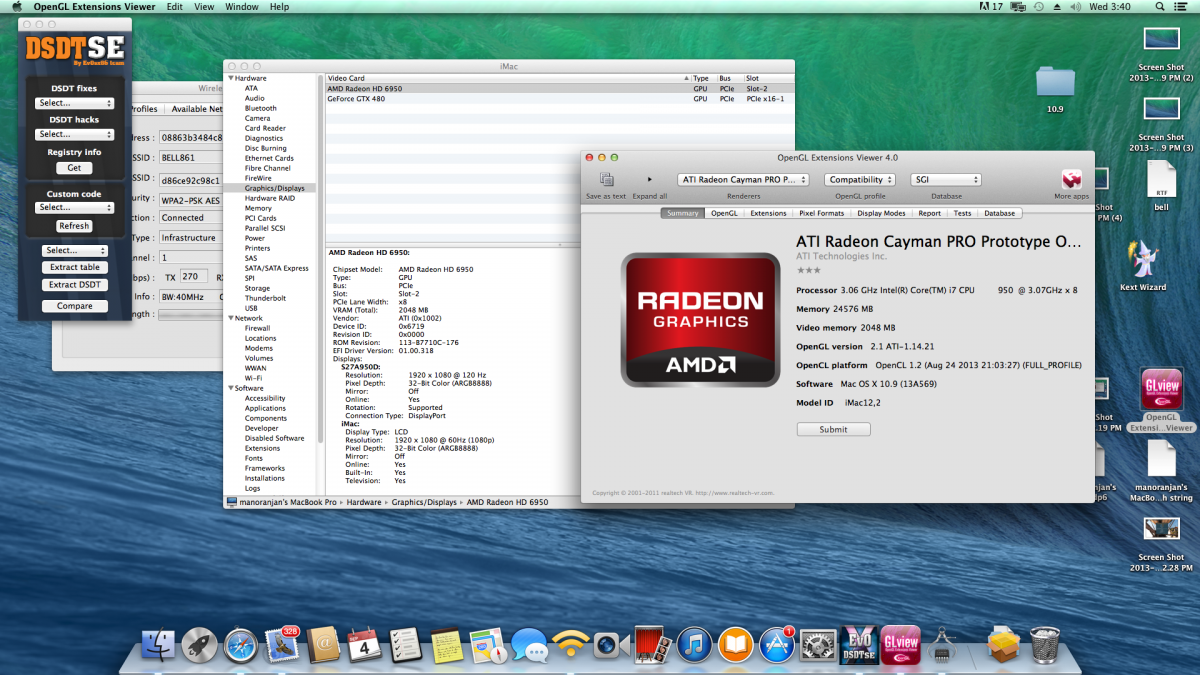

xmen107 Posted July 3, 2013 Share Posted July 3, 2013 I have xfx 6950 I try 10.9 dp2 Anybody know about patch can you help me Thank you.This is my card bios detail Personality: Gibba ConnectorInfo count in decimal: 5 Disk offset in decimal 179984 0000000 00 04 00 00 04 03 00 00 00 01 00 00 12 04 05 01 0000010 00 04 00 00 04 03 00 00 00 01 00 00 22 05 04 02 0000020 00 08 00 00 04 02 00 00 00 01 00 00 11 02 06 04 0000030 00 02 00 00 14 02 00 00 00 01 00 00 00 00 03 05 0000040 04 00 00 00 04 02 00 00 00 01 00 00 11 02 01 03 0000050 Last login: Tue Jun 26 09:14:57 on ttys000 navaratnams-Mac-Pro-2:~ navaratnammanoranjan$ /Users/navaratnammanoranjan/Desktop/VBIOS/redsock_bios_decoder </Users/navaratnammanoranjan/Desktop/slot1/1002_6719.rom 695CNF80.BIN: CAYMAN PRO Hill GDDR5 BIOS Subsystem Vendor ID: 1682 Subsystem ID: 3122 Object Header Structure Size: 436 Connector Object Table Offset: 52 Router Object Table Offset: 0 Encoder Object Table Offset: 145 Display Path Table Offset: 12 Connector Object Id [19] which is [DISPLAY_PORT] encoder obj id [0x21] which is [INTERNAL_UNIPHY2 (osx txmit 0x12 [duallink 0x2] enc 0x4)] linkb: false Connector Object Id [19] which is [DISPLAY_PORT] encoder obj id [0x21] which is [INTERNAL_UNIPHY2 (osx txmit 0x22 [duallink 0x2] enc 0x5)] linkb: true Connector Object Id [12] which is [HDMI_TYPE_A] encoder obj id [0x20] which is [INTERNAL_UNIPHY1 (osx txmit 0x11 [duallink 0x1] enc 0x2)] linkb: false Connector Object Id [3] which is [DVI_D] encoder obj id [0x20] which is [INTERNAL_UNIPHY1 (osx txmit 0x11 [duallink 0x1] enc 0x2)] linkb: false Connector Object Id [2] which is [DVI_I] encoder obj id [0x1e] which is [INTERNAL_UNIPHY (osx txmit 0x10 [duallink 0x0] enc 0x0)] linkb: false Connector Object Id [2] which is [DVI_I] encoder obj id [0x15] which is [INTERNAL_KLDSCP_DAC1 (osx txmit 0x00 enc 0x10?)] linkb: false navaratnams-Mac-Pro-2:~ navaratnammanoranjan$ ------------------------------------ Last login: Sat Jun 30 18:33:56 on ttys000 navaratnams-Mac-Pro-2:~ navaratnammanoranjan$ /Users/navaratnammanoranjan/Desktop/xfx6950\ files1/radeon_bios_decode </Users/navaratnammanoranjan/Desktop/xfx6950\ files1/1002_6719.rom ATOM BIOS Rom: SubsystemVendorID: 0x1682 SubsystemID: 0x3122 IOBaseAddress: 0x0000 Filename: 695CNF80.BIN BIOS Bootup Message: CAYMAN PRO Hill GDDR5 BIOS PCI ID: 1002:6719 Connector at index 0 Type [@offset 44199]: DisplayPort (10) Encoder [@offset 44203]: INTERNAL_UNIPHY2 (0x21) i2cid [@offset 44335]: 0x90, OSX senseid: 0x1 Connector at index 1 Type [@offset 44209]: DisplayPort (10) Encoder [@offset 44213]: INTERNAL_UNIPHY2 (0x21) i2cid [@offset 44362]: 0x91, OSX senseid: 0x2 Connector at index 2 Type [@offset 44219]: HDMI-A (11) Encoder [@offset 44223]: INTERNAL_UNIPHY1 (0x20) i2cid [@offset 44389]: 0x93, OSX senseid: 0x4 Connector at index 3 Type [@offset 44229]: DVI-D (3) Encoder [@offset 44233]: INTERNAL_UNIPHY1 (0x20) i2cid [@offset 44416]: 0x92, OSX senseid: 0x3 Connector at index 4 Type [@offset 44239]: DVI-I (2) Encoder [@offset 44243]: INTERNAL_UNIPHY (0x1e) i2cid [@offset 44453]: 0x94, OSX senseid: 0x5 Connector at index 5 Type [@offset 44249]: DVI-I (2) Encoder [@offset 44253]: INTERNAL_KLDSCP_DAC1 (0x15) i2cid [@offset 44453]: 0x94, OSX senseid: 0x5 navaratnams-Mac-Pro-2:~ navaratnammanoranjan$ Please read this carefully. You need time and patience. This tutorial was easier for me, but it took me several hours to get it working http://rampagedev.wordpress.com/kext-editing/editing-atiamd-framebuffer-personality/ Edit: I've been searching the forum and you put an tutorial here... why you can not put it to work? I think the patches are the same... Link to comment https://www.insanelymac.com/forum/topic/250804-ati-radeon-6xxx-working-qeci/page/30/#findComment-1929811 Share on other sites More sharing options...

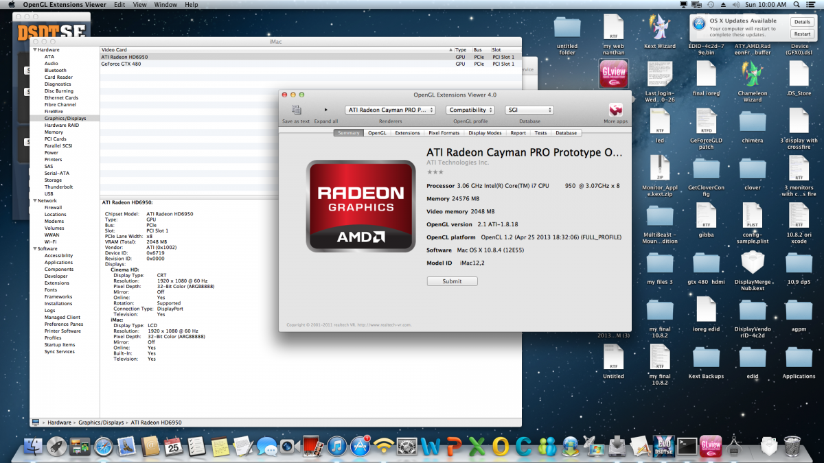

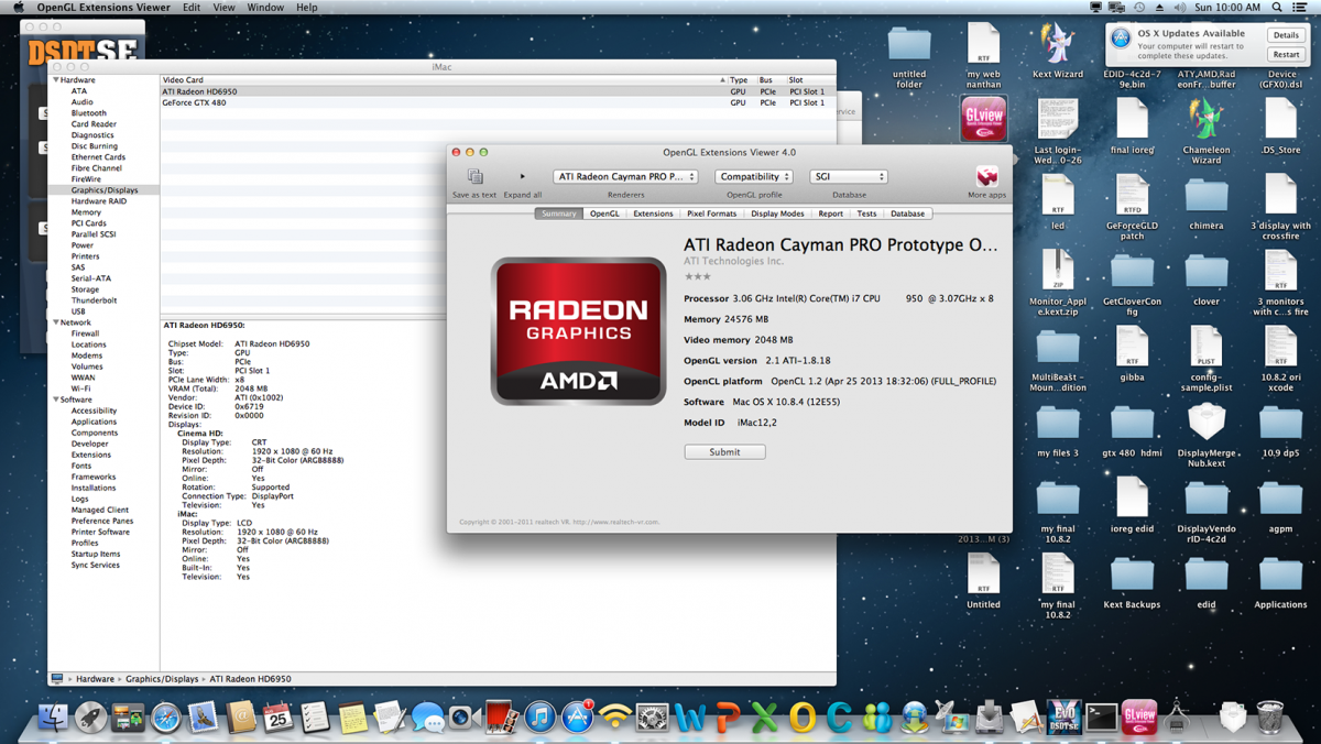

andybe Posted August 24, 2013 Share Posted August 24, 2013 Desktop HD 6970 10.8.4 & 10.9 dp 6 works, except by: - DSDT.aml - hd4000/hd3000 boot igpu as master . cold boot bug - no sleep because of cold bug with chameleon. With Clover sleep on 10.8.4 works. 6970 isn't realy working OpenGL bugs the same for 10.8.4 and 10.9 dp 6 while opengl shows as 10.8.4 GL 3.2 and 10.9 dp6 GL 4.1 it's still cayman xt prototype .... 1 Link to comment https://www.insanelymac.com/forum/topic/250804-ati-radeon-6xxx-working-qeci/page/30/#findComment-1941038 Share on other sites More sharing options...
nmano Posted August 25, 2013 Share Posted August 25, 2013 Hi andybe Thanks for report about 6970 its worked with ori kexts? please upload sample images and dsdt Link to comment https://www.insanelymac.com/forum/topic/250804-ati-radeon-6xxx-working-qeci/page/30/#findComment-1941079 Share on other sites More sharing options...
nmano Posted August 25, 2013 Share Posted August 25, 2013 Original kext, but the AMDRadeonAccelerator.kext needs to be patched for 10.8.4 and AMDRadeonX3000 for 10.9.x Really bad. The heaven benchmark flickers around....But world of warcraft is playable (30-40% slower as on windows). Because of no sleep, not good for daily use, that's why i got real macs... Good job.Can you upload your patch kext AMDRadeonAccelerator ple I dont know how to I am waiting your lovely kexts 10.9 dp6 and 10.8.4 Link to comment https://www.insanelymac.com/forum/topic/250804-ati-radeon-6xxx-working-qeci/page/30/#findComment-1941137 Share on other sites More sharing options...
andybe Posted August 25, 2013 Share Posted August 25, 2013 link not work load mediafire Patched file for 6950/6970 Link to comment https://www.insanelymac.com/forum/topic/250804-ati-radeon-6xxx-working-qeci/page/30/#findComment-1941146 Share on other sites More sharing options...
nmano Posted August 25, 2013 Share Posted August 25, 2013 how to enable its say Sorry, you don't have permission for that try to upload http://www.osx86.net Link to comment https://www.insanelymac.com/forum/topic/250804-ati-radeon-6xxx-working-qeci/page/30/#findComment-1941154 Share on other sites More sharing options...
nmano Posted August 25, 2013 Share Posted August 25, 2013 http://www.osx86.net/downloads.php?do=file&id=4143 Thanks man.its worked. Can you load 10.9 dp6 file too ple Link to comment https://www.insanelymac.com/forum/topic/250804-ati-radeon-6xxx-working-qeci/page/30/#findComment-1941162 Share on other sites More sharing options...
nmano Posted August 25, 2013 Share Posted August 25, 2013 Thanks man very good job. Link to comment https://www.insanelymac.com/forum/topic/250804-ati-radeon-6xxx-working-qeci/page/30/#findComment-1941174 Share on other sites More sharing options...

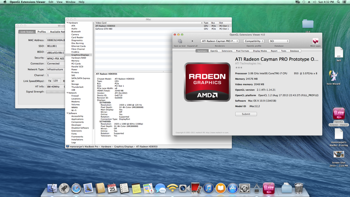

andybe Posted August 25, 2013 Share Posted August 25, 2013 Thanks man.its worked. Can you load 10.9 dp6 file too ple Stay with 10.8.4 is good for now. 10.9 isn't released. dp6 is to unstable....here it is by your request... AMDRadeonX3000.kext.zip 1 Link to comment https://www.insanelymac.com/forum/topic/250804-ati-radeon-6xxx-working-qeci/page/30/#findComment-1941177 Share on other sites More sharing options...
nmano Posted August 25, 2013 Share Posted August 25, 2013 sorry if i want to patch 10.9 dp6 what things I need Link to comment https://www.insanelymac.com/forum/topic/250804-ati-radeon-6xxx-working-qeci/page/30/#findComment-1941254 Share on other sites More sharing options...
nmano Posted August 25, 2013 Share Posted August 25, 2013 Only AMDRadeonX3000.kext.zip from above. 10.8.4 has same setup here ... this is ori kext or patched Link to comment https://www.insanelymac.com/forum/topic/250804-ati-radeon-6xxx-working-qeci/page/30/#findComment-1941259 Share on other sites More sharing options...
nmano Posted August 25, 2013 Share Posted August 25, 2013 Woo you Did. I try 10.9 and spend lots time never work for me. Today I am happy. Link to comment https://www.insanelymac.com/forum/topic/250804-ati-radeon-6xxx-working-qeci/page/30/#findComment-1941313 Share on other sites More sharing options...
