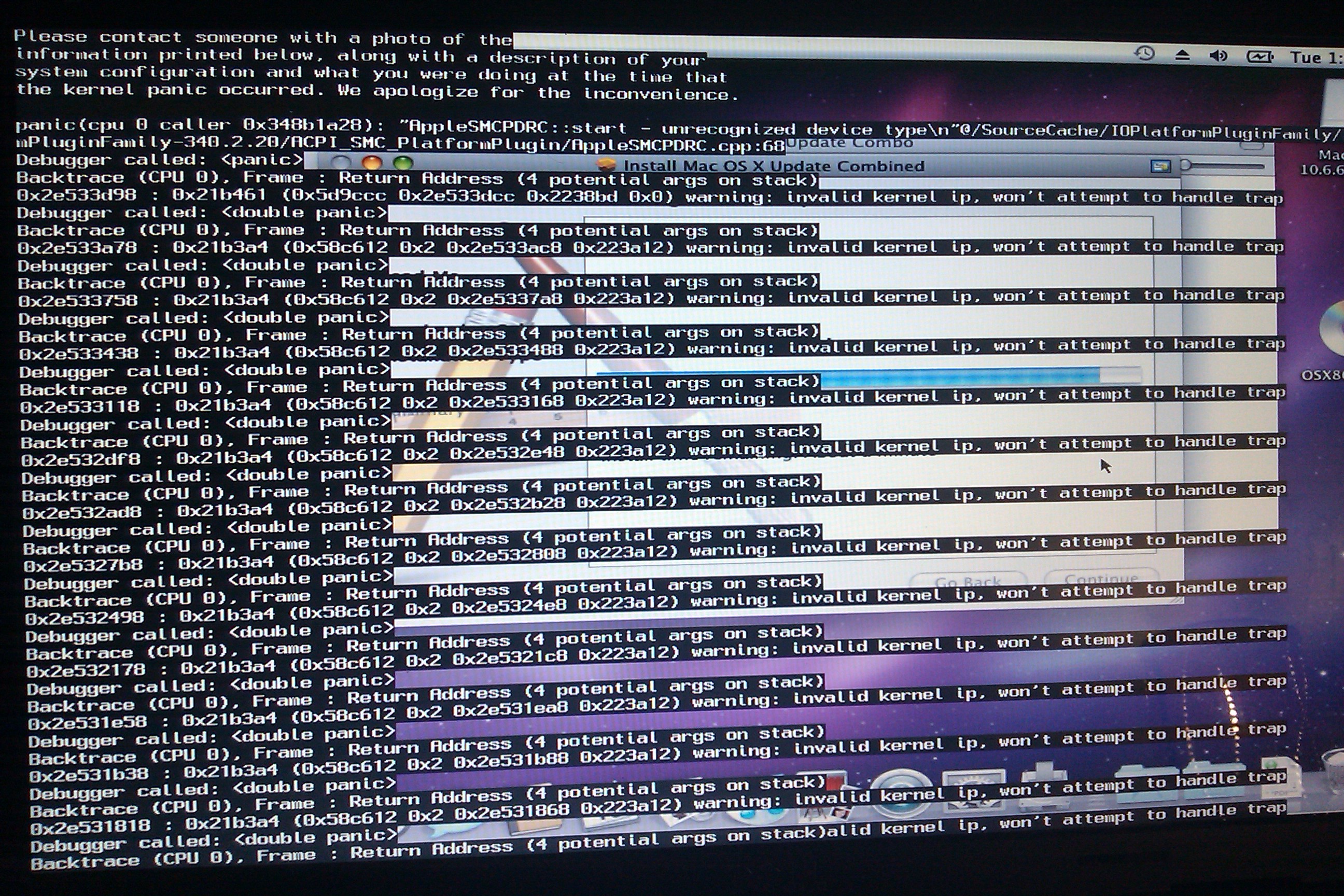

johnie89 Posted April 19, 2011 Share Posted April 19, 2011 Hey Just wondering will the L701X_Files_v3 work with the exact same spec as you have except I've got the NVIDIA GeForce GT 435M (1024 MB) and the Intel Core i5-560M. I'll have a go at it later anyways, I just wanted to see if anyone knows if I'm gona have problems Thanks ~J I've tried your method above. I was able to install Mac OSX (10.6.0) without any issues until I tried updating to 10.6.6 using the Combo update. The update gets near to the end and then while running the scripts the following kernel panic happens. I've included a pic. If anyone could help out with any advice I'd be really grateful Link to comment https://www.insanelymac.com/forum/topic/247741-guide-dell-l701x-xps-17-late-2010/page/2/#findComment-1672129 Share on other sites More sharing options...
vladlenas Posted April 19, 2011 Share Posted April 19, 2011 I've tried your method above. I was able to install Mac OSX (10.6.0) without any issues until I tried updating to 10.6.6 using the Combo update. The update gets near to the end and then while running the scripts the following kernel panic happens. I've included a pic. If anyone could help out with any advice I'd be really grateful Download 10.6.6 Upd.,install,reboot and try this 10.6.7 Link to comment https://www.insanelymac.com/forum/topic/247741-guide-dell-l701x-xps-17-late-2010/page/2/#findComment-1672360 Share on other sites More sharing options...
one9092002 Posted April 22, 2011 Share Posted April 22, 2011 DELL L701X GUIDE! (WorkInProgress) a guide for install Snow Leopard and create a fantastic hackintosh (HEAVY) laptop. Hardware Configuration: CPU : Intel Core i7-740M Chipset : Intel Ibex Peak-M HM57, Intel Lynnfield RAM : 4GB DDR3-1333 (2X2 - 2Slot free) Video : NVIDIA GeForce GT 445M (3072 MB) Monitor : 1600X900 Audio : Realtek ALC665 HD : 500GB Sata WiFi : Intel WiFi Link 1000 BGN (switched to Dell 1510, works OOB) Ethernet : Gigabit Ethernet Realtek 8168 What work: - NVIDIA GeForce GT 445M (3072 MB) - HDMI Video out - Realtek ALC665 - Gigabit Ethernet Realtek 8168 - 2MP Webcam - Bluetooth - Synaptic TrackPad (with 2 finger scrolling) - Keyboard - USB Ports (all 2.0 and 3.0) - Deep Sleep (But No USB2 ports after resume!) What not work: - Intel WiFi Link 1000 BGN (switched to Dell 1510, works OOB) - Sata Port (Not Tested, but probably work) - SDCard Reader (Not Tested) - HDMI Audio out - Display Port (Not Tested) - DVB-T card (Not Tested, but probably not work) Bench: GeekBench v2.1.12 result: 5200 XBench 1.3 (Without HD)result: 130 Installation Use nawcom Mod CD 0.3.1 and a 10.6.3 DVD or USB image.NOTE: if you use like me a Installation from USB, don't use USB3 port.NOTE: deselect custom option in OSX installation from nawcom before install.Install on the first partition on an MBR or GPT HD. After the installation Finish, reboot, and start the partition with nawcom. Copy all necessary files on your desktop (USB not work after 10.6.6 installation) Install 10.6.6 Combo Update dowloaded From Apple Website Reboot and restart your partition with Nawcom. Now, install Chameleon, i have used r699 by iReset, Downloaded HereCopy Extra Folder from attached file in your root.Delete AppleHDA.kext and IOAudioFamily.kext in System/Library/Extensions of your installation partition. Copy the files in "System-Lib-Ext" from attached file in System/Library/ExtensionsRun Kext Utility for repair permissions, recreate system cache And Reboot. Boot From Your Installed Partition Now install tonymacx86 NVIDIA Update, I have used 1.0.1(current). Reboot Now install Lnx2Mac's RTL81xx Driver Reboot NOTE: If you want DeepSleep, open Terminal and type: sudo pmset -a hibernatemode 5 NOTE: In the attached files is present a .icc for LG LCD panel Profile from ironnerd(notebookreview.com) NOTE: Probably this guide works also for L401X and L501X with i7-740QM or i7 840QM CPU. Future improvement: - DSDT enhancement (nedd help for USB2 sleep problem) Changes: v2: - DSDT from MaLd0n and Nexos™ in the pack default is the MaLd0n one. - removed Lan from pack and added to the guide - most recent FakeSMC and intel kext (tnx MaLd0n) - other little things v3: - Removed VoodooHDA - New patched DSDT (i patched the MaLd0n) for support ALC665 natively. (TNX vladlenas) - New AppleHDA.kext and IOAudioFamily.kext. (TNX vladlenas) - Reverted to 64bit. theSLug noob here i need your help i have dell L502x i7-2 hm67 chipset nvidia geforce 525m 1gb i boot with nawcom cd i cant boot with out the cd i get error message saying no operating system found plz help i have tryed the 699 chamelon [url="http://www.insanelymac.com/forum/topic/279450-why-insanelymac-does-not-support-tonymacx86/"]#####[/url] and nothing any ideas? Link to comment https://www.insanelymac.com/forum/topic/247741-guide-dell-l701x-xps-17-late-2010/page/2/#findComment-1673268 Share on other sites More sharing options...
johnie89 Posted April 22, 2011 Share Posted April 22, 2011 Download 10.6.6 Upd.,install,reboot and try this 10.6.7 But I can't install the combo update 10.6.6 thats the problem. As I said in my last post, when I run the combo update installation, it crashes just before the end (while "Moving items into place"). Link to comment https://www.insanelymac.com/forum/topic/247741-guide-dell-l701x-xps-17-late-2010/page/2/#findComment-1673400 Share on other sites More sharing options...
vladlenas Posted April 22, 2011 Share Posted April 22, 2011 But I can't install the combo update 10.6.6 thats the problem. As I said in my last post, when I run the combo update installation, it crashes just before the end (while "Moving items into place"). I apologize, has badly read. HDMI-AUDIO. Add in PEGP sec. Method (_DSM, 4, NotSerialized) { Store (Package (0x2A) { "@0,AAPL,boot-display", Buffer (Zero) {}, "AAPL,slot-name", Buffer (0x07) { "Slot-1" }, "@0,backlight-control", Buffer (0x04) { 0x01, 0x00, 0x00, 0x00 }, "@0,pwm-info", Buffer (0x18) { /* 0000 */ 0x02, 0x18, 0x00, 0x64, 0xAE, 0x5A, 0x01, 0x00, /* 0008 */ 0x08, 0x52, 0x00, 0x00, 0x82, 0x10, 0x00, 0x00, /* 0010 */ 0x00, 0x04, 0x00, 0x00, 0x01, 0x00, 0x00, 0x00 }, "@0,display-cfg", Buffer (0x04) { 0x03, 0x01, 0x00, 0x00 }, "AAPL,aux-power-connected", Buffer (0x04) { 0x01, 0x00, 0x00, 0x00 }, "@0,built-in", Buffer (Zero) {}, "@0,compatible", Buffer (0x0B) { "NVDA,NVMac" }, "@0,device_type", Buffer (0x08) { "display" }, "@0,name", Buffer (0x0F) { "NVDA,Display-A" }, "@0,use-backlight-blanking", Buffer (Zero) {}, "@1,can-hot-plug", Buffer (Zero) {}, "@1,compatible", Buffer (0x0B) { "NVDA,NVMac" }, "@1,device_type", Buffer (0x08) { "display" }, "@1,name", Buffer (0x0F) { "NVDA,Display-B" }, "NVCAP", Buffer (0x14) { /* 0000 */ 0x04, 0x00, 0x00, 0x00, 0x00, 0x00, 0x01, 0x00, /* 0008 */ 0x3E, 0x00, 0x00, 0x00, 0x00, 0x00, 0x00, 0x0A, /* 0010 */ 0x00, 0x00, 0x00, 0x00 }, "VRAM,totalsize", Buffer (0x04) { 0x00, 0x00, 0x00, 0x80 }, "device_type", Buffer (0x0C) { "NVDA,Parent" }, "model", Buffer (0x10) { "GeForce GT 435M" }, "rom-revision", Buffer (0x0F) { "70.16.25.00.25" }, "hda-gfx", Buffer (0x0A) { "onboard-1" } }, Local0) DTGP (Arg0, Arg1, Arg2, Arg3, RefOf (Local0)) Return (Local0) } in HDEF sec. Method (_DSM, 4, NotSerialized) { Store (Package (0x06) { "layout-id", Buffer (0x04) { 0x99, 0x02, 0x00, 0x00 }, "hda-gfx", Buffer (0x0A) { "onboard-1" }, "PinConfigurations", Buffer (Zero) {} }, Local0) DTGP (Arg0, Arg1, Arg2, Arg3, RefOf (Local0)) Return (Local0) } And in P0P2 sec. Device (HDAU) { Name (_ADR, One) Method (_DSM, 4, NotSerialized) { Store (Package (0x02) { "hda-gfx", Buffer (0x0A) { "onboard-1" } }, Local0) DTGP (Arg0, Arg1, Arg2, Arg3, RefOf (Local0)) Return (Local0) } } AppleHDA.kext.zip dsdt.aml.zip Link to comment https://www.insanelymac.com/forum/topic/247741-guide-dell-l701x-xps-17-late-2010/page/2/#findComment-1673530 Share on other sites More sharing options...

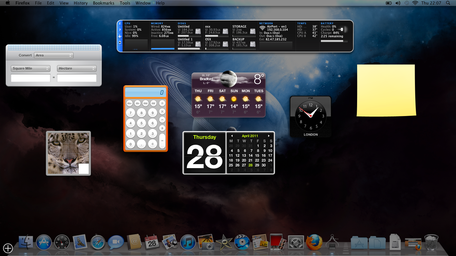

robcoffee Posted April 28, 2011 Share Posted April 28, 2011 Excellent work theSlug, because of this thread I picked up an L701X from Dell outlet - refurb unit - i7, 750gb hd and 4gb ram for a steal of £500 + VAT, added 4gb more ram and a 500gb 7200rpm hybrid hd for main boot drive and the Dell 1510 wifi card. Loving the laptop, and thanks to your guide I have Snow Leopard running perfect 10.6.7, touchpad is smooth with side scrolling and full graphics acceleration. If there was a competition for the best Hackintosh laptop, the L701X must surely be near the top! Link to comment https://www.insanelymac.com/forum/topic/247741-guide-dell-l701x-xps-17-late-2010/page/2/#findComment-1675995 Share on other sites More sharing options...
