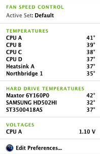

DarwinX Posted April 14, 2011 Share Posted April 14, 2011 Is it possible to show up certain values in the top bar, like smckstat-i did? After switching to snow smckstat doens´t work any more and i´m really missing this feature .... Try this then: smcK_Stat_i.app.zip or just use iSlayer's paid iStat Menus app or free iStat Pro widget: http://www.islayer.com/apps/ Link to comment https://www.insanelymac.com/forum/topic/247185-smc-monitor/page/3/#findComment-1670119 Share on other sites More sharing options...
Goron Posted April 14, 2011 Share Posted April 14, 2011 Try this then: smcK_Stat_i.app.zip or just use iSlayer's paid iStat Menus app or free iStat Pro widget: http://www.islayer.com/apps/ That did the trick, thanks a lot, haven´t found a link a link to that version Link to comment https://www.insanelymac.com/forum/topic/247185-smc-monitor/page/3/#findComment-1670271 Share on other sites More sharing options...

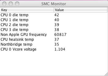

rimmi2002 Posted July 27, 2011 Share Posted July 27, 2011 My SMC monitor is not showing CPU Frequencies. Please see picture below. Hi my hardware profile is in my Sig. I downloaded SMC monitor am using the the FakeSMC and plugins from [url="http://www.insanelymac.com/forum/topic/279450-why-insanelymac-does-not-support-tonymacx86/"]#####[/url] 3.8. The versions are FakeSMC 3.1.0 Revision 493 and FakeSMC Plugins 3.1.0 Revision 493. (they are all installed in the E/E folder) I also tried moving IntelCPUMonitor.kext to S/L/E ... still no difference. Other plugin kexts that I am using are: ACPIMonitor.kext and SuperIOFamily.kext My SMC monitor does not show the frequencies of the CPU (i5-2500k) only the temp. the Vcore stays the same ...meaning there is no speed stepping going on. Under P and C states all the states are listed...but I am not too sure what it means to have them listed like that in the picture but no change in Vcore and I have no way to monitor the cores? Is SMC monitor not able to detect frequencies on the Sandybridge processors yet? Also do other people have speed stepping working on their sandybridge builds? If so did you do anything special? I am using Tony's DSDT file along with active P and C states in the boot.plist file and the latest version of Chimera from [url="http://www.insanelymac.com/forum/topic/279450-why-insanelymac-does-not-support-tonymacx86/"]#####[/url] 3.8. Any help will be great. Screen shot of SMC monitor is below. Thanks! Link to comment https://www.insanelymac.com/forum/topic/247185-smc-monitor/page/3/#findComment-1724183 Share on other sites More sharing options...
flAked Posted July 28, 2011 Share Posted July 28, 2011 That's exactly why I developed MSRDumper, it will show you the P-States being used. SMC Monitor will only show you the values being populated by other kext and the kernel and the current frequency isn't part of it. It's also not very feasible, because as you can see with MSRDumper it will slow down the machine while reading it continuously. Link to comment https://www.insanelymac.com/forum/topic/247185-smc-monitor/page/3/#findComment-1724480 Share on other sites More sharing options...
rimmi2002 Posted July 28, 2011 Share Posted July 28, 2011 That's exactly why I developed MSRDumper, it will show you the P-States being used. SMC Monitor will only show you the values being populated by other kext and the kernel and the current frequency isn't part of it. It's also not very feasible, because as you can see with MSRDumper it will slow down the machine while reading it continuously. haha thanks Flaked.....I tried out MSRdumper and it seems to be working great. Encoded a video on Handbrake...seems like the highest it will go to is 34....but the most important thing is that is idles at 16x....Thanks a lot! Jul 28 15:30:41 Macintosh kernel[0]: MSRDumper CoreMulti(16) Jul 28 15:30:41 Macintosh kernel[0]: MSRDumper PStatesReached: 16 19 23 28 33 34 Link to comment https://www.insanelymac.com/forum/topic/247185-smc-monitor/page/3/#findComment-1724888 Share on other sites More sharing options...

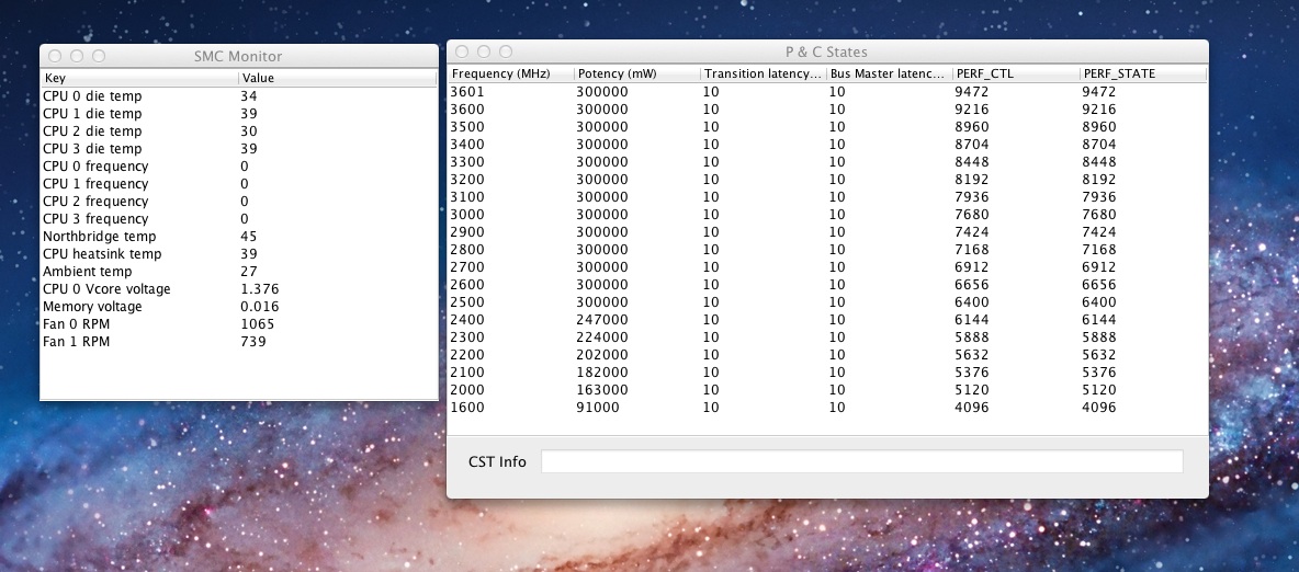

oldnapalm Posted January 23, 2012 Author Share Posted January 23, 2012 App updated (first post). New IntelCPUMonitor shows Sandy Bridge CPU frequency http://www.insanelymac.com/forum/index.php?showtopic=274782 Link to comment https://www.insanelymac.com/forum/topic/247185-smc-monitor/page/3/#findComment-1788741 Share on other sites More sharing options...
juanerson Posted January 23, 2012 Share Posted January 23, 2012 Thank You oldnapalm, version 0.2 is working great here. Link to comment https://www.insanelymac.com/forum/topic/247185-smc-monitor/page/3/#findComment-1788802 Share on other sites More sharing options...
Slice Posted January 24, 2012 Share Posted January 24, 2012 Hey oldnapalm, Can you make PERF_CTL and PERF_STATUS to be hexadecimal? Link to comment https://www.insanelymac.com/forum/topic/247185-smc-monitor/page/3/#findComment-1788945 Share on other sites More sharing options...
