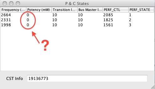

Larx Posted April 13, 2011 Share Posted April 13, 2011 Hi oldnapalm, I do not understand this zero? Is something wrong here? Thanks ! Link to comment https://www.insanelymac.com/forum/topic/247185-smc-monitor/page/2/#findComment-1669926 Share on other sites More sharing options...

oldnapalm Posted April 14, 2011 Author Share Posted April 14, 2011 Hi oldnapalm, I do not understand this zero? Is something wrong here? Thanks ! If you are using Chameleon RC5 to generate P-states, it's normal, it injects zeros in those positions. perl -e 'open(CMD, "ioreg -lw0 \| grep SSDT-1|") or die; while(<CMD>) { chomp; if($_ =~ /\"SSDT-1\.?\d?\"=<([^>]*)>/) { $buff = $1; open(PIP, "|xxd -r -p > SSDT-1.aml") or die; print PIP "$1"; } }' Name (PSS, Package (0x04) { Package (0x06) { 0x00000963, [color="#FF0000"]0x00000000[/color], 0x0000000A, 0x0000000A, 0x00000926, 0x00000001 }, Package (0x06) { 0x00000858, [color="#FF0000"]0x00000000[/color], 0x0000000A, 0x0000000A, 0x00000824, 0x00000002 }, Package (0x06) { 0x0000074D, [color="#FF0000"]0x00000000[/color], 0x0000000A, 0x0000000A, 0x00000720, 0x00000003 }, Package (0x06) { 0x00000642, [color="#FF0000"]0x00000000[/color], 0x0000000A, 0x0000000A, 0x0000061D, 0x00000004 } }) Link to comment https://www.insanelymac.com/forum/topic/247185-smc-monitor/page/2/#findComment-1669932 Share on other sites More sharing options...

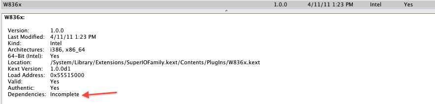

Larx Posted April 14, 2011 Share Posted April 14, 2011 Thanks man ! I have only one more question! Trying to get a fan display. But after computer restart, it disappears! W836x: found Winbond W83627DHG-P I deleted everything except W836x and I made edit in the plist: <key>FANINLIMIT</key> <integer>4</integer> And of course fakesmc 3.1! See picture please... What is wrong here? Many Thanks ! Link to comment https://www.insanelymac.com/forum/topic/247185-smc-monitor/page/2/#findComment-1669937 Share on other sites More sharing options...
oldnapalm Posted April 14, 2011 Author Share Posted April 14, 2011 What do you mean "it disappears"? Did you update kext cache after editing the plist? I use SuperIOFamily and FakeSMC in /Extra/Extensions. Link to comment https://www.insanelymac.com/forum/topic/247185-smc-monitor/page/2/#findComment-1669940 Share on other sites More sharing options...
Larx Posted April 14, 2011 Share Posted April 14, 2011 What do you mean "it disappears"? Did you update kext cache after editing the plist? I use SuperIOFamily and FakeSMC in /Extra/Extensions. Failed to load kext org.mozodojo.W836x (error 0xdc00800e) Link to comment https://www.insanelymac.com/forum/topic/247185-smc-monitor/page/2/#findComment-1669943 Share on other sites More sharing options...
DarwinX Posted April 14, 2011 Share Posted April 14, 2011 Failed to load kext org.mozodojo.W836x (error 0xdc00800e) As oldnapalm had already noted, the FakeSMC 3.1.0 is intended to load from the /Extra/Extensions directory rather than the /System/Library/Extensions. While those directories are normally interchangeable, this is an important distinction. Link to comment https://www.insanelymac.com/forum/topic/247185-smc-monitor/page/2/#findComment-1669960 Share on other sites More sharing options...
