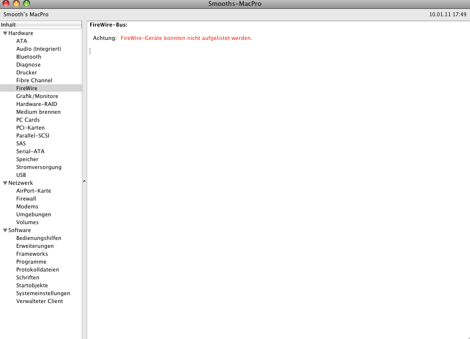

Firewire does not work natively?
not with the DSDT i had used (P35-DS3). I think this board dont have FireWire
