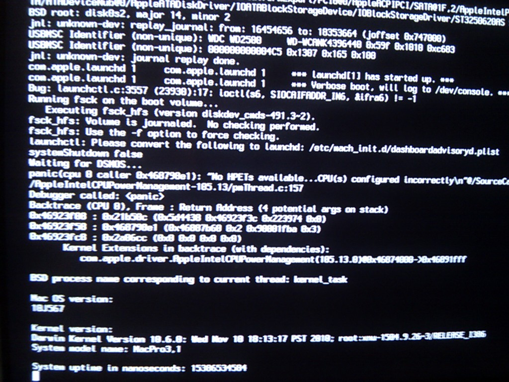

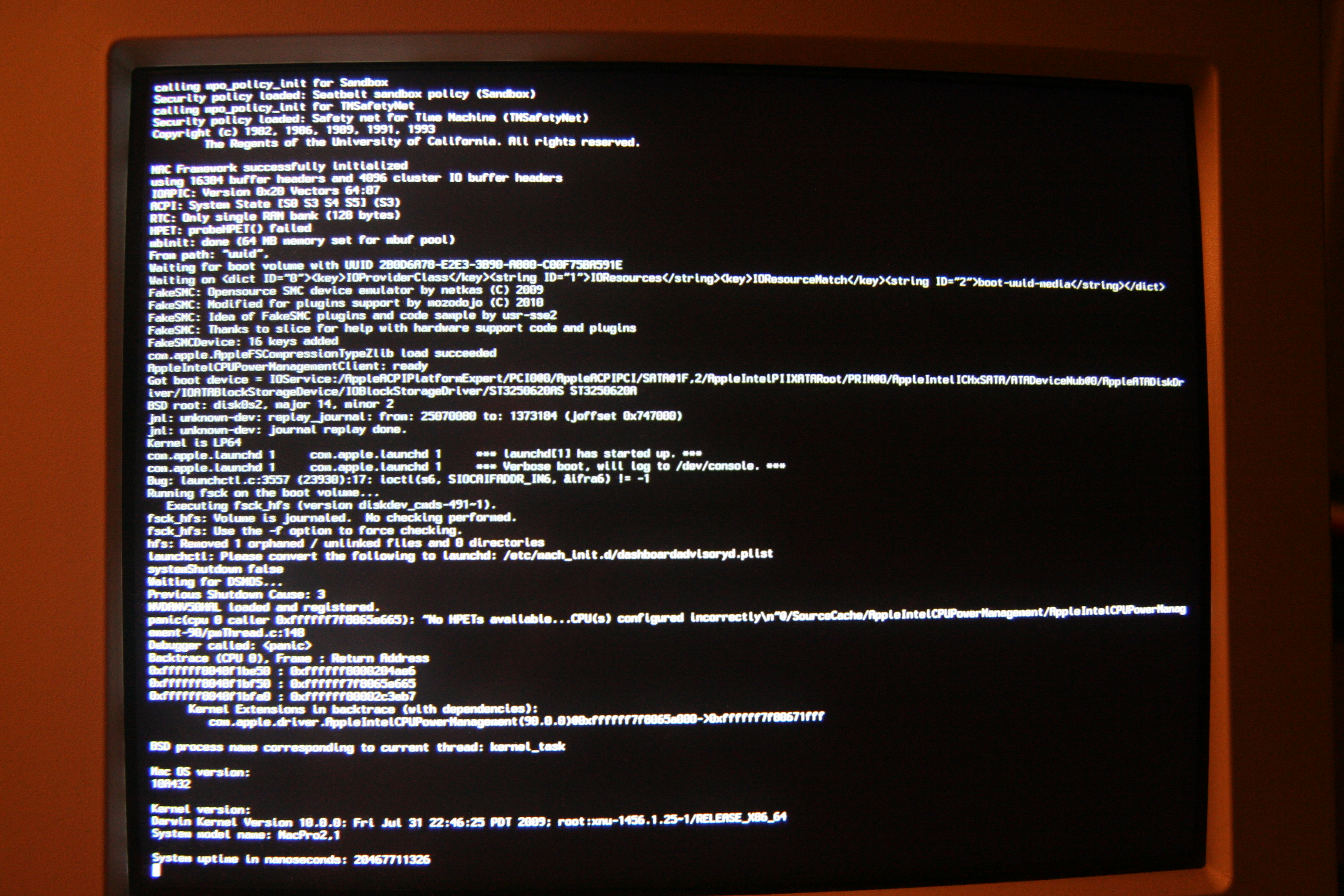

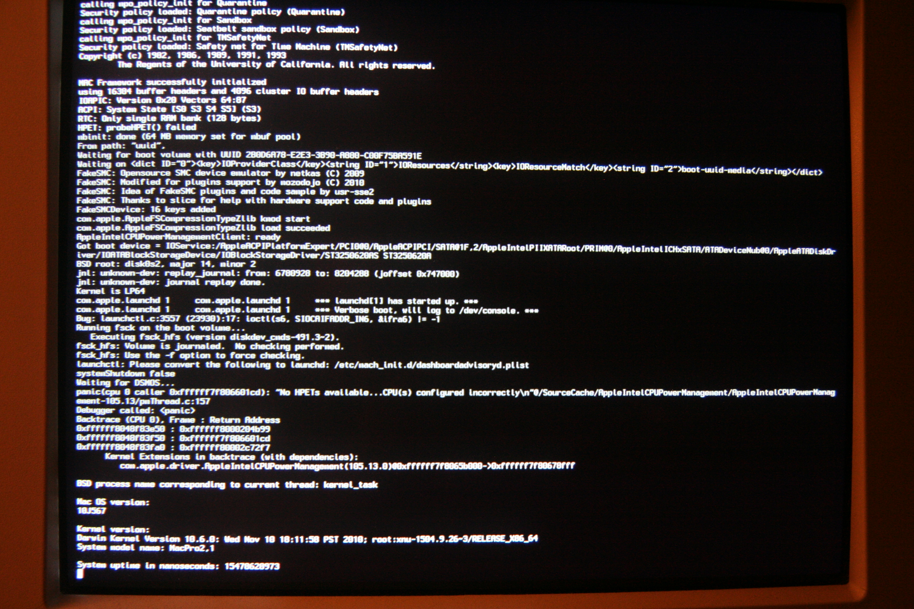

Daylights Posted January 8, 2011 Share Posted January 8, 2011 try itdsdt.Daylights.zip I hope it works but I'm not sure we need to test No luck I've made 2 pictures, first after a clean install 10.6.0, second after update 10.6.6. After the first 10.6.0 KP I'm still able to boot in OSX with your boot CD, but after update 10.6.6 that's not possible anymore (KP). Link to comment https://www.insanelymac.com/forum/topic/235523-dsdt-auto-patcher/page/57/#findComment-1618059 Share on other sites More sharing options...

juanerson Posted January 8, 2011 Share Posted January 8, 2011 @Daylights, In the picture "No HPETs available..." is your problem, I mean bad HPET (High Precision Event Timer) in the DSDT (probably), so "maybe" you need to replace it, the entire Device (HPET), with this simplified code (by Master Chief): Device (HPET) { Name (_HID, EisaId ("PNP0103")) Name (_STA, 0x0F) Name (_CRS, ResourceTemplate () { IRQNoFlags () {0} IRQNoFlags () {8} Memory32Fixed (ReadOnly, 0xFED00000, // Address Base 0x00000400, // Address Length ) }) } EDITED: Apart of LatinMcGyver75 said about the BIOS parameter, is a very important step. Link to comment https://www.insanelymac.com/forum/topic/235523-dsdt-auto-patcher/page/57/#findComment-1618103 Share on other sites More sharing options...
MaLd0n Posted January 8, 2011 Author Share Posted January 8, 2011 he DSDT no has the device HPET I added still not solved This fix is standard for all gigabytes but not solved I can not really solve it Hi juanerson you are very welcome I'm a Fan look at bios(3) Link to comment https://www.insanelymac.com/forum/topic/235523-dsdt-auto-patcher/page/57/#findComment-1618141 Share on other sites More sharing options...

Daylights Posted January 8, 2011 Share Posted January 8, 2011 daylights try making a usb with bootfiles. and dsdt make sure u have hpet 64 in bios if thats option. u did try to boot with -v -x -f ? Unfortunately there's no HPET option in de BIOS, -v -x -f gives me the same HPET error. What can I do? Read something about using a Disabler.kext to disable Power Management and I will probably need SleepEnabler.kext also. That was the way my previous installation (DVD by Hazard) worked, but I was hoping for a more clean install Link to comment https://www.insanelymac.com/forum/topic/235523-dsdt-auto-patcher/page/57/#findComment-1618197 Share on other sites More sharing options...
